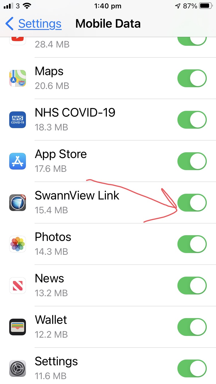

Got a Swann dvr think it’s a 4200 I get an alert at the bottom of screen (which when got Ethernet cable in ) it says check connection .if I take it out it says net disconnected it there anyway I can turn this off so I get no alerts on screen ? Thanks

I set everything back to default when Ethernet cable is attached I can only view on WiFi in house (on my phone) once I turn off WiFi and go on 4g it doesn’t connect.
Does it work outside your house on any other Wifi connection? Have you got the data option enabled for the SwannView link app on your phone?
I’ve not tried outside WiFi and yes data is on I’ve got it going now but it’s very hit and miss on 4g sometimes it works and most time doesn’t .im trying to find a different app at the mo .
