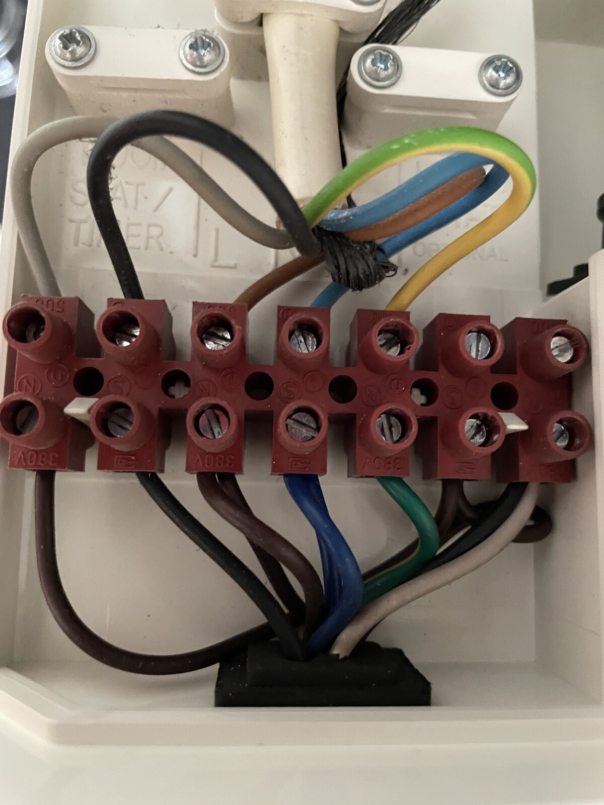

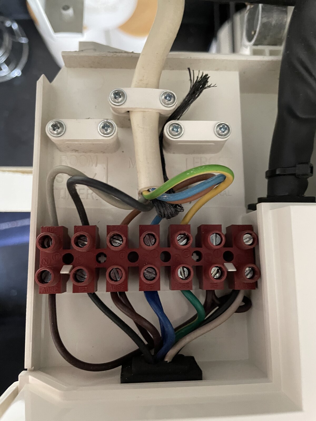

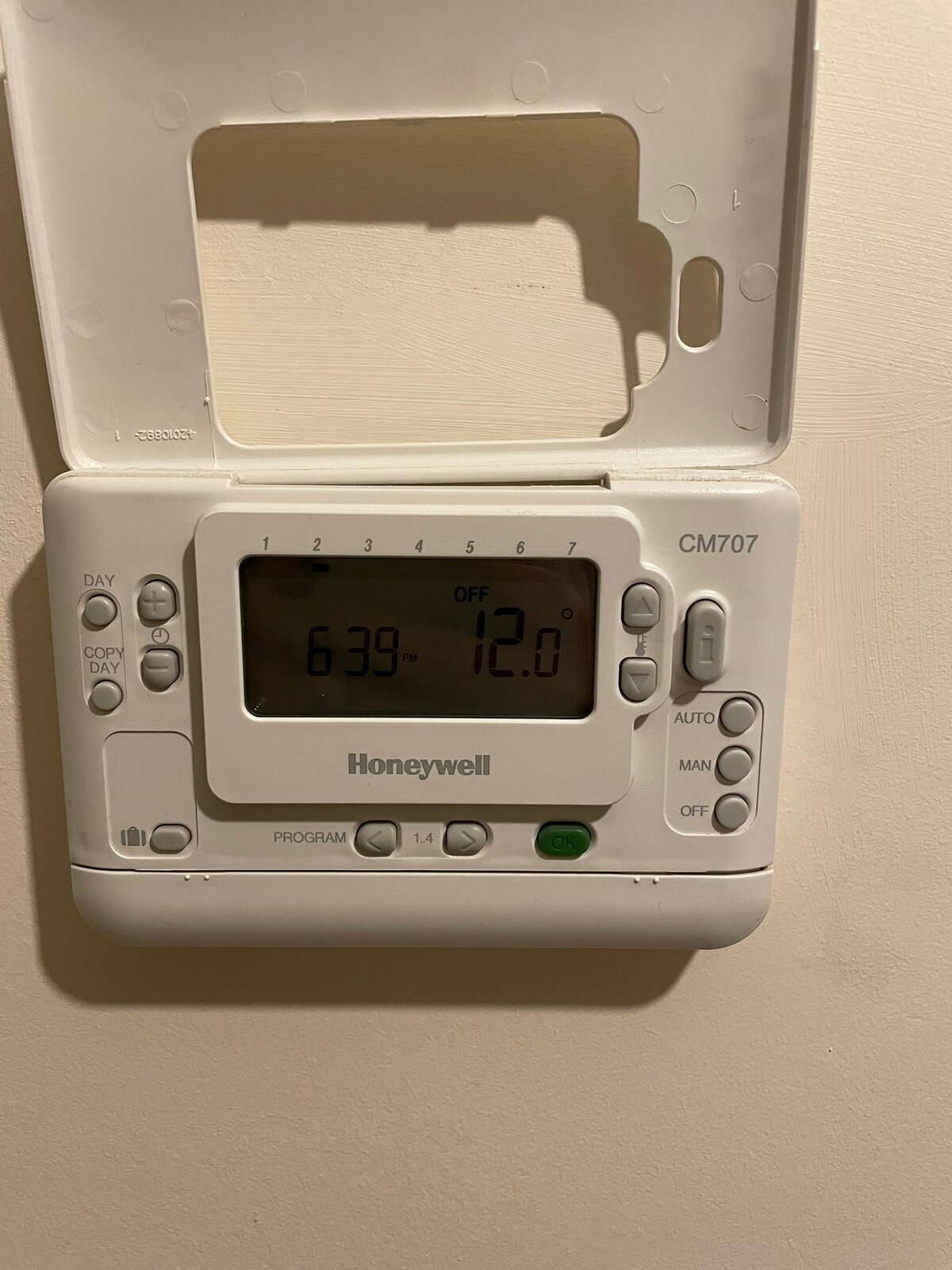

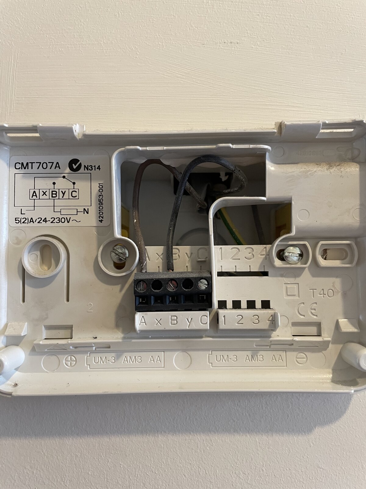

I’m looking to replace my current Honeywell cm707 to Hive. I have a combi logic 35 boiler and will attach pics for both. If this pretty straightforward? Step by step guide

It might be easy enough, you need to establish if the blue wire behind the cm707 is a neutral and go from there, failing that scrap the thermostat wiring, and wire receiver next to the boiler. Also get someone competent to carry out 26.9 checks, as that cover forms part of the combustion circuit.
Thanks Chris I was planning to install the Hive control unit by the boiler but I will check the wiring with my meter for sure.

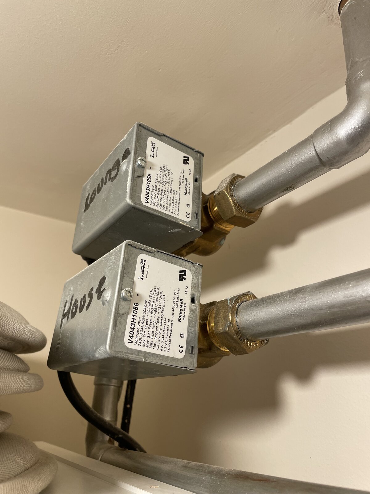

@Kelvin Schutte be careful. In your other post, you said
I have a combi logic boiler with 2 off (two zones, lounge and rest of house)
In which case likely there will be motorised valves controlling the two zones, if so the Hives are not connected to the boiler and the boiler wiring will not change. In multizone installations, the Hives are wired to the motorised valves.

At the moment, there will be two wires connected to the CM707 terminals A & B.
Those two wires need to be rerouted to the first Hive receiver (Single Channel Version) terminals 1 and 3 (Common and Heating On) You can either reroute the existing thermostat cable to the Hive receiver, or alternatively find the origin of the cable that goes out to the thermostat, disconnect it completely and then run a new cable from the terminals to where the Hive receiver will be located.
The Hive receiver also needs a 230V connected to its N and L terminals to provide it with operating power. The 230V should come via the same 3A fused connection unit that supplies the boiler.

I have found the valves and there is a electrical junction box right by it I will take a pic tomorrow, I assume you mean the hive hub will need to be wired here and not by the boiler in my kitchen? Also will i need two hubs for each zone or can the hub switch multiple zones?

Was it a Scottish person who wrote on those valves? Looks like it says Hoose :ROFLMAO::ROFLMAO::ROFLMAO::ROFLMAO:
I think you maybe confusing the Hub (internet connection) and the receiver (where the heating control wires are connected) You can install them where you like provided they are within the range / spec advised by Hive, but the heating control wires would need to be run to the receivers, so usually they are installed adjacent to the motorised valve wiring centre for ease of wiring. The hub normally plugs into your router.
One hub will do, but you will need two Hive thermostats and two single zone receivers.
