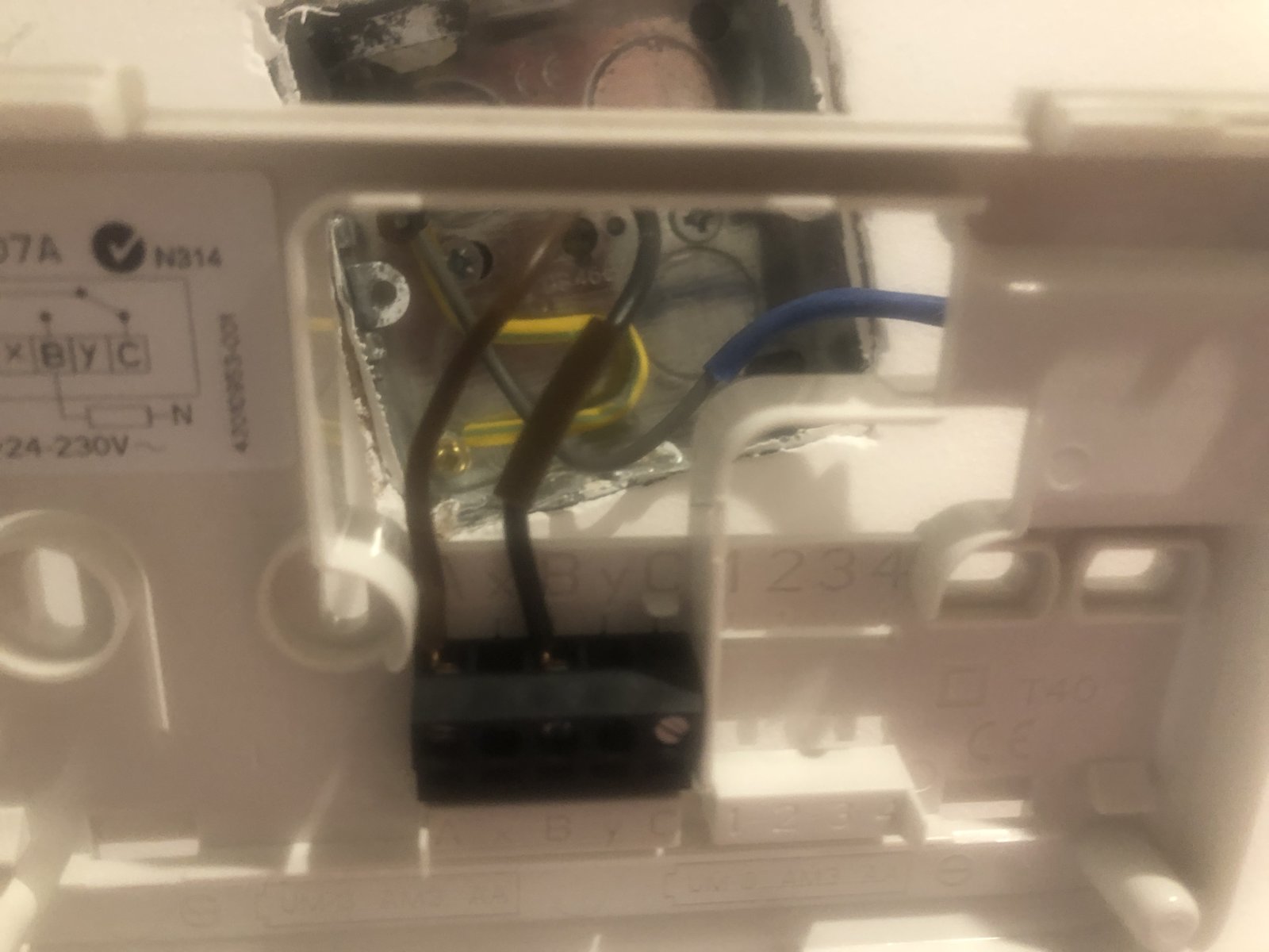

In the pictures posted the brown and black are connected the grey is not.
So the black and brown are live and switch live.
It may be just a case of swapping them round so black to L with a link to 1 and brown to 3 and the grey still in N.
But you may be right that there is no neutral. If that is the case then the grey needs connecting to neutral at the other end.
That was my suggestion, although for clarity use black as neutral and grey as switched.
The hive needs a neutral to work and the original controller was a normally open switch only.
It still does not work, I change black to L with a link to 1 and brown to 3 :/
Okay so the grey is not connected at the other end so you have no neutral at the hive.
Can you post a picture of the wires behind the switch for the boiler. Make sure you turn the power off to it before you unscrew it.

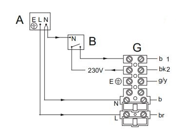

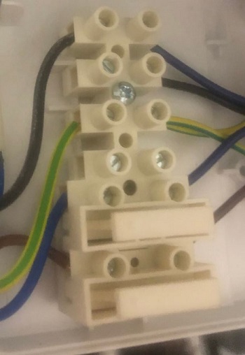

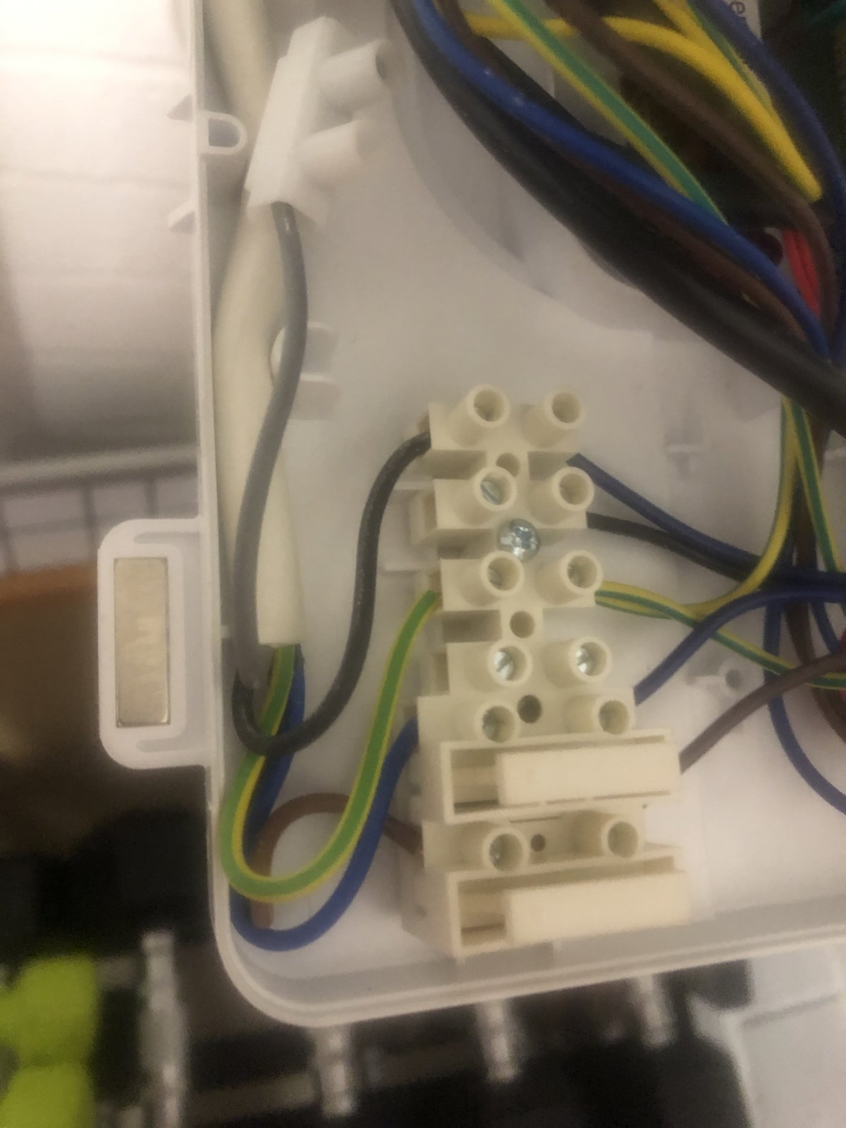

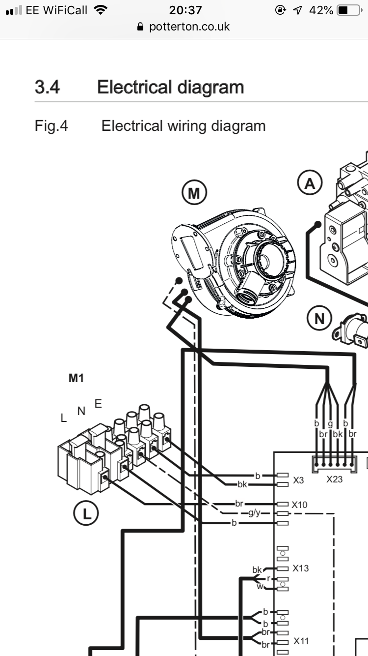

Hi guys, sorry to bring up an old thread but this has basically finished exactly where I am here... I’ve not yet wired the Hive up as per the above (I have brown, black with brown sleeve and grey with blue sleeve) however from looking at the boiler, there is a grey wire that isn’t connected, so preemptively I was going to see if anyone could make a suggestion on wiring at the boiler end?
If it helps, I have dual zone heating, upstairs and down, both currently with CM707a thermostats. The boiler is a Potterton Assure 36 Combi.

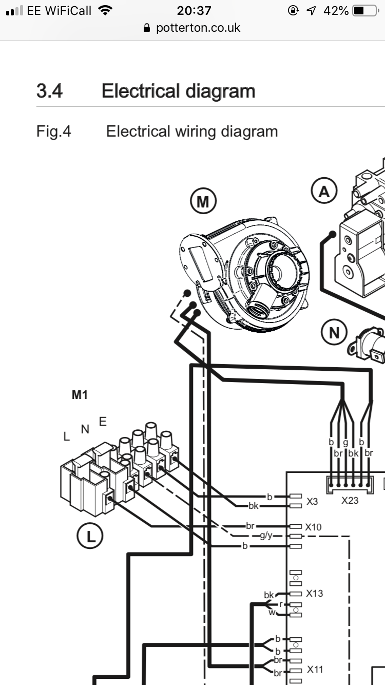

Based on the above advice and the wiring diagram attached for my boiler, I think that if I connect the Hive as above and it doesn’t work as @Johnmdc and @croftongas say, then at the boiler end I connect the grey cable (currently capped with the terminal block) to the same connection as the blue wire coming front the white 5 core flex. But that could be very wrong, hence looking to check!

I have a Logic 35 combi boiler.
That boiler wiring doesn't look like an Ideal Logic to me.
This photo of yours...
..looks more like a Potterton.
And you posted this screen shot????...
So what's the truth? Which boiler is it?

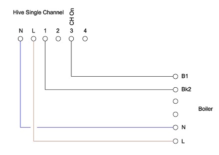

If it is a Potterton, then the Hive connects to it as below:
Hi @stem, this is the trouble with igniting an old thread, mixed messages. His boiler is a potterton combi, I think the wiring might be ok on those as there’s an external cover, then internal one which gains access to combustion circuit and chamber.
