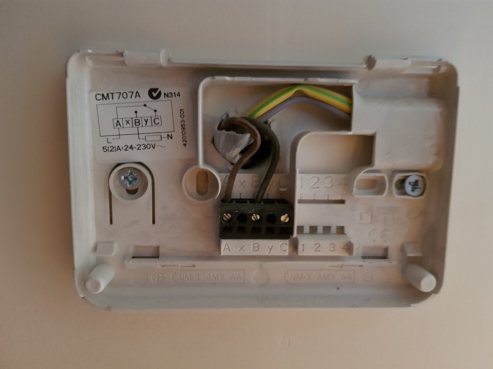

Good afternoon,
I need help how to change honeywell cm707 to hive termostat.
I bought HIVE Active Heating but I have no idea how to connect it.
I have a Logic 35 combi boiler.
Can anyone help me :unsure:

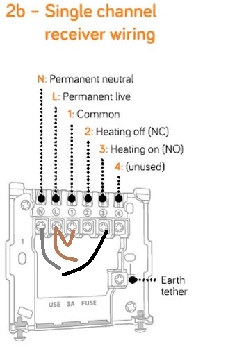

Brown to live, black to neutral, link brown live to 1 common, grey to 3 heating normally open.
Then you will need gas engineer to alter boiler connections.

NO DO NOT connect grey to 3 it will go BANG if the grey wire is connected to neutral at the other end.
Black should go to 3 and grey to N, brown to L with a link to 1. No need for a gas engineer.
If the Hive doesn't work then the grey is probably not connected at the other end, post back for more help.
Yeah, Unfortunately if your not gas safe registered your not allowed to even remove the boiler case.
Is a Combi so grey won't be connected... Existing stat is a normally open switch

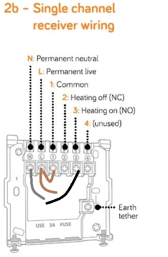

Johnmdc like that?
yellow-green should be not connected?
Sorry for my english, I still learn ;)
Yes that is right, the yellow/green (earth) goes under the terminal marked earth tether.
