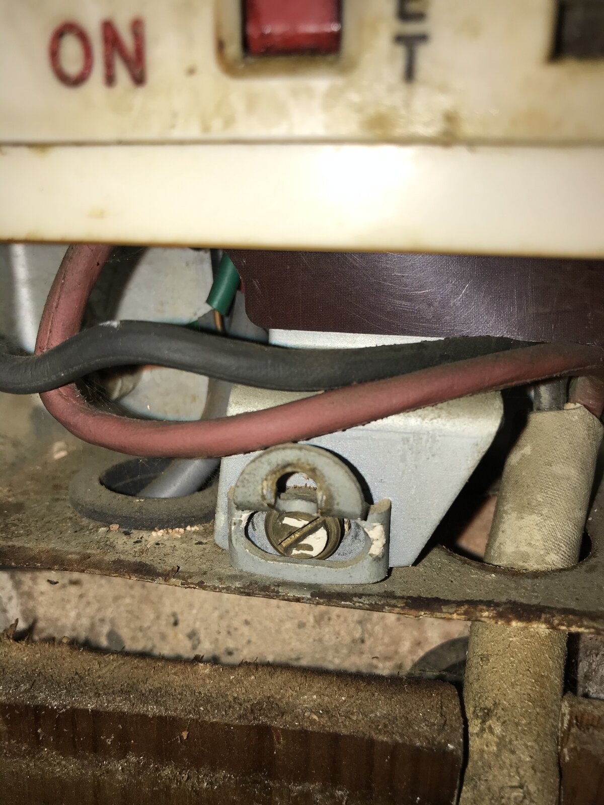

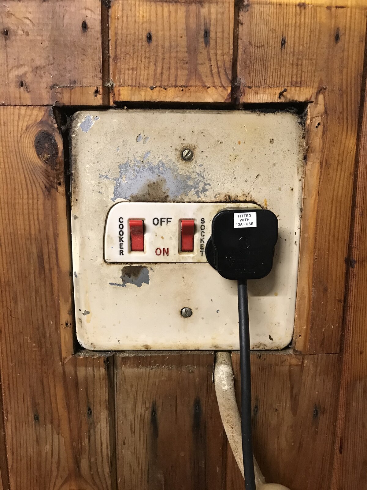

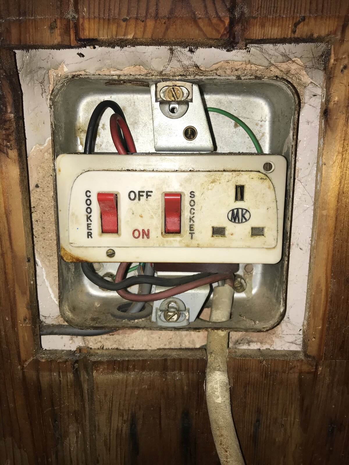

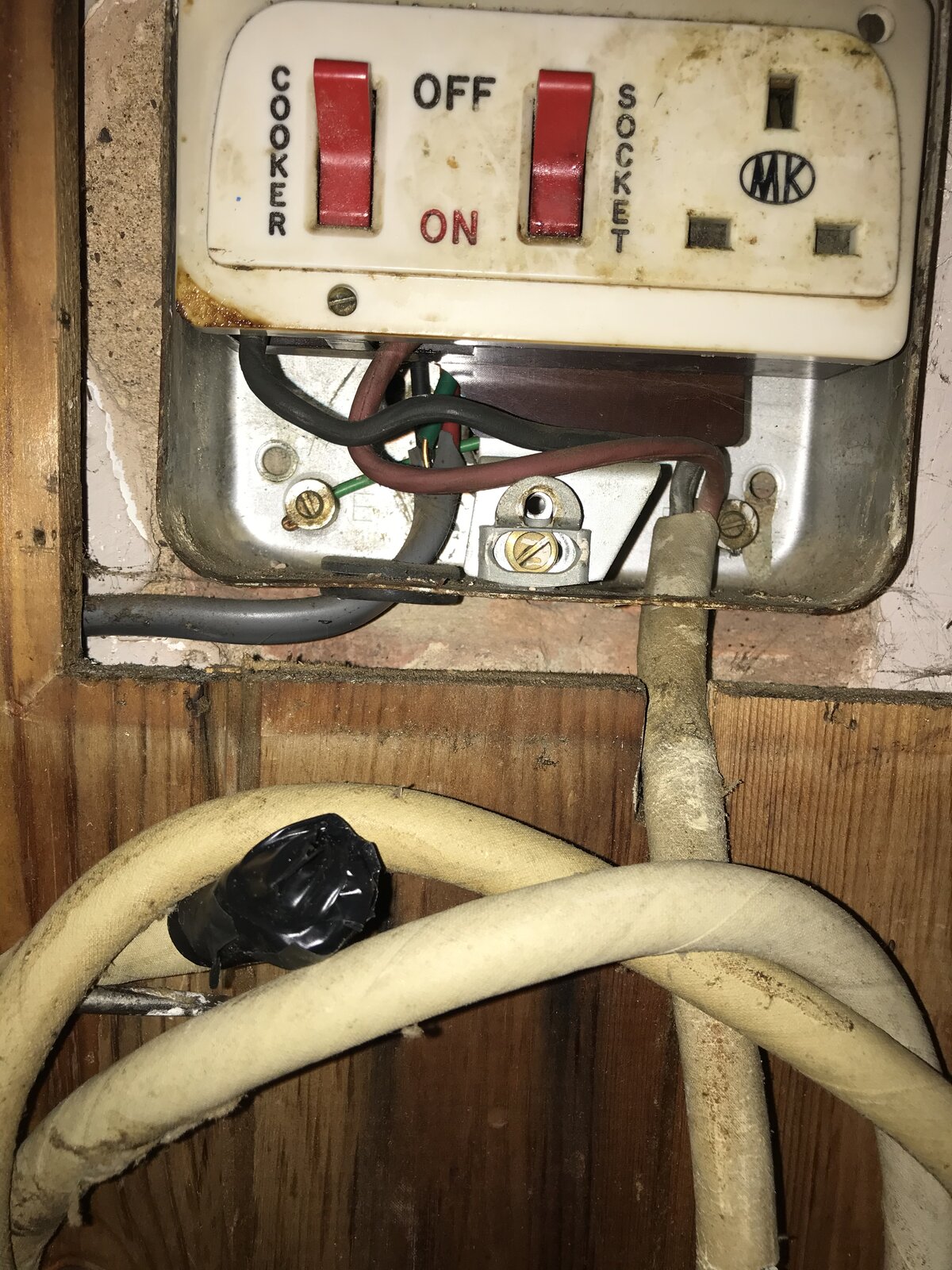

Hi,
I hope some can help me if my issues.
I got a 50yrs old oven socket and would like to swap it. As show on the pictures you might be able to see the cable. I would like to know can I swap it with
https://www.screwfix.com/p/mk-base-...cGrjf6481s_A_ZIAAB0aApHhEALw_wcB&gclsrc=aw.ds
And how about the socket internet box can I use any 2gang or should look for one with earth thingy?
Really appreciate if some could get genuine advise.

You need to replace that whitecable, it's rubber & is breaking down as can be seen by the breaks in it!
Thanks for your reply.
Could you please let me know what sort of cable should I replace this with. I probably need about 1m.
If you could send me a link it would be fabs!
THanks,
you will need to remove the screws from the new one (leaver the washers off) and make use of the origional screws. (different size)
