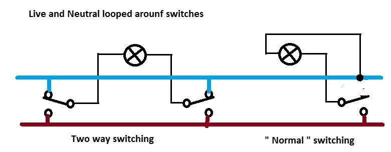

I have previously seen the neutral wired in to the light switch rather than the live
A few weeks ago I was made aware of another example of this wiring, history of ( modern ) switches failing too often
In the old days where two way switches had over an inch of separation between L! and L2 creating an arc between Live and Neutral as the moving contact moved was impossible.
Modern switches have a few millimetres separation and if wired this way then creating an arc between Live and Neutral in the switch is likely to happen.
I’ve come across modern switches wired with the permanent live in L1, the neutral in L2 and the switched live in the common terminal. I don’t know if it was deliberate or not, but there was no sign any problem of the switch arcing across.
