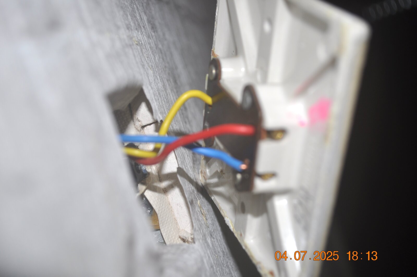

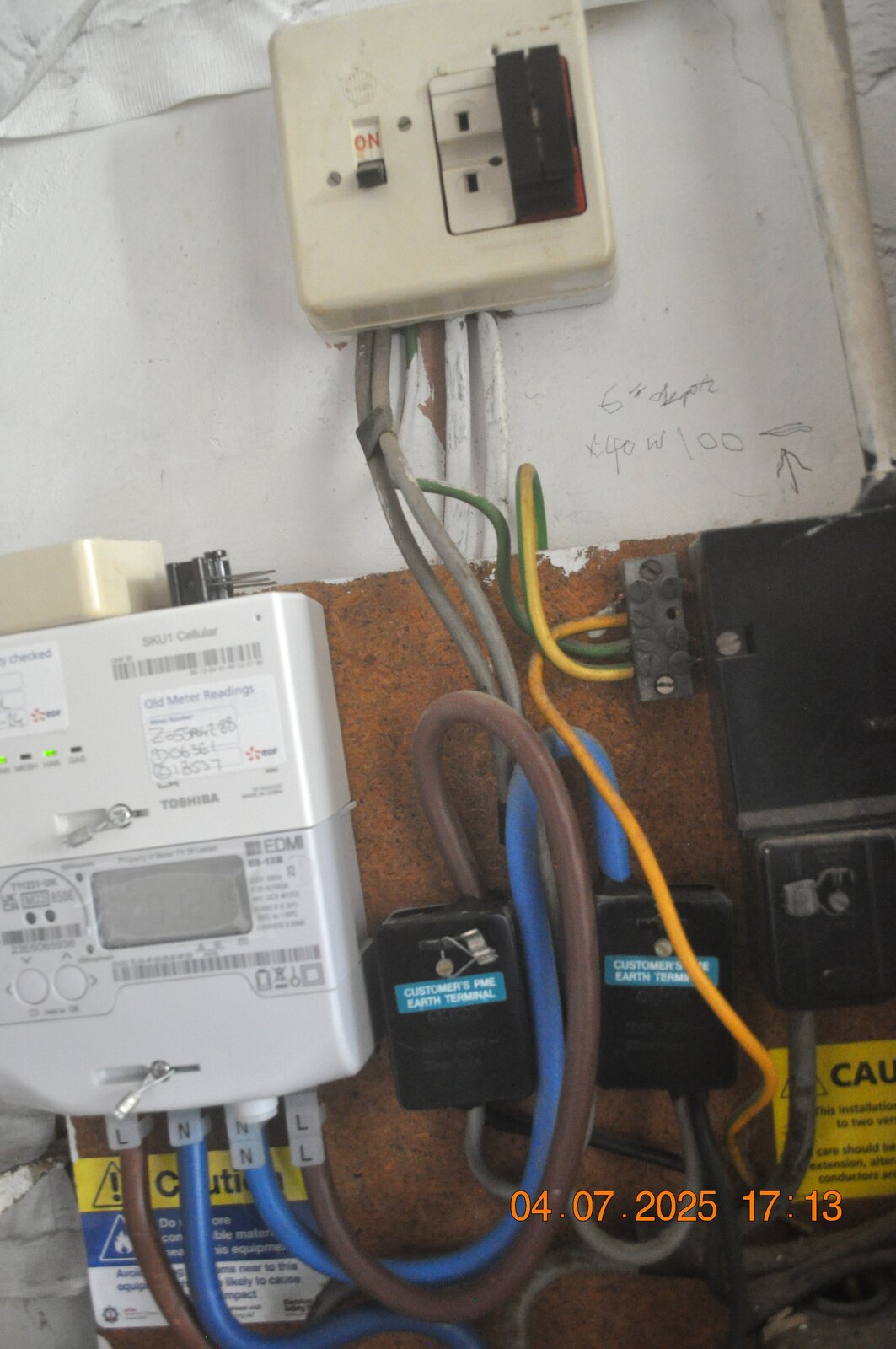

I'm immensely grateful to all you guys - I'm going to take some photos of the hallway rose and switch, it being nearest to the fuse box. I should mention there is another similar switch at the other end of the hall
Also regarding the rubber-or-pvc post seventies rewire, the exit wiring from the fuse-box is def not rubber, being a flat whitish pair.

Okay, those cables are either 1/044" or 1mm/1.5mm pvc, so definitely should not have deteriorated to any extent. Is that your only CU on the premises? I expected to see at least another one for power circuits etc.

Hard to tell exactly, but does the hall rose have thermal damage?

For your information, that is what is known as a '3-plate' ceiling rose (3 terminals + earth). In the photo, left to right, you have the switch wire; live; neutral.
You have the If the rest of the system follows that example, then the L & N will be looped generally from ceiling rose to ceiling rose, but that rose, would appear to be either the last one on the loop, or a sort of spur off the main loop.
Going to the other roses, assuming the same style - you would need to be disconnecting all of the live wires, from the middle terminals in each, and insulating them temporarily, apart from any other removed wires in that middle terminal. Do get back to us, with what you find in the other roses, and photos of each please.
At this point, for speed and simplicity, I would suggest that you purchase what is called, a 'volt stick', and practise using it. It will light up, when ever it's 'nose', is placed close to a live wire, and might save you a lot of diagnostic time, and effort.
