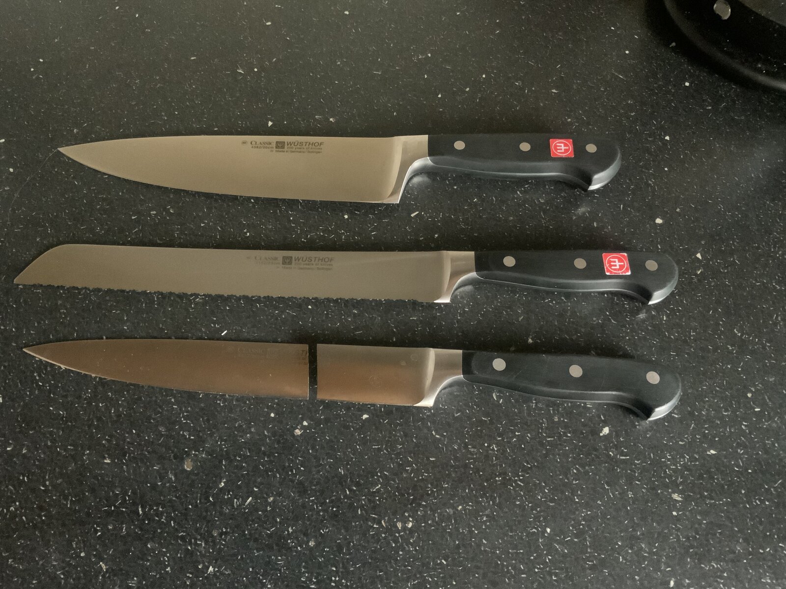

Can’t just slice through pork crackling with a carving knife no matter how well cooked it is. Next time I’ll use either the bread knife or the chefs knife. You can see how much I use the carving knife - the logo on the handle has completely disappeared!
Just to update this. Looks like I’m getting a new one. I got on to who I bought the set from and they said they would deal with it for me. Just received this email from them today:
Hi Steve
I am pleased to advise that Wusthof have agreed to send you one directly.
Please let me have all your current address contact details, including mobile number.
Many Thanks,
Kind Regards
Neil
Thats what I call bloody good customer service - especially after more than three years. I’d definitely buy from them again. https://millyskitchenstore.co.uk/ (y)
Excellent result :) I have some Wusthof Ikon knives and they're just awesome. Good to know the company treats their customers well
