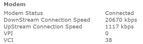

I bought some flat cat 6 (15m) and happy with the result. Getting 40mb to my router which allows for 24mb to computer via WiFi and 30mb using the cat6 so going to run it under the laminate underlay. Thanks for the help.
Getting 40mb to my router which ... ... ... 30mb using the cat6
That's not great bud. I take it you checked that with speedtest.net or similar?
My router is connected at 20670.
TCP/IP and Ethernet overheads are about 5 percent, so in theory I should get 19.64Mbps, but here's what I get...
So, 17.50/19.64*100= 89% efficiency. I am using a USB-C to ethernet adapter though, so there will be overheads with that, too. I would hope for 95% or in that region really, for a 'proper' ethernet port.
You're getting 30 out of 38(5%off of course), which is only 79%. That's not great. That probably means that many, many frames a second are being re-sent by the router, for failing the CRC checksum upon receipt.
Do you have a 'normal' patch lead you could try taking the PC to the router and plugging in direct? If the speed goes up, this will prove my suspicions, because you really are losing a lot of throughput at the moment.
