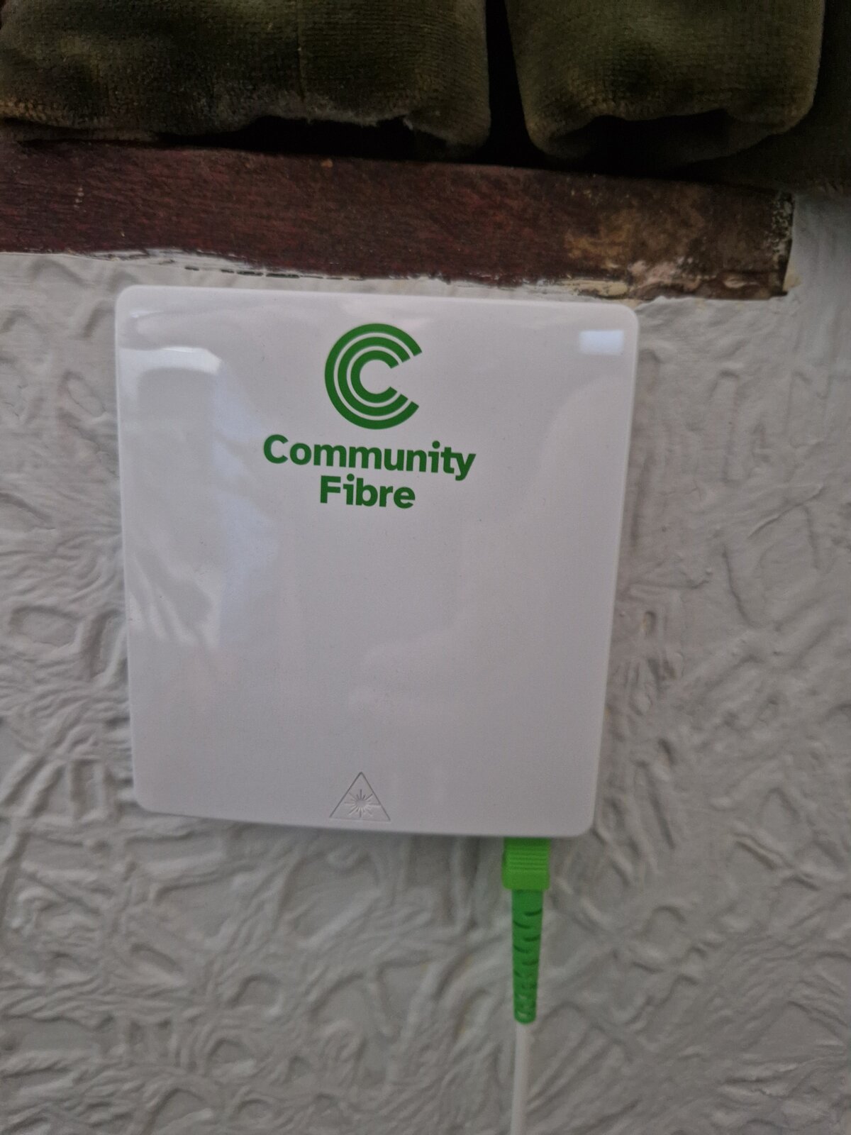

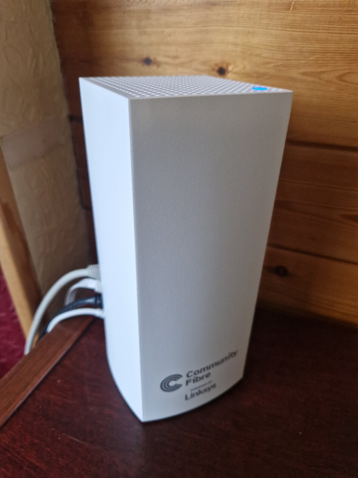

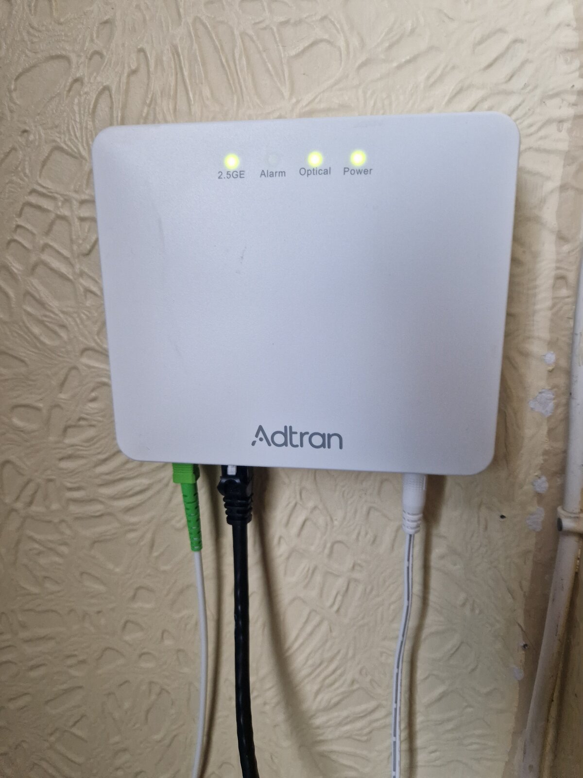

I have Community Fibre and so far very good. The responded quite quickly when a fox bit through my fibre. They use an OEM Linksys Velop router with a 2.5G interface facing the (Adtran) ONT. The fibre comes through a hole in the wall into an internal junction box (photo #3) and a fibre of suitable length plugs into that and the ONT. They let me have 2m and 5m cables for that so that I have options of where to put the router. So far I'm consistenly getting 160Mb/sec each way on a 150Mb/sec contract.
