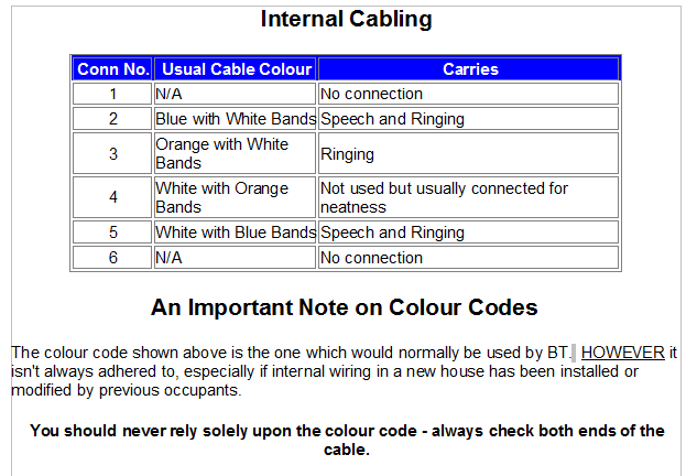

Hi all, thanks for taking the time to read and respond.
As can be seen in the picture; this is the main telephone socket into my house (BT). I have run a 4 stranded (Green, Black, Yellow, Red) in black sheathing cable to an extension in my other room.
Presently the main socket works and is wired as follows:
White/Blue - 5 - (Green - 4 strand)
White/orange - 4 - (Black - 4 strand)
Orange/white - 3 - (Yellow - 4 strand)
Blue/white - 2 (Red - 4 strand)
The above wiring has tone and I can make and accept calls.

As long as you wire from and to the same numbered terminal, it should work.
Are all your wires making contact?
Which wiring? The other extension on the white/colour wiring? Or the master socket itself?
What tool did you use to connect the new wiring to the terminals in the plate shown and the new extension socket?
The tool that I used was a specific tool that is used to push down the telephone wire into the appropriate connectors.
In order to make a proper connection do you think that I should strip the wire to ensure I get a proper connection?
No, the IDC terminal doesn't require the wire to be stripped. Stranded cable isn't very suitable for IDC terminals though, they are made for solid core telephone cable.
It does look like flat stranded cable to me - you'll struggle to get a good contact in those IDC connectors, which are designed for solid core cable. If you do manage to get it to work, it'll be unreliable, likely to fail at any time, and will totally ruin any broadband, potentially even if you don't connect the router to the end of it (it'll still pick up interference).

As the others have said, these terminals are designed for solid cores. They will often work with stranded, but only when they are the only cores in the terminal, and usually also only if the terminals haven't been used for solid cores before. If you try and mix wire types in one terminal, as you have done here with solid cores followed by stranded, then the terminals generally don't make contact with one or other of the wires.
If you really really can't replace the cable, then you can get the small white junction boxes with one set of punchdowns and one set of screw terminals. Or you could get the soldering iron and heatshrink out ;)

Agreed, IDC terminals are designed to take two wires in each slot, of the same size. Andyman123, what exactly is the cable you have used? Do you have the reel still or a link to what you bought? Or is there any lettering printed on it? Especially if it says AWG or mm² on it anywhere.
The master socket is wired incorrectly in the first place. The original wires should be connected to the other part of the faceplate, not the part in the picture. This would then free up the IDC connections in the picture for your new cable, which, even if it turns out to be 26AWG stranded for example, may still work.
