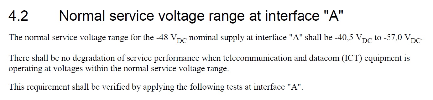

That's not what I'm seeing. BTNR 2511.pdf states that BT have been conforming to European standard ETSI EN 300 132-2 since Jan 2003.
That standard states...
Interface "A" is where the voltage is fed into the equipment at the exchange, rather than measured at it's output, or at the end user's NTE.
It's unlikely to read 48v at home, I agree, just like you never see 230v AC at home either.
