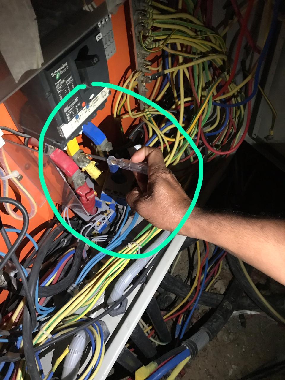

Another picture of the week for you to enjoy, luckily the supply was off.
How many errors can you spot?

One problem is that there is a big Green ring hanging on the isolator, if it's at all metallic then it could slip down and short the L1-L3 terminals :LOL: :LOL: :LOL:
The SWA is not terminated correctly, the outer is not earthed.
I would not use a neon screwdriver to test mains as a first tool, however where there has been cable damage so only one phase is live, then the neon screwdriver is one of the few tools that will show a live wire.

I have seen many a panel with a rats nest like that, and proving dead is not always easy, I had to remove some old cables like what is shown, I used a meter, a proving unit and a neon all showing dead, I hack sawed through what seemed main cable and went for lunch, on return there were sparks coming from the cable. Clearly now live I had to try and find out from where with all cables glued together with concrete from the batching plant, it turned out one old cable fed a transfer motor which was PLC controlled, until the cable sparked and the plant failed, I was unaware the motor even existed. And the panel where the cables connected had been without a lid for years.
After the near miss, I considered what I could do to prove dead, two spikes would be only way, so revising the risk assessment it was decided only when plant was not in use, could the old cables be removed.

I love my clamp on meter, there is no wired current range, no mistake can cause the big bang, and I can test neutral wires for current before removal, however unless you have a clamp on in your tool box, then the neon screwdriver is essential.
As a P.S. it seems the moulded breaker is "On" so items falling on an isolator or breaker can't switch it on, down is always off, the exception seems to be domestic where tradition has them reversed.
