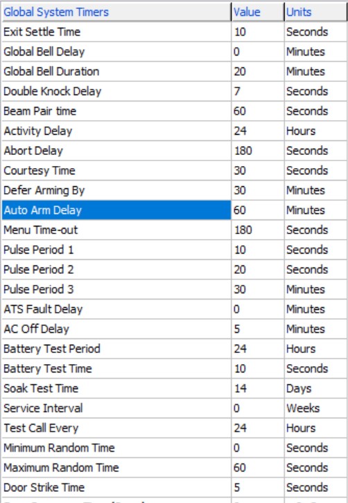

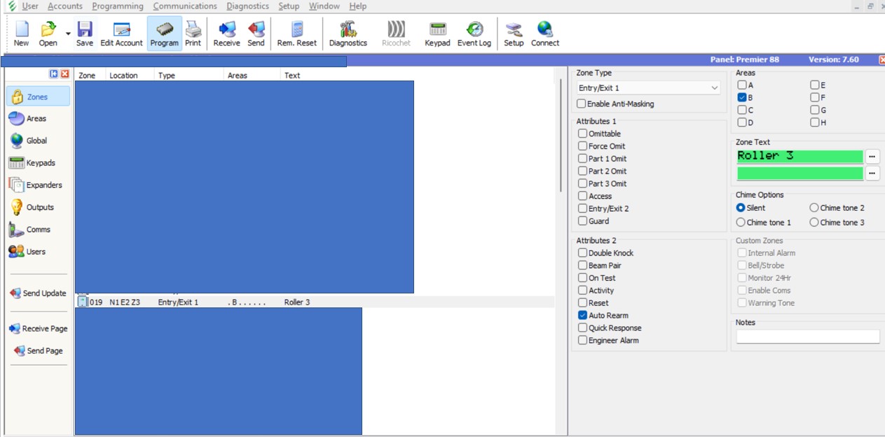

We've got a Premier 88 with 4 areas set up. One area is the garage; with roller door magnetic contacts. At the moment we have auto rearm enabled on the roller doors. Set 60 mins after deactivation when the area resets itself (I like this idea as it means it re-arms the alarm if we forget to set it !!)

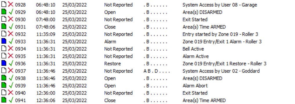

However, when we're working outside and leave a door open (sometimes all day); the alarm will still reset itself after an hour; and then sometime later the alarm will go off.
Ideally I'd like to be able to set it up like this :- Auto re-arm ONLY if door is closed and contact is made.
Is that possible please ? Or another way of setting it up to achieve this sort of outcome ?
(I've also attached a part of the log when this happens)

Any arming procedure is supposed to work on the zone being secure.
you can force omit the zone, and the zone would become available again once it had been secured. However it sort of makes a mockery of an open door and setting the alarm and leaves the area unsecured. this could have impacts on your insurance especially if you tell them you have an alarm system.

Can't see you area options, hope auto arm areas set to B
60 min auto arm delay timer on entry/exit zone starts when zone is closed/secured
Never did have an area auto armed with open zone.
I usually set auto arm area to instant arm, not timed
difficult to what is going on.
1. should have arm failed if zone left open (whats is arming mode?)
2. e/e zones should not be omitted, so may never have been tested wrt to force omitting, although force omitting omits the zone when its active at the point of setting and the zone once secured. (arming mode is important as its what the panel will expect to see, arming mode of E/E could be problematic for example as i expects to see the door go open then closed to set.)
3. you wouldn't expect the entry to start, unless the zone status changed.
you have a scenario where the zone is armed with door open, the some time later it starts the entry although we believe the zone status has always remined open.
