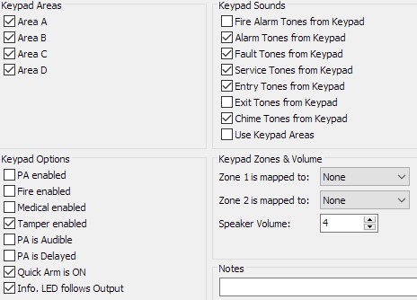

Looking at the screenshot below I just remembered that the info LED also is not working as it used to.
When the Chimes were on the info LED would be on and toggling the chime off would turn off the LED.
As the chime is not turning off the info LED is staying on as it should so it would seem that the output is not changing when the toggle is used although the toggle does make a different sound for on and off which leads me to believe that the keypad button is working ok
As the outputs are not physical I suspect it is a software switch. Looking at the Wintex/Diagnostics/Sytem, C2A seems to be permanently active even though I have disabled it in area options
Just to be certain I have just put the exit tones back on and checked the info LED. As expected it made no difference so the keypad was set as it always has been in 2.11
What could keep C2A lit even though it is disabled in software?
Guys, thank you for your inputs. All fixed.
sparkymarka​
I puzzled a lot over your comments about multiple areas especially as it all worked on my older panel and 2.11 firmware. Ultimately you were correct in that I did not need to have multiple areas or C2A for the chime although the chime zones were in multiple areas.
The problem turned out to be in the pic above. Use Keypad Areas should have been enabled.
