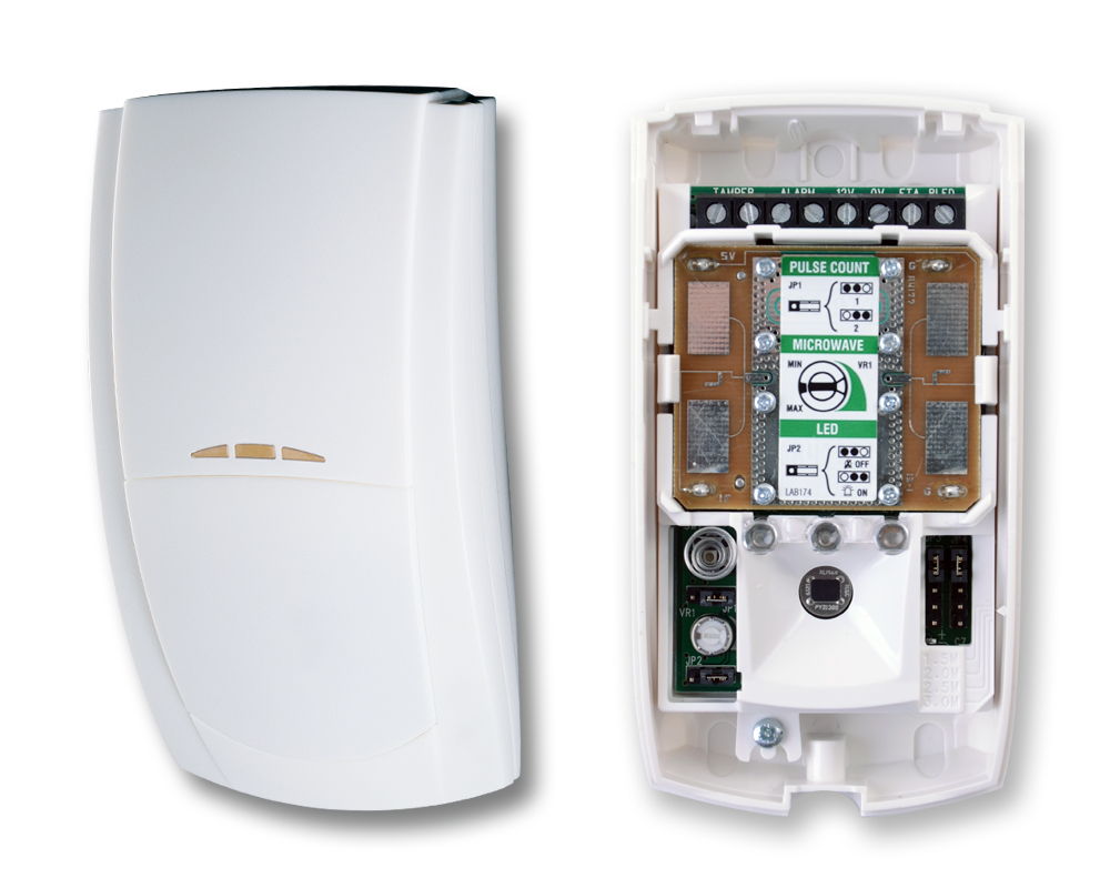

Cannot set alarm as it says landing PIR tamper.
This happened after I had to open and move it away for painting.
I put it in Engineer mode before moving this PIR, but now when setting alarm on there is a bip then I get mssg Landing PIR tamper and after that Contact Alarm Co.
Hoping it can be re-set easily and I can avoid call out charged from the alarm guys
thanks
Also wondering this never happened before when we moved other sensors, maybe PIR or wire got damaged/broken when I moved it and has to be replaced?
What detector is it ? And has the spring if fitted come off , a picture of the detector may help
Hi thanks for quick response.
It's Texecom Premier Elite with three leds, like this one but appears there different models looking all the same on the outside so will have to open it and take a picture.
However I recall that spring didn't come off as it did on the the others.

Hold the bottom of the spring down then gently stretch the spring a little, then put the lid back, reset and see what happens
Failing a lot of messing about you could put a link of the alarm wire in the two terminals marked Tamper
