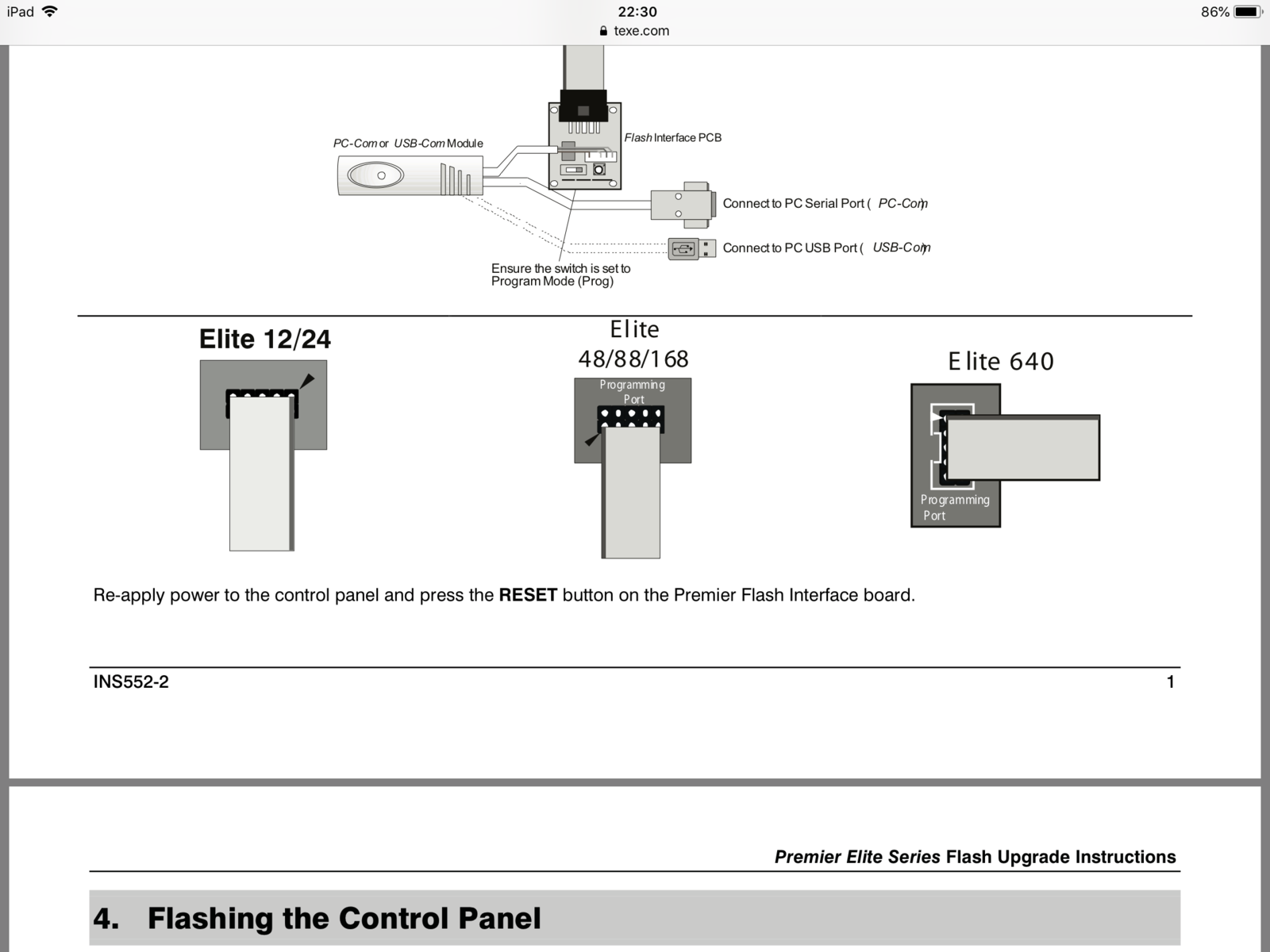

i have followed the instruction over and over again and cannot get connected to the board. Any thoughts or suggestions welcome thanks M
Sounds silly but make sure the flasher lead is in the correct way

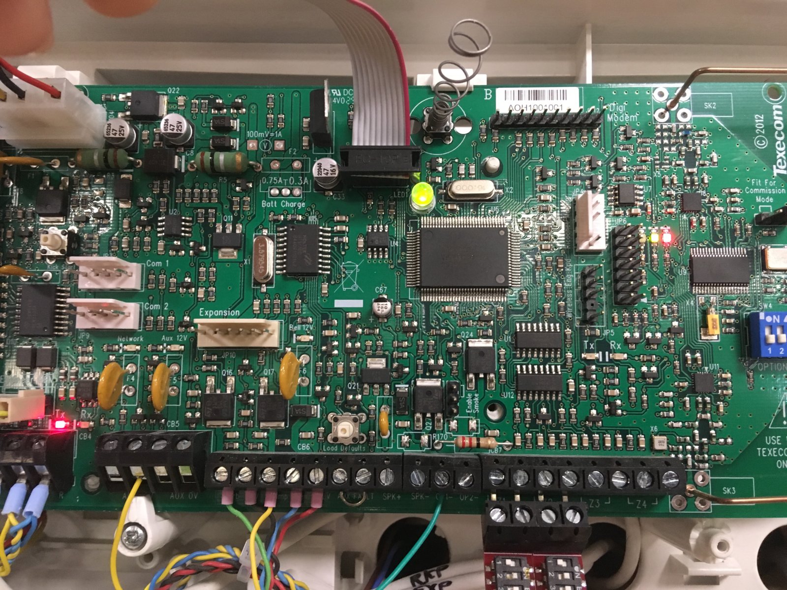

Can it put in the wrong way ,,, the 10 pin one could I suppose ... the others can’t is that wants u mean
Just seen your image I cannot believe I have been that stupid I’ll try that in the morning and let you know
Confused that diagram shows it going down with the line on the left that’s how I have tried but the image from the otherngillyd suggest the other way
#texecom instructions need to be more clearer lol
Right the flash worked I have the right v5 on elite 24.
