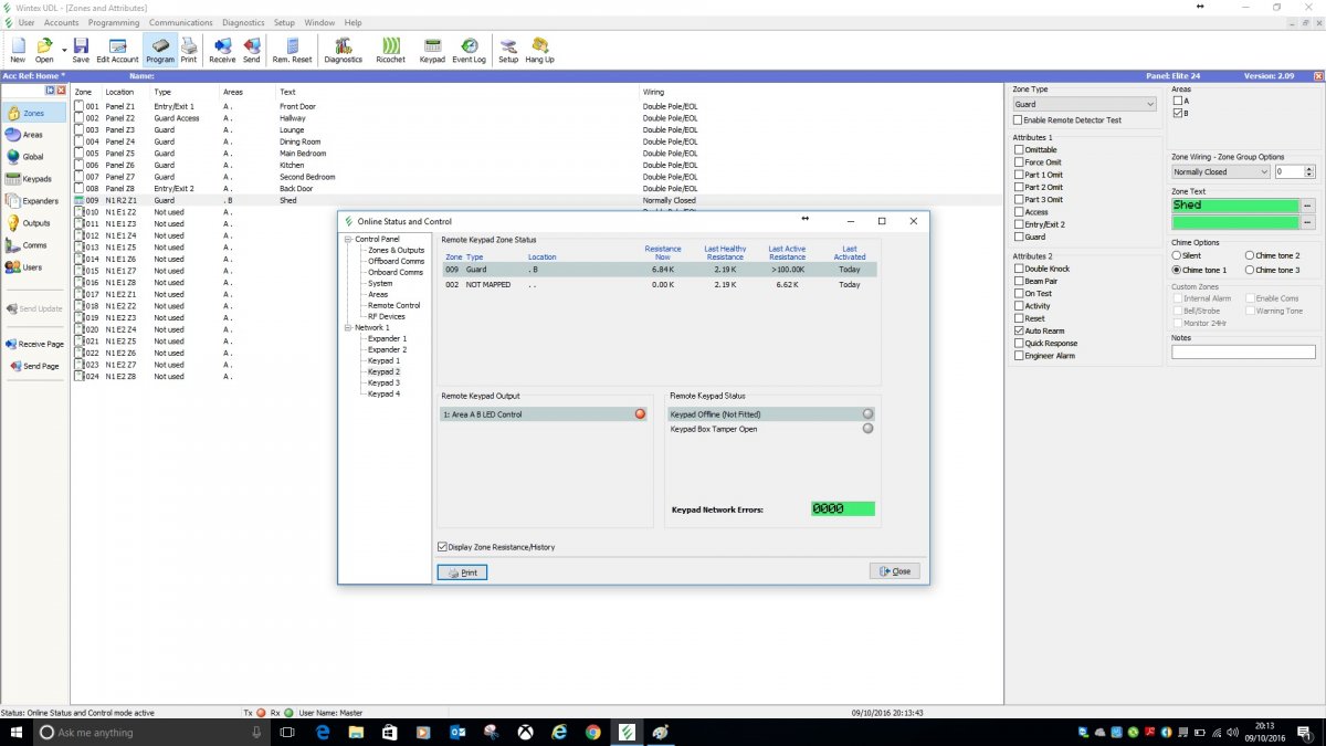

I have a new shed in which I want to install a door magnet. I have run 8 core cable underground from the shed back to the control panel. From there, I have joined two wires (orange and orange/white) to two spare cables going to RKP 2 (blue and yellow). In RKP 2 I have connected blue and yellow into Zone 1 and bridged tamper. Set RPK 2, Zone 1 to map Zone 009 and set it to normally closed and guard.
For now, I have just twisted orange and orange/white together in the shed for testing. My issue is that Wintex shows as being Secure but when I untwist the cables in the control panel, it is still secure! If I enable 'Display zone resistance', I get a reading of 6.84k when cables are disconnected and when I connect them back together it shows 2.13k.
Anyone have any ideas of what could be going on?

Also, I am thinking it must be wired into the correct zone and RPK as the resistance changes when I break the circuit? See attached too.
It doesn't quite add up, as normally closed on a keypad zone on a premier is first alarm and last tamper, and you have the tamper shorted out. this would be double pole if the two wires are wired into the alarm terminals.
you telling me your seeing resistance values that appear consistent with doublepole/eol wiring type using 4k7 across the alarm pair and 2k2 as the end of line resistor.
if you have no resistors in play I would change the wiring type to double pole, as then the alarm pair would the first two alarm terminals and the tamper pair you have shorted would be the tamper shorted out.
as for the values did you measure them with a meter to confirm what you saw on wintex was actually happening.
Oh I see. So I need to change zone 9 from normally closed to double pole? If that is the case, would removing the tamper short and setting it to normally closed work? I have not tested with a meter.
1st alarm terminal and last tamper is normally closed
the same can be used for resistors or normally open
wiring into first two alarm terminals and linking out the tamper is double pole.
so to work as normally closed, assuming there's no resistors involved remove the link from the tamper, and move the 2nd alarm terminal wire to the last tamper terminal for that zone on the keypad.
