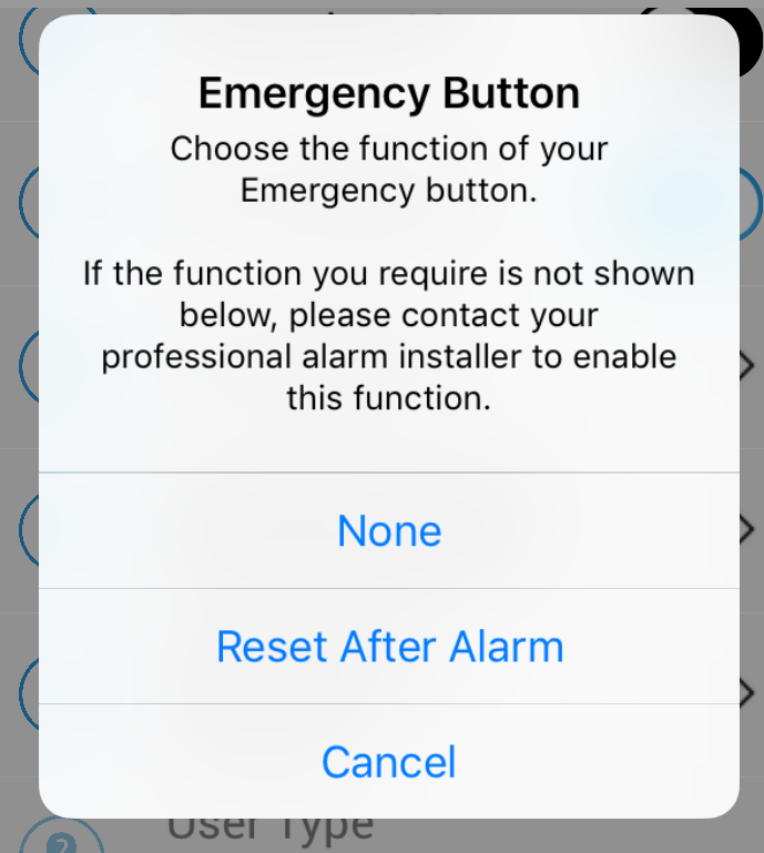

- I have setup the connect app and would like to know how to use the 'emergency button' to activate the alarm remotely like the panic button. Is this actually possible?
- I currently have it setup to perform a reset, although a notification informs me that for further functionality of this button i am to contact my engineer (Me obviously). I have had a look via Wintex but cannot see any options.

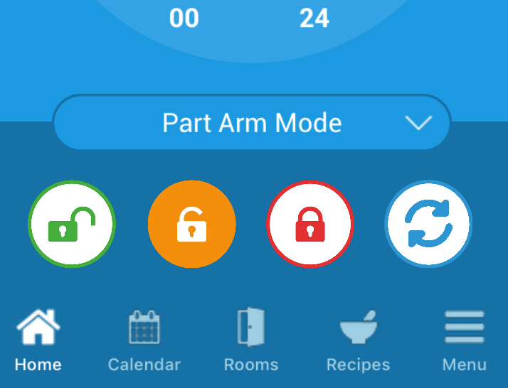

I have attached some images to aid explanation.

For the panic button to work on the app, you need to program the last keypad that the system could have (ie keypad 2, 4 or 8... depending on panel (keypad does not actually have to be physically on the system)) to have a keypad PA, you can then assign it in the app for individual users.

Sorted the panic button on the app! I’d never of thought of that one!
