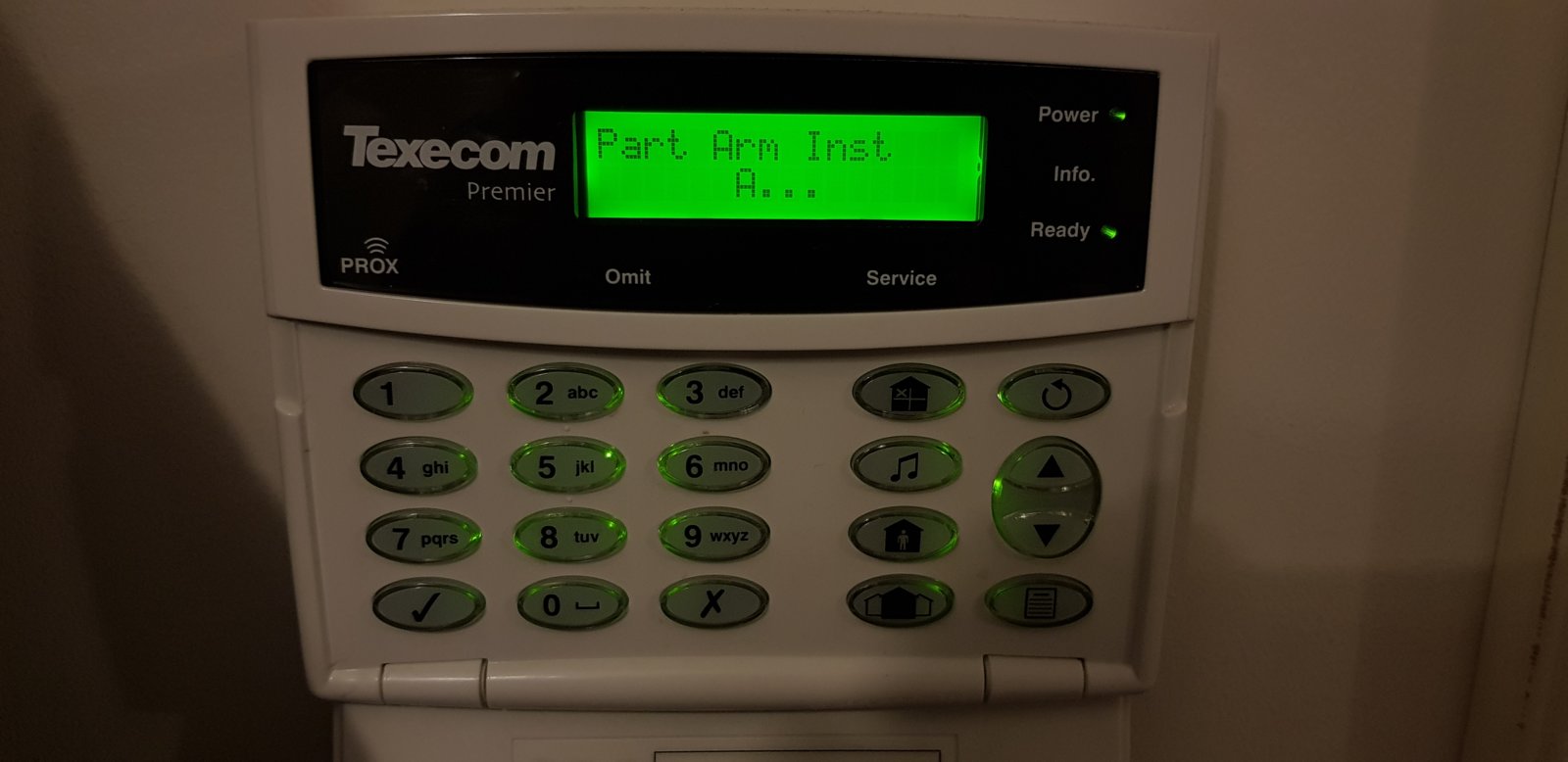

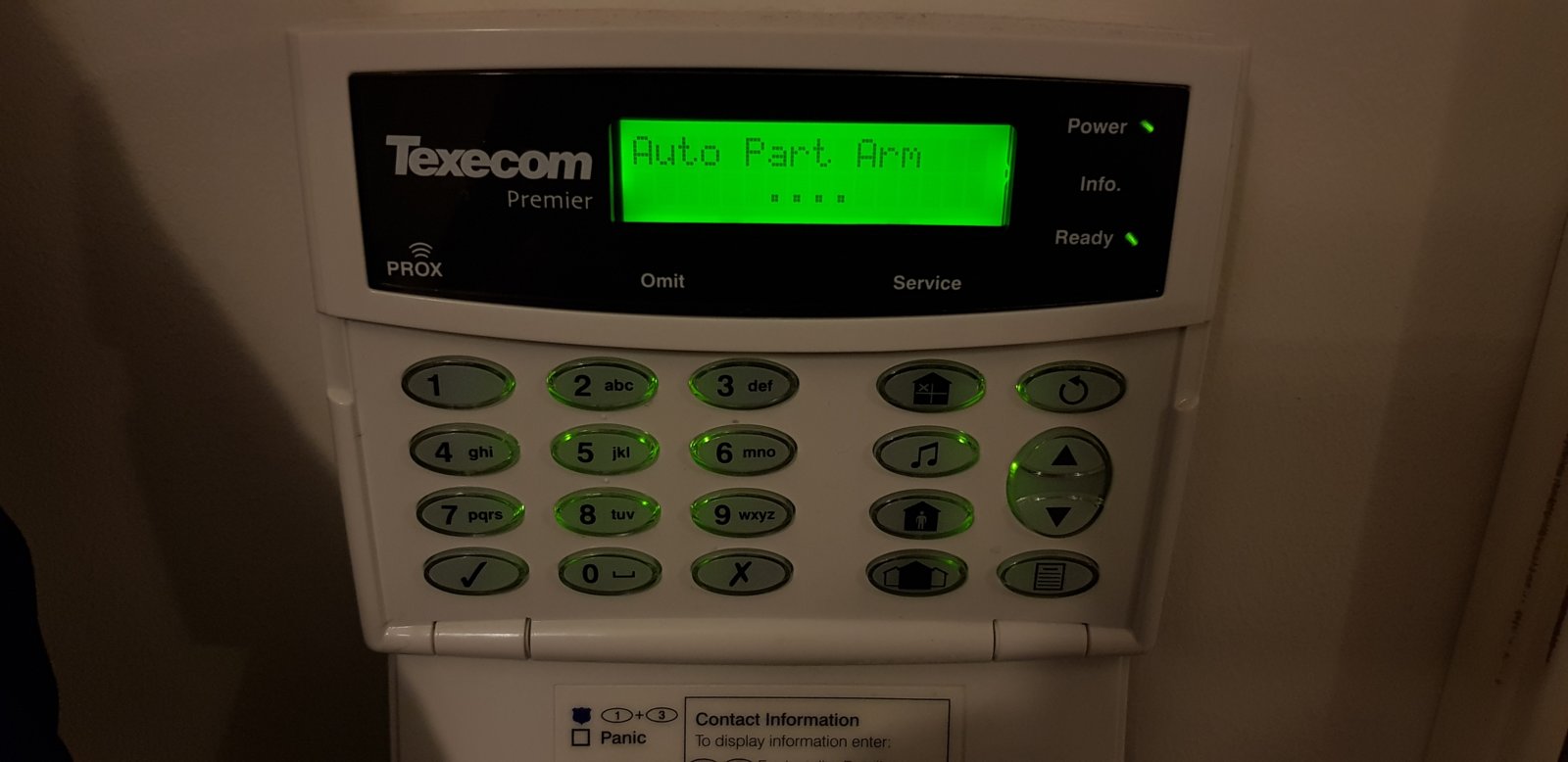

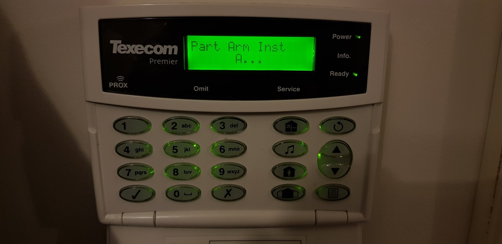

In area options I changed the part arm instant from A*** to ****, I was able to leave the front door and shut it, it set the alarm fine, however when coming back in the door the alarm set off, I'd like the front door to still be alarmed when only omitting the PIR I want but still allow me to enter through that door.

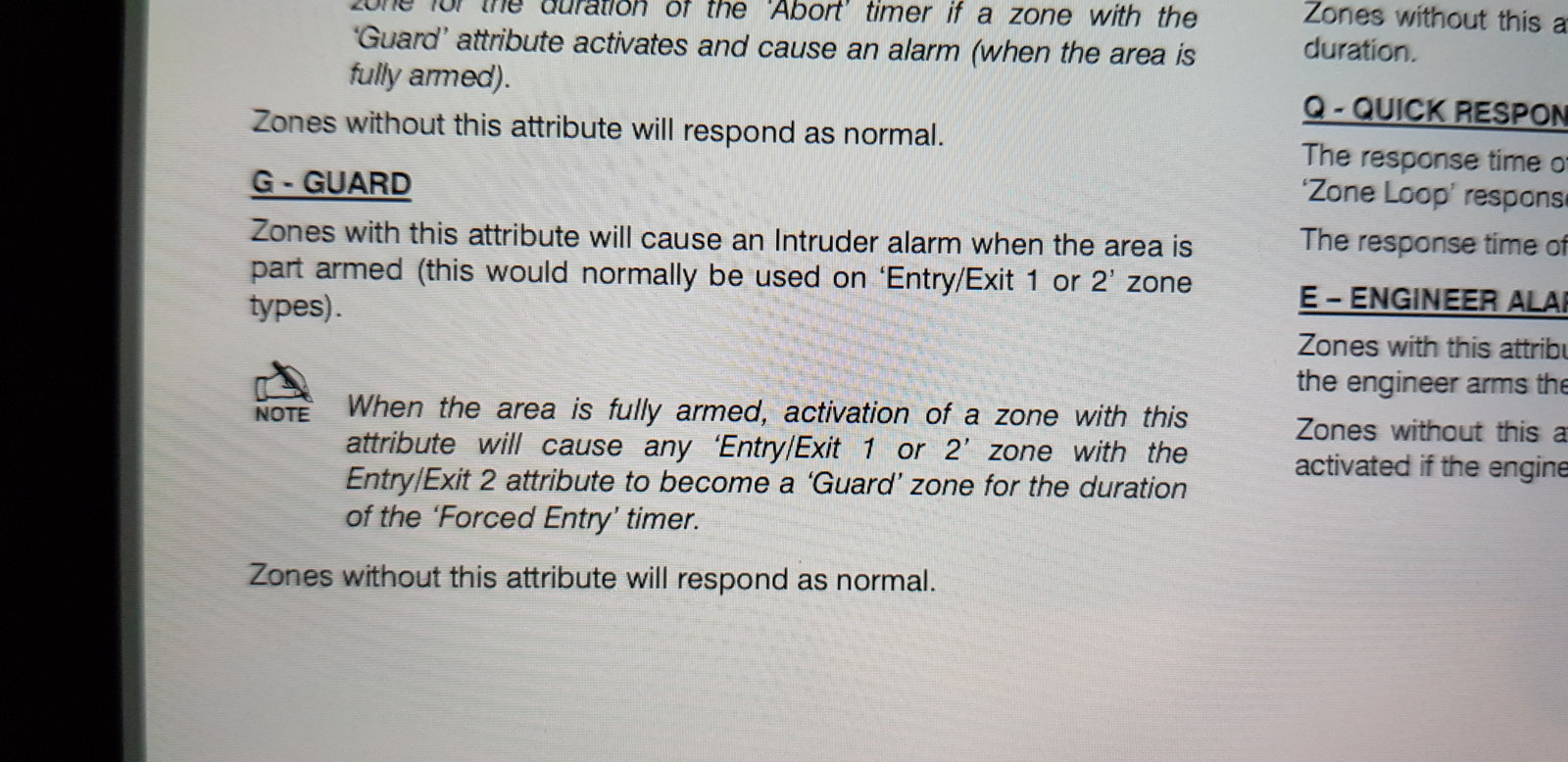

Ah, going back to your Guard thing, I removed the Guard attribute and the entry exit works as it should. Great!
But will it effect any other arming modes? Or does the alarm choose it as Guard attribute as standard when any entry/exit type is chosen for that zone?
