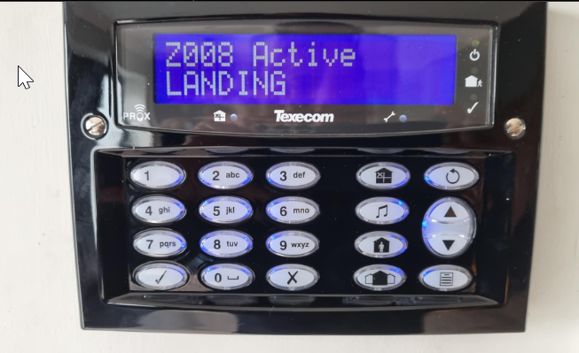

All is working fine, and the remote access app is working great. On the keypad it has the date and time showing, but when a person walk in front of a sensor and activates it, it shows up on the keypad "Z001 ACTIVE HALL" as an example. Is there a way to disable this from being shown? My understanding is just the date/time is normaly dispayed on the keypad, without the zones flashing up everytime the sensor is activated.

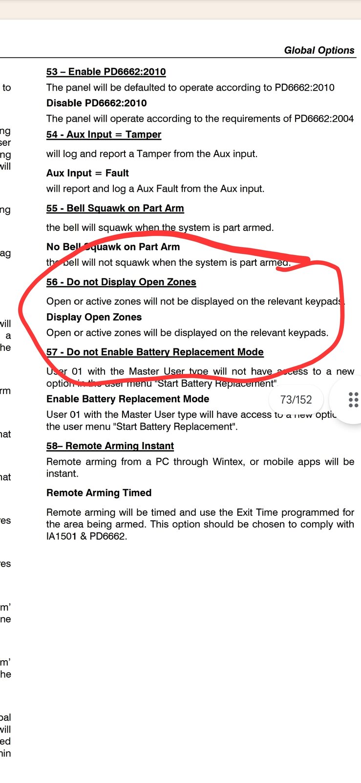

This is probably being caused by this parameter, it can only be altered using the engineering menus.

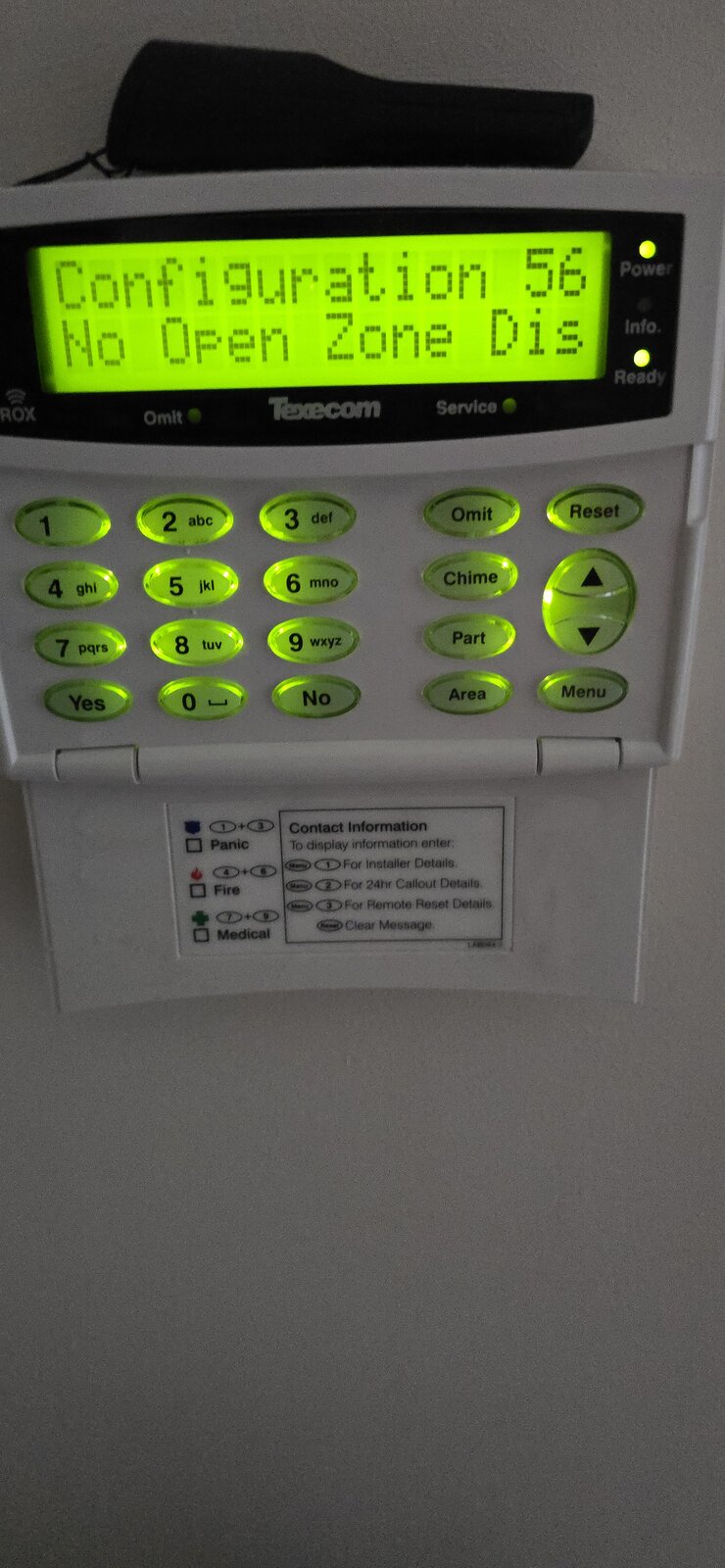

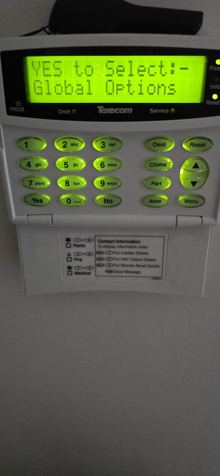

I can, enter the engineer code-it should display 'program zones', press 3, then yes, will take you into 'Global options'.

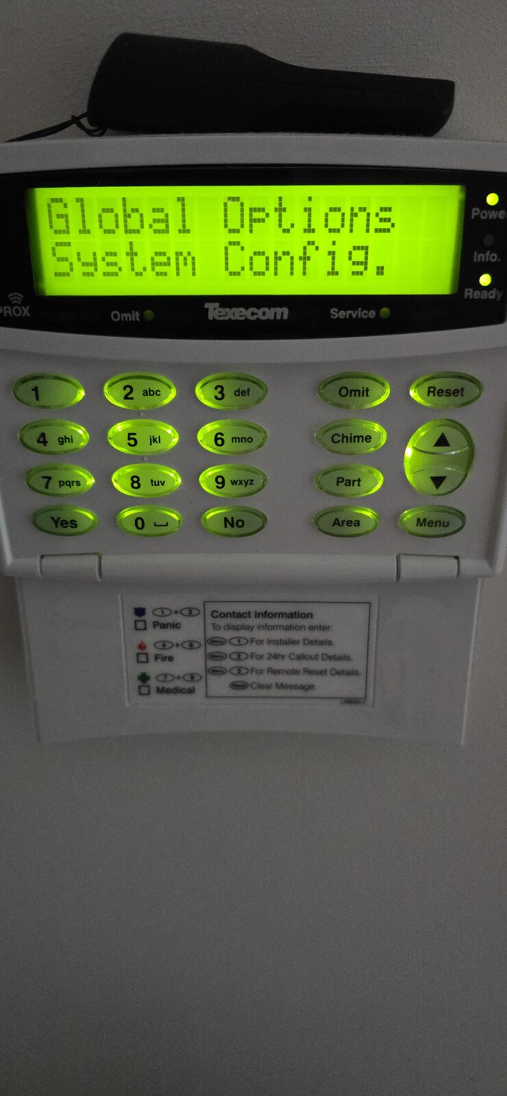

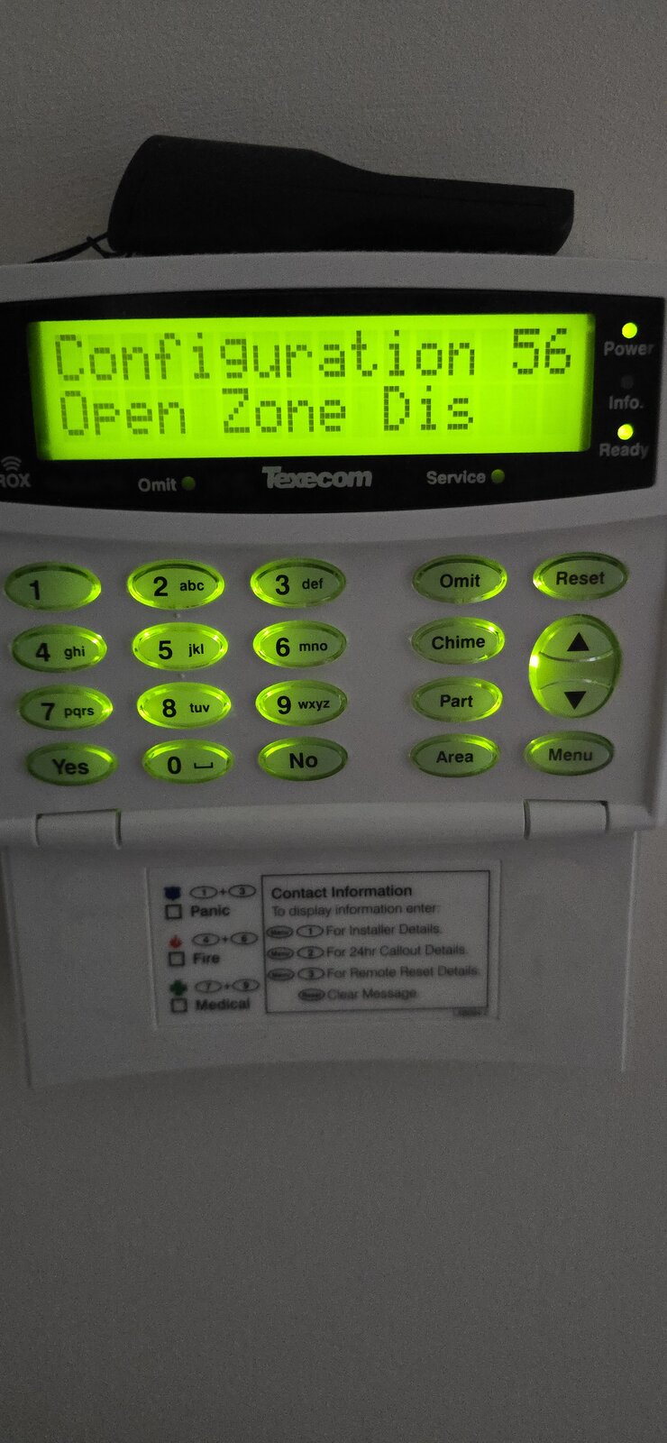

Scroll to 'System config', press enter, type in 56, if you're on 'view open zones' press no, and it should change to no.
Press menu a few times until the display asks if you wish to log out of engineers-press yes.
Hopefully that should just leave date and time etc on the display continuously.

Amazing! That done the trick!
Would never of got they on my own, so thank you very much! It was one of those niggly annoynces! Hopefully this helps anyone in the same situation.
