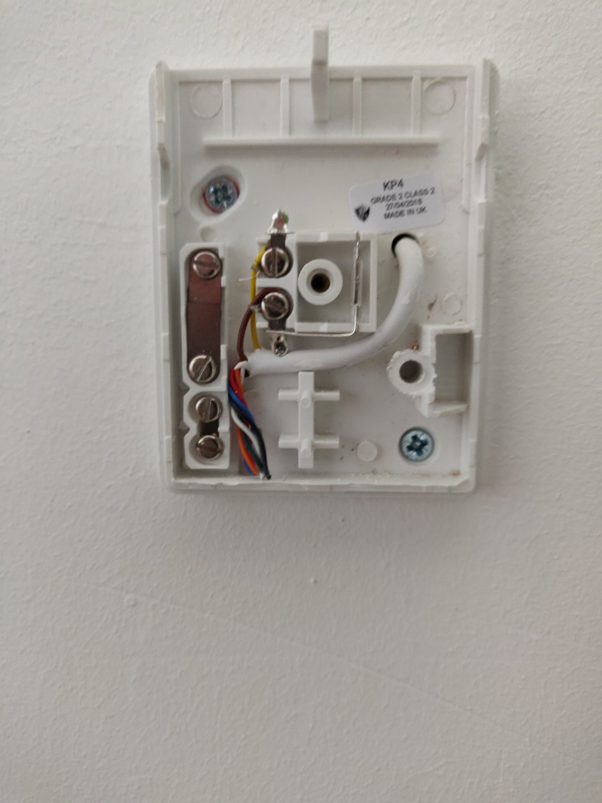

I’ve got to add a door contact and panic button but just trying to get my head around the wiring for these.
The door contact I’ve got is this one https://www.powersaver.co.uk/knight...rglar-alarms-available-in-white-or-brown.html
And my panic button is https://www.powersaver.co.uk/knight-kp4-latching-double-push-panic-attack-button-white-plastic.html
Will I need to use the resistors in the door contact?
Ok, so a bit more reading on this and I think I have found what I need.
For the door contact I will use 2 core fsl with the 2k2 and 4k7 resistors which then just wire back to the zone on the control panel.
For the PA, I think again I can simply wire using 2 cores to the contacts in the PA either side of the glass tube.
Have I got it?

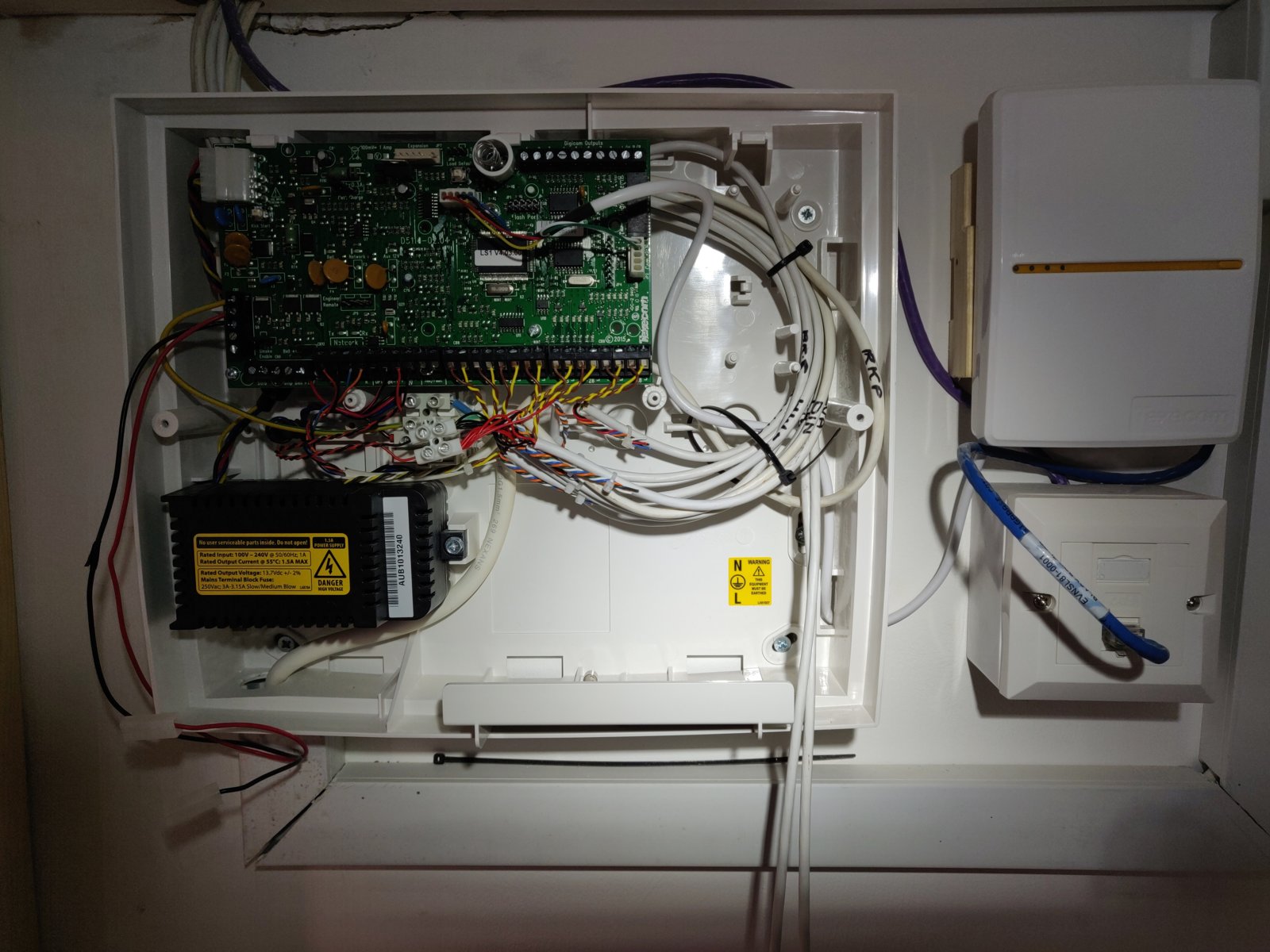

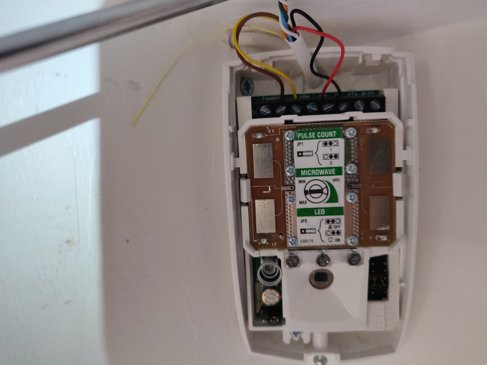

I've managed to do a little more this weekend, I've wired up all zones now.
Z1 - Door Contact
Z2,3,4,5,6,8 - PIR's
Z7 - Panic button
Hopefully this looks ok?
All pir's are wired like this.
Haven't connected up the external siren box or internal speaker just to minimise the noise while setting it up. Also will add battery later too.
My plan is to power it up next and program the zones.

Z7 - Panic alarm, I believe is wired as EOL (not totally sure about how it should be programmed yet)

Update, power on now, couple of errors, box lid tamper, RKP tamper and zone 7 tamper).
box lid of course as the CP is open.
I hadn't adjusted the screw in the back of the flush mount RKP panel, adjusted that to fix the tamper.
Not sure about the zone 7 tamper at the moment, thats the panic button.
