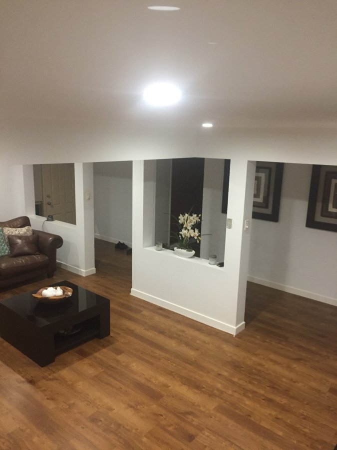

Yeah its a little dog, Shih Tzu X Poodle weighs less than 10KG, biggest problem I see with the dog, is she likes to sit on top of the sofa in the lounge which is where the PIR is facing 7-8 meters away.
That was always going to be the problem PIR... with the dog and the Front door so might have to reposition it on the other side of the room, or remove it all together.
Is over lap a problem if the PIR's are on a different zone?
I am not going to achieve total coverage with the house layout that we have, so was concentrating on the main areas:
Main Bed=PIR
Dining Room= PIR
Rear Lounge=PIR
Garage roller door= Roller door contact
Front door= Door contact
Internal door to Garage= Door Contact
Main Lounge=problem zone with E/E (see photo) that's what I meant by open plan ish... photo was taken from PIR location, sofa in background is where dog likes to climb onto, and to the right of sofa through the last hole in wall is the Front door...

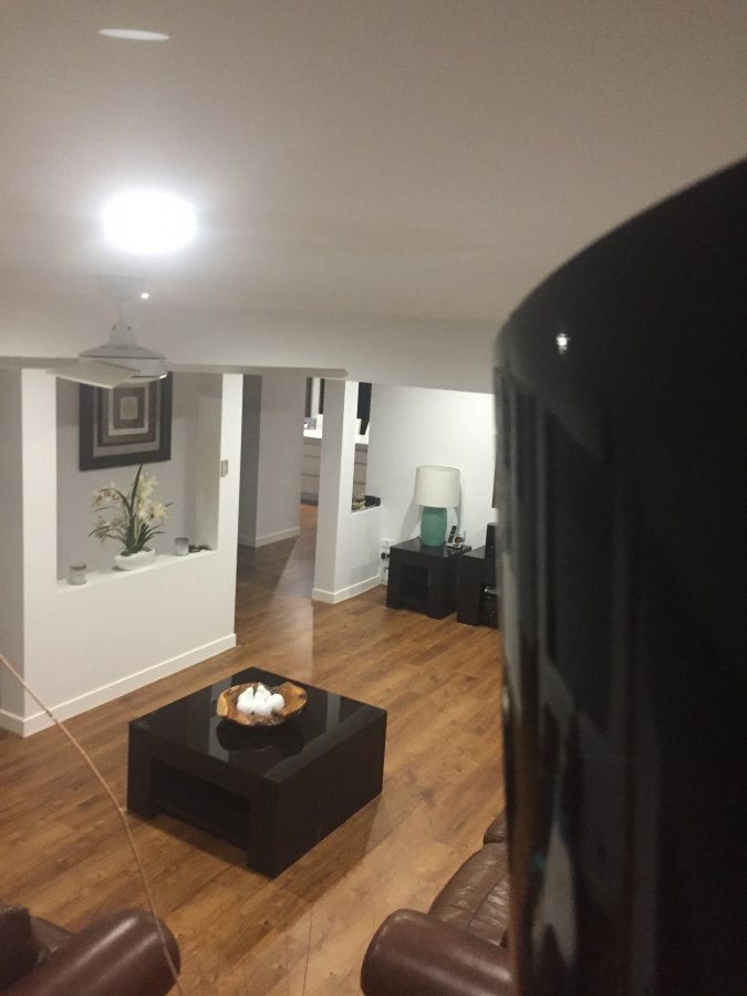

I could reposition Main Lounge PIR into this corner (see pic) that big black lump in the photo is a wall speaker, would that cause a whole heap of grief to the PIR? I know it will affect overall and ultimate coverage, but would sacrifice that if I had to...

Hi guys,
Having given some thought on the lounge pir and the dog, I am now thinking of putting the pir in the hall which would mask the sofa that the dog jumps onto, and setting it up as timed e/e and doing away with door contact on front door.
Are there any major draw backs setting it up like that?
Gary
No
What engineer is saying is
Make the door contact final exit in programming.
When the door is closed will set as soon as door closed and not at the end of 30second exit time.
Exactly.... have a PIR too as Guard access if its in the entry route area, it will also help in reminding you to turn off alarm on night set in the morning.
Ah ok,
And still set pir in hall as timed on entry?, as it will activate when front door is opened
Program Hall as Guard Access. It will be automatically omitted during entry timer when front door opens first. On part set the Hall PIR will start the entry timer in the morning.
