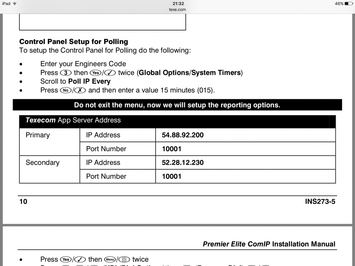

Control Panel Setup for Polling
To setup the Control Panel for Polling do the following:
  • Enter your Engineers Code
  • Press  then / twice (Global Options/System Timers)
  • Scroll to Poll IP Every
  • Press / and then enter a value 15 minutes (015).
    Polling must be first set up via the keypad programming and NOT via wintex

OK, thanks for the feedback. I have already tried your suggestion (using the keypad and not Wintex) without success. Do you know if there is a way to tell if the panel is polling correctly i.e. is anything written to the event log? The reason I tried a different polling interval is because Texecom support said the panel should update itself automatically to 15 minutes, thus, if I entered 1 or 5 minutes as the polling interval and the panel polled to their sever successfully, it would automatically update itself to 15 minutes. This has not happened so my current working assumption is the panel is not polling correctly.
Has it got the correct server numbers in the unit ?

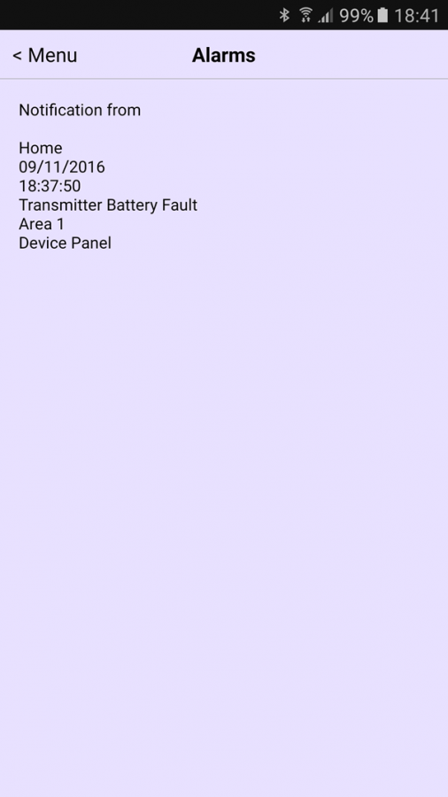

I am now pleased to say that everything is working as expected. I have tried multiple test calls and each attempt has been successful. I am receiving notifications on my Android device. I do have one quick question. When I carry out a test call I receive the following notification on the Texecom App. Is this a normal response to a test call? I thought I might receive a notification saying the test call was successful rather than a warning about a transmitter battery fault. I just want to be certain this is a standard notification rather than another possible problem with the panel.

Not sort about the battery fault ?
I would set alarm off by a device and then check that the information is correct.
