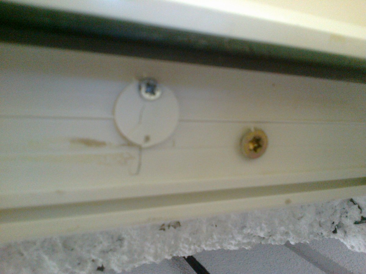

I have one door that started activating alarm approx once a night but this happens after many hours eg 5am this morning. Seems something wrong with contact. In interim is it ok if I set it for double knock? Will that help? Is this commom for contacts to wear out? It is PVC door.

Thanks. I have just had a better look at the contacts at the door causing the alarm and it seems like a real butcher job in comparison to other contacts (same installer). The contact has been attached to the door with a screw and it has cracked because there is was screwed into an uneven spot. Can I assume that is this what is causing the alarm to go off?

Personally if the zone appears to be a problem I would switch it off until its repaired.
Installer actually left one of those connecters when he left. Are they easy to install?

That zone covers the two back doors so would rather not deactivate.
0039 05:17:35 24/02/2016 Alarm . . Zone 004 Guard Alarm - KITCHEN DOOR

As far as I know out of business and ignoring my calls!
Is it skilled job to replace the contact?
Does the log show anything?
