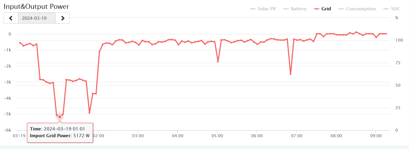

I cross fingers and hope it does not happen to me. My home could draw over 60 amp, but never see the load get that high, and it is not common for DNO fuses to rupture. Clearly if multi circuits are loaded to max, then total could exceed 60 amp, however 40 amp is my biggest RCBO and to have 20 amp draw from all other circuits does seem unlikely, only way I could really exceed the 60 amps is for two showers to be used at the same time.
So it does seem likely a faulty or stressed fuse in your case, as what you list gets no where near 60 amp. I can see my use 1710840027730.png and the max I have seen is when showers are used, but in the main the max is just before we go to bed, when making coffee, and the battery is charging. I will admit easy to forget about battery, it is charged 0:30 to 7:30 and since automatic easy to forget it happens. So 5172 watts is kettle 3000 watt, and battery 2000 watt plus lights etc.
Unless you have missed some thing like a battery being recharged, is seems unlikely due to overload.
