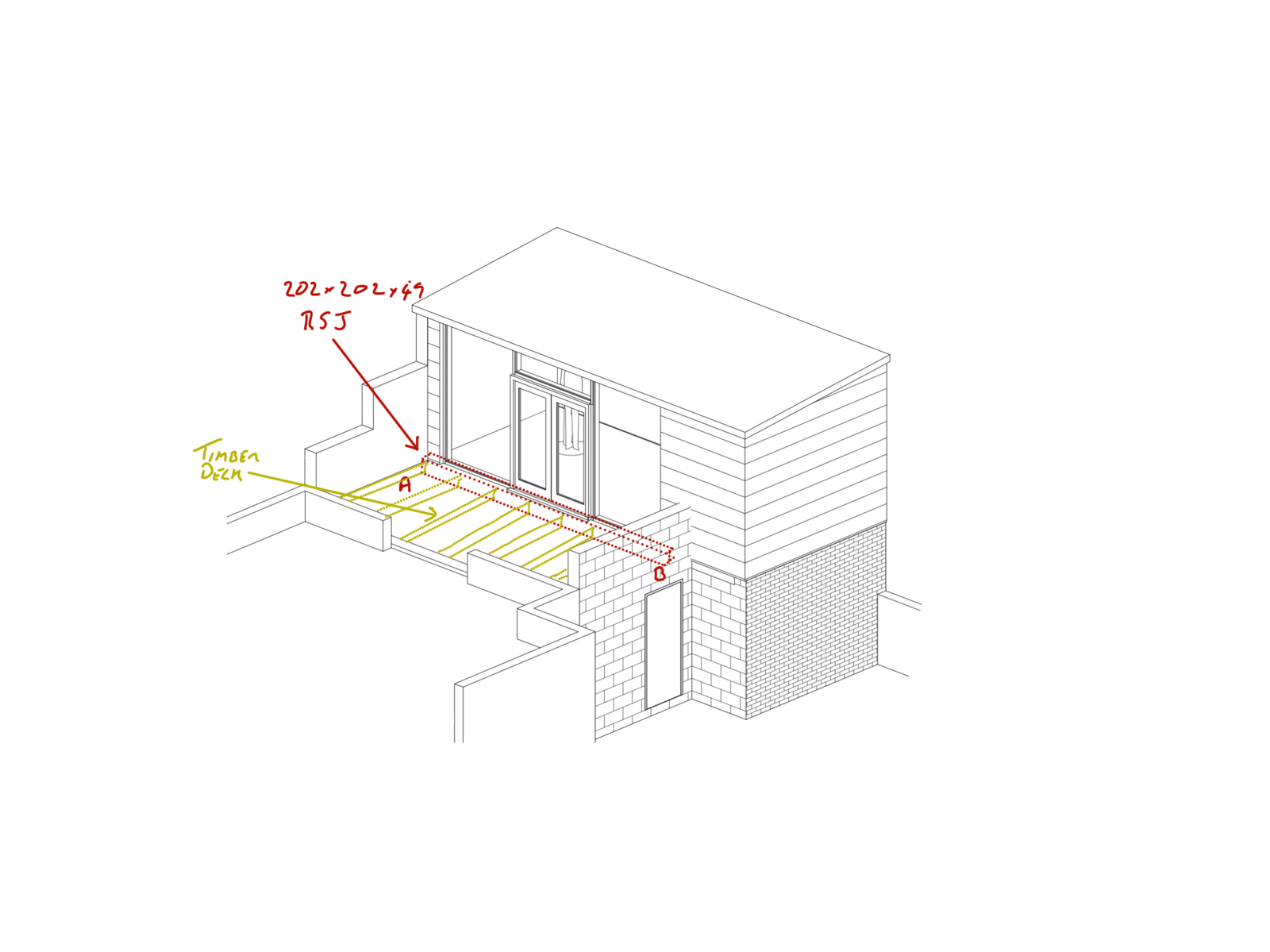

As shown in the attached picture, I am building a 2 story building, garage below, art studio above. The garage is not subject to regs but the studio is.
The design has an RSJ supporting the full upvc frontage.
given the RSJ is exposed on the outside, it is supported on the inner leaf and it’s supporting the inner and out relief walls, surely that is a significant thermal bridge and as such against regs?

Yes, a steel beam supporting the inner and outer leaves of an external wall is a cold bridge ,you need to minimise the risk of condensation due to cold bridging by thermal insulation (a construction detail drawing required ) I would have 'proper' architectural drawings prepared for the whole building so that it complies with building regulations.

I would imagine your art studio will need to comply with part L.
A steel beam either needs to be all on the warm side, or it will need a thermal break -ie clad in PIR celetex.

it will need fire protection where it’s exposed in the garage as I understand it. For insulation I’m thinking pir on the vertical faces of the RSJ between the timber joists. Then a upvc facia piece to provide mechanical and weather protection to the pir.
Thermal bridges are mainly problematic because of condensation. The humidity in a garden studio would usually be lower than in a kitchen, which is where these kind of beams are usually found.
So you are likely to get away with more than the worst case, which the regs and calculations assume. I presume that's what woody is getting at when he differentiates the worst case theory with the actual situation.
Having said all that on our kitchen beam the outside was clad with a thin layer i think 25mm of polystyrene insulation before the render went on, and there hasn't been any obvious condensation yet.
uPVC fascia board isn't really insulation, and there's a lot of surface area of steel on the cold side there.

thanks John that makes sense. The fascia is proposed to provide protection to the PIR insulation.
That sketch does not insulate the flange where the cold bridge occurs. Looks a tricky detail at the interface of wall/floor/decking - needs a proper construction detail drawing. Looks as though there might be some other 'interesting' construction details on that job.
