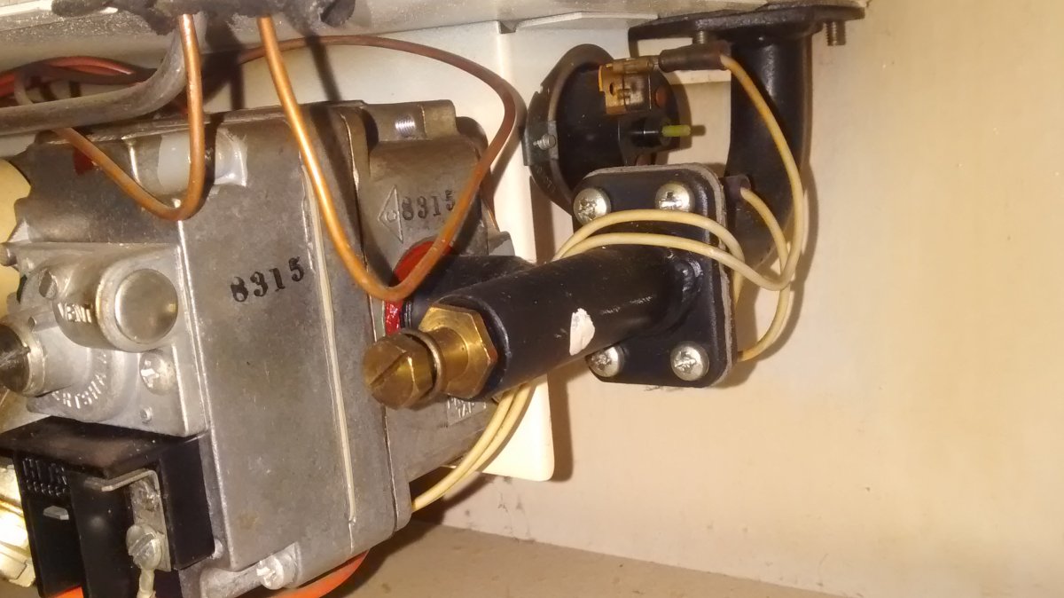

Thermocouple wanted
Can't believe the boiler is being scrapped for want of one of the most common parts to ever be sold and that the OP is using the same person to change the boiler.

Cheers, can you get one of side view of right side. cheers
Is this any good?

Does that overheat stat/ interrupter looked to have popped out?

I'm not using the same person to change the boiler.
Dont normally like to slag off other rgi's. But if that is the case then words escape me how useless the op's rgi was!
By the way @les186. I have a stock of the now obsolete special resetting tool that you need to use on these.
Can send you one for 35 quid plus P&P if you are interested
Rather reminds me of a certain range of Woofters where they started putting the OH stat reset on the top of the casing...had quite a few on my old patch in Devon where previous numpty engineers had been fooled by the fan still working normally, and had changed the gas valve, the PCB and eventually the fan itself to no effect. Sometimes, you've just got to know where to poke it!
