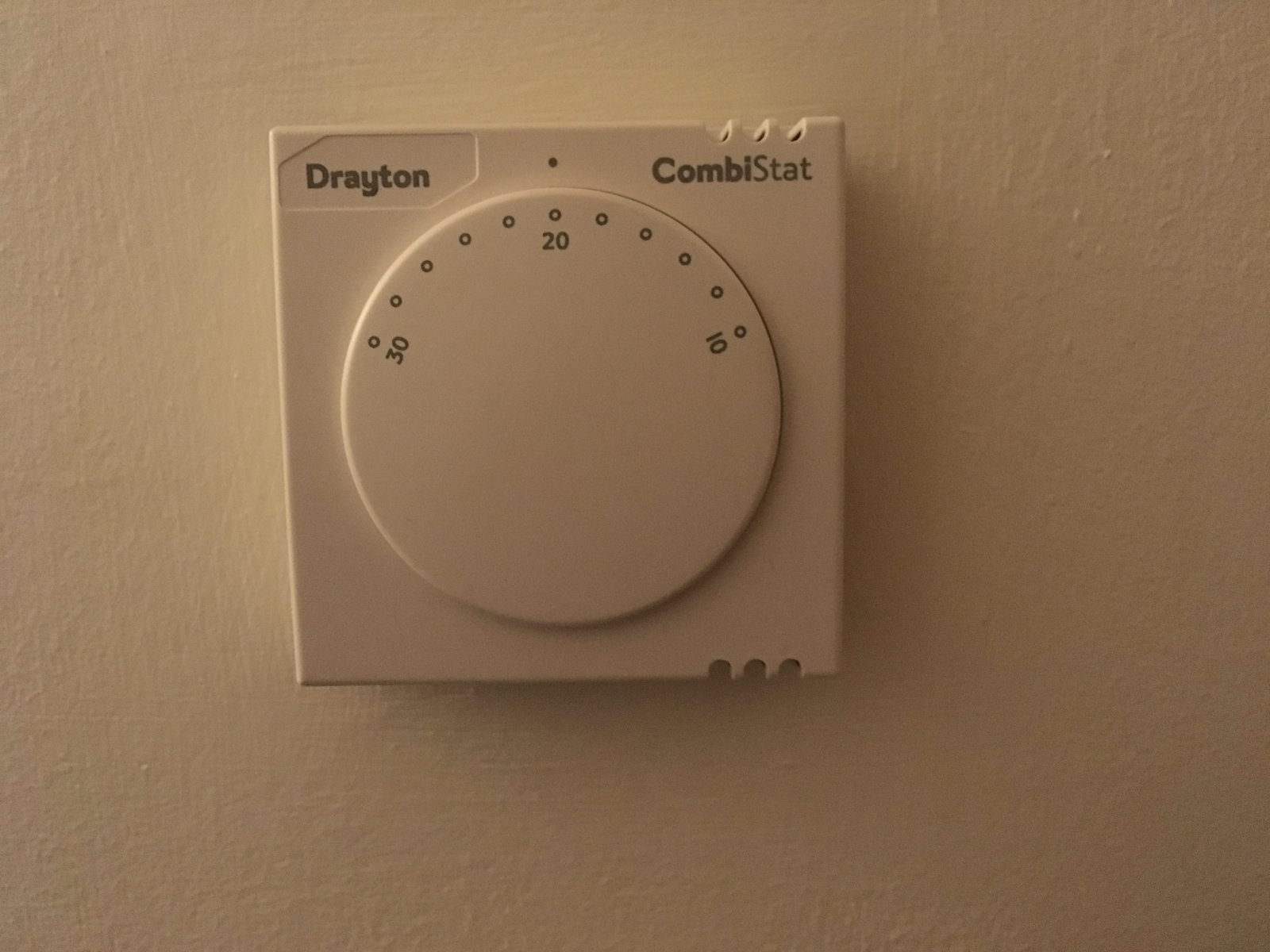

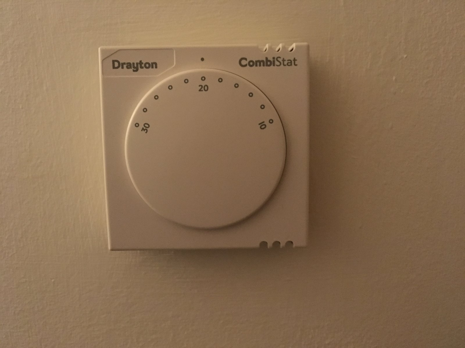

Hi all, hope someone can help please.
I have recently replaced an ageing mechanical thermostat with a new but inexpensive Drayton “CombiStat” (1). It works ok but my heating switches on an off much too regularly - on/off approximately every two minutes which is clearly very inefficient and pretty noisy at 7am too.

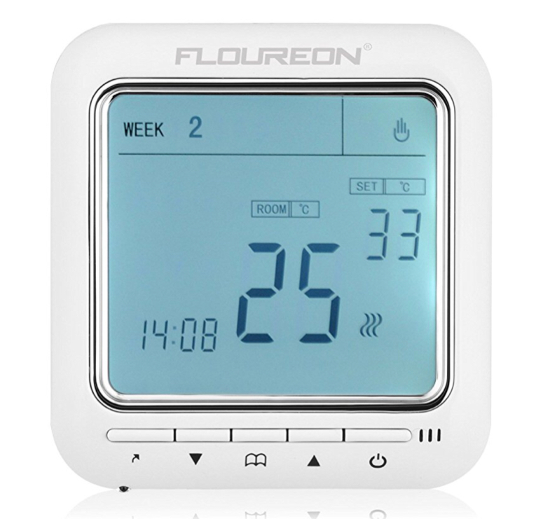

I was advised to try a digital thermostat as they apparently switch more intelligently and as a result are much more efficient, so bought a Floureon (2) (https://www.amazon.co.uk/dp/B0752F87K8/ref=cm_sw_r_cp_tai_WhQrAbKV5SE7Q). I installed the Floureon attempting to follow the Chenglish instructions and managed to get it up and running, display working correctly, etc., but it didn’t actually fire the boiler up when the require temperature was set much higher than the current room temperature.

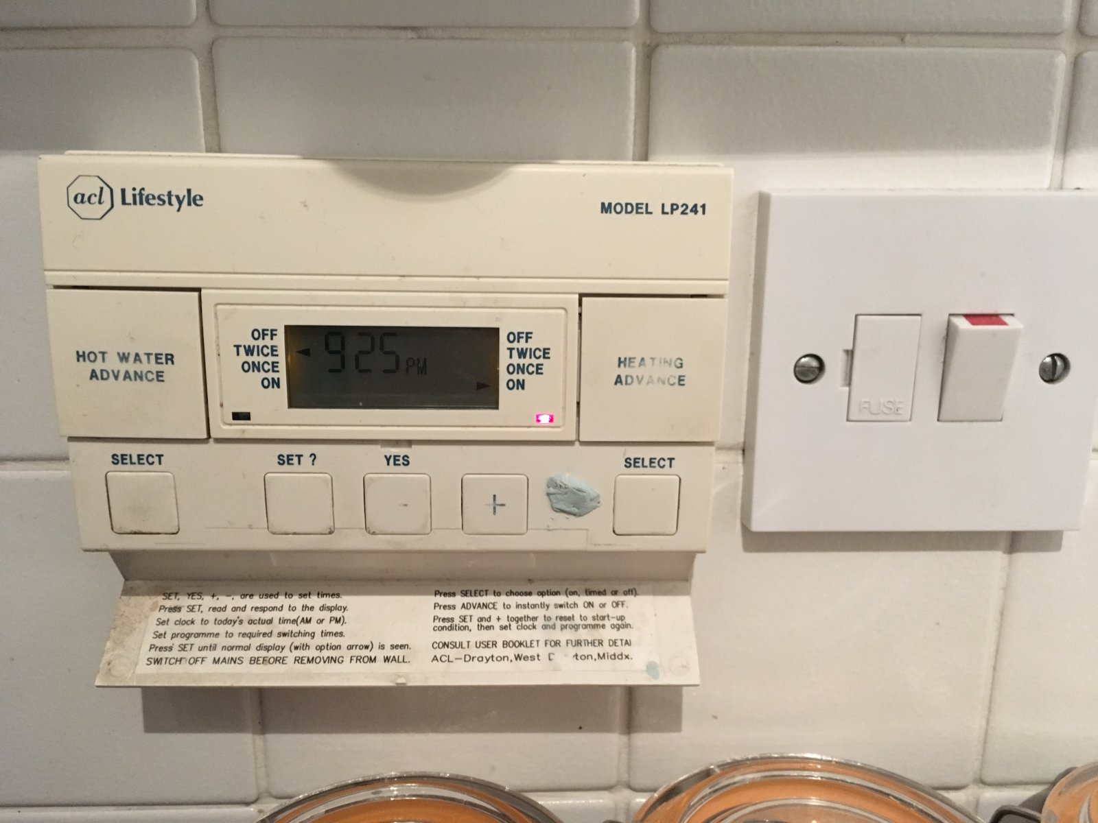

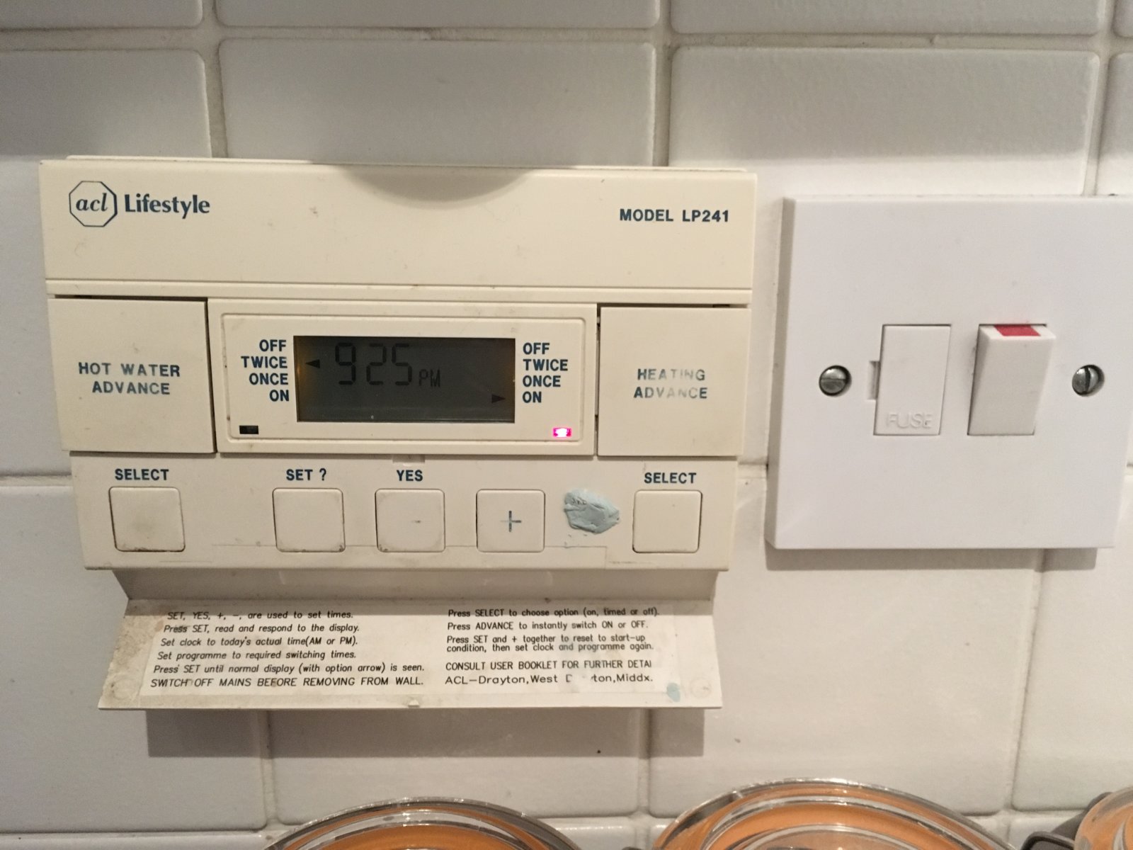

I am wondering if the old timer I currently have installed needs to be set in a particular way or even bypassed altogether - it also controls my hot water - I tried it set in all possible states, but to no avail.
I’ve included photos of the current mechanical thermostat and the current installed water/heating timer.
Many thanks in advance.

I doubt if the room stat is switching your heating every 2 mins. Whilst your system is running, monitor the thermostat in the junction box and I'm sure you will find it does not switch. Cycling such as you describe is usually down to the boiler thermostat and caused by poor circulation.
Ok thanks oilhead. The system is very old - 80’s - and desperately needs updating, but for now I’d still like to install this digital thermostat if possible. I’m told the boiler is gravity fed and the last plumber I had said he was amazed it was still running.
Anyone know if this thermostat will work alongside my current equipment please?
Many thanks
You’d be amazed at how many people with boiler issues think it will all be cured by installing a funky new thermostat!
It’s just a switch! Remove the stat and link the wires... bet your boiler still short cycles!

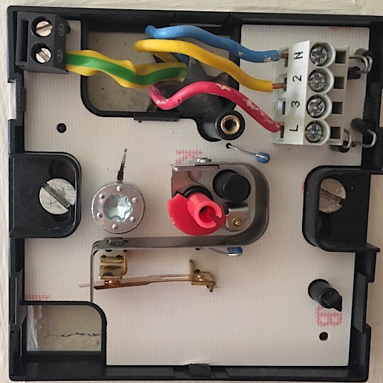

Currently, the old one is connected as shown below. The problem is, it’s bypassing the timer. Ie: even if the time is set to OFF, the boiler/heating still start up depending on the thermostat setting - so I’m constantly having to manually adjust the thermostat.

You now have two room thermostats and two timers, no wonder you are having problems.

You need a pro in mate coz that all needs tracing and identifying before you can get it setup with whatever that Floureon crap is. It’ll need hybridising as you’ll likely need the old prog for your hot water timing and then leave CH side constantly on whilst new gizmo takes over control of that! So CH on constant and then wires from that to prog/stat to power it up and make switch during a timed “on” period and when stat calls for heat.
Fair enough, I’ll get someone in asap, which will more than likely be a week tomorrow with any luck. Thanks for the info.
So, forgetting about the Flourean for now, can you hazard a guess as to why the ‘older’ (and much more basic) Drayton is overiding the ‘off’ setting of the timer? Do my connections look correct at least?
