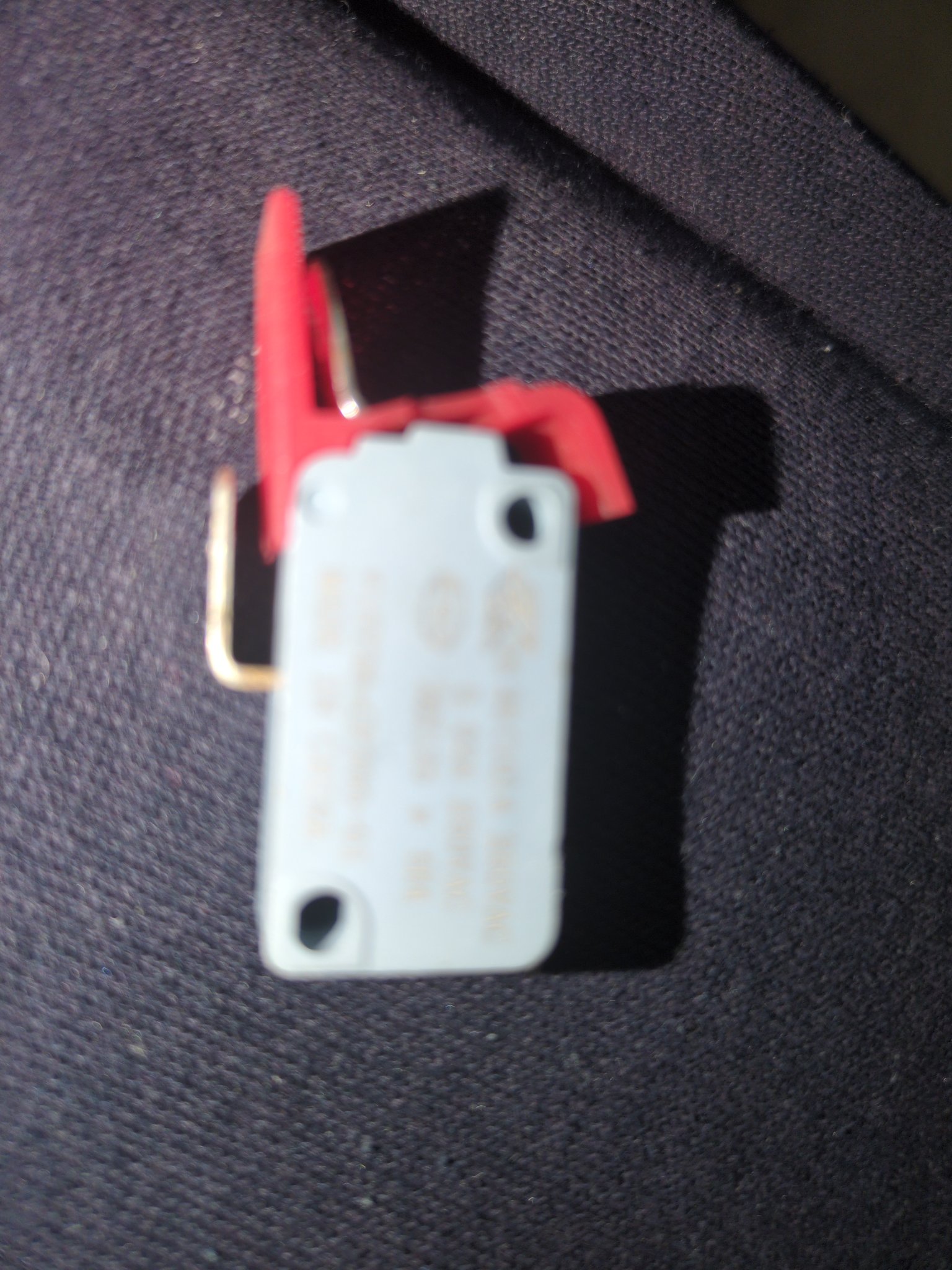

Thermostatic electric shower low pressure display always on
You can, and also probably the Ebay one. You'll see on the existing that the same two spade connectors are used.
I called Triton spare parts and they confirmed that for 8.5kw T80z thermostatic shower I need the Triton micro switch 2201460. This is the correct part number and this microswitch has 2 L shaped connectors. No variations in part design so only 2 shaped connectors. Regarding fitting the microswitch; is the black button on the switch pressed in by default when installed?
I don't think it will stay pressed in or out, just fit as it comes and it should be sitting against something on the inlet valve which will do the "pushing" dependant on water pressure.
There are locating holes on it so you can't really go wrong.
