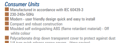

here's a few pages worth:
I suppose they could replace the door with the same material.
I cannot find any plastic ones which state they conform to 61439-3 - still all 60439-3.
So, non-combustible or not - still not compliant with Amd 3.

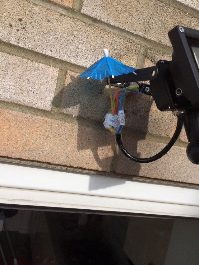

I've also seen stuff like this. Just because it exists, doesn't make it rightView attachment 93830
Maybe not, but that's not what you said.
