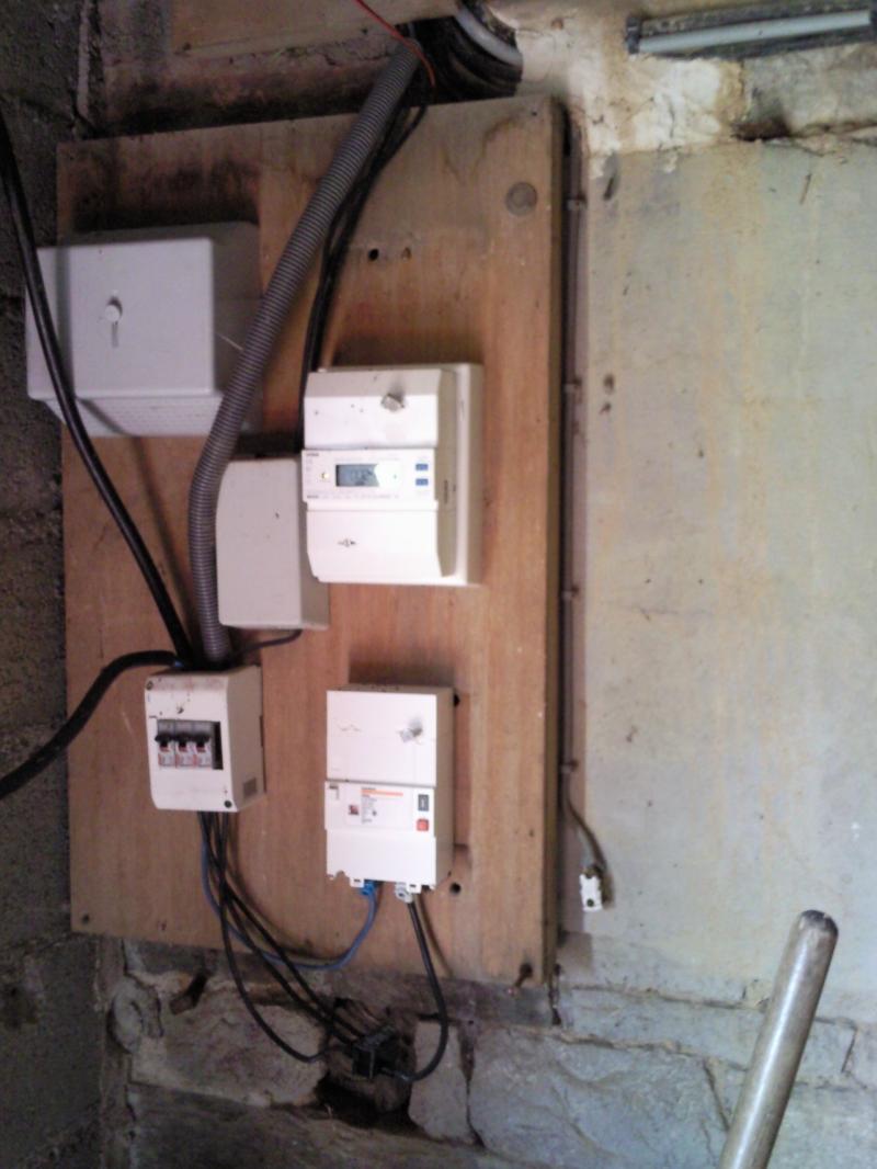

This shows the mains intake in the garage. A mess. And I cannot see any earths (though the chap had a surge protector which indicated presence of earth). The white box top left I assume is the main incoming box, where the supply terminates. Then on the right, meter and RCD. All the wires are clearly behind the board.
Under the RCD you can see the live splits into three, and feeds the three C32s that provide power to the different parts of the house.

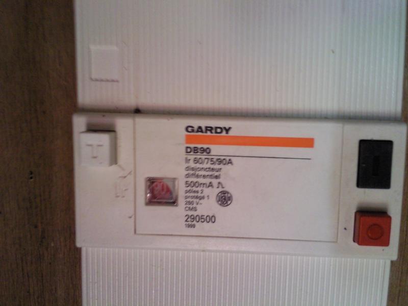

The RCD:
500mA rating.

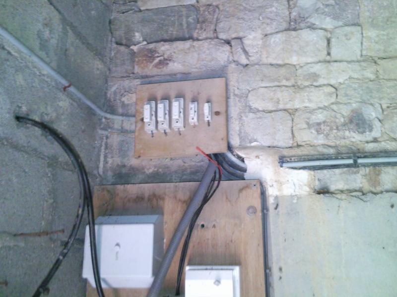

The fuse box above the mains:

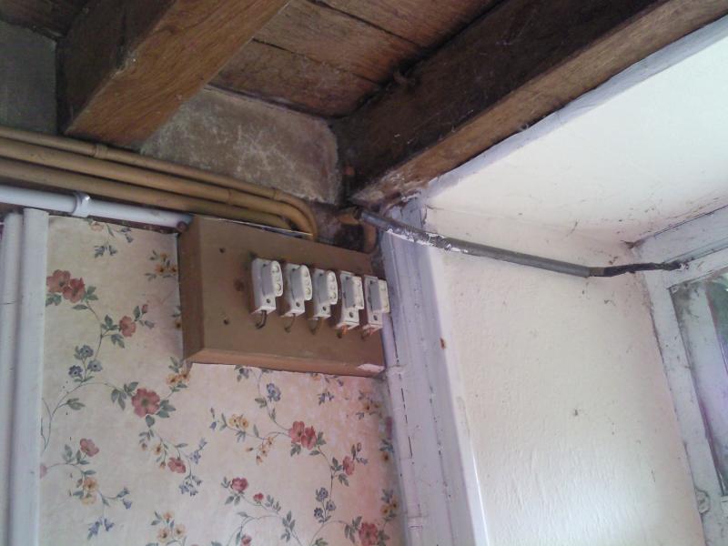

I am guessing that the three big fuses feed two other old fuse boxes in the house, as well as the large 200litre water heater that stands in the garage.
The fuse box upstairs:
Again, guessing, but it appears this fed the upstairs lighting and sockets in the old part of the house (as well as a wall light and downflow heater in the old bathroom, fed by a british 45A shower switch. hmmm nice)

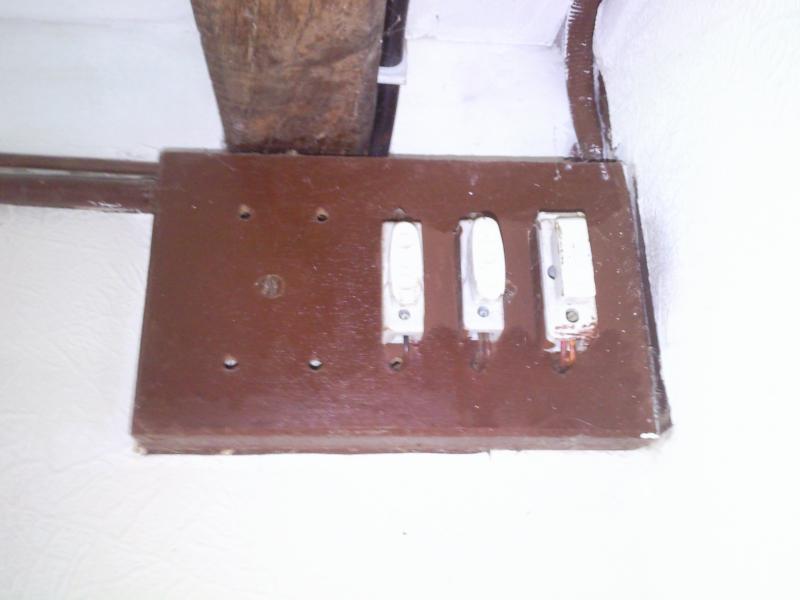

The downstairs fuse box:
This seems to feed the electric heaters, lights and sockets in the old part (though theres only two sockets in the living room, and one for the heater)
The conduits all appear to be plastic, so the wiring seems to be have been modernised. That stringy bit of wire to the right feeds an outdoor light.

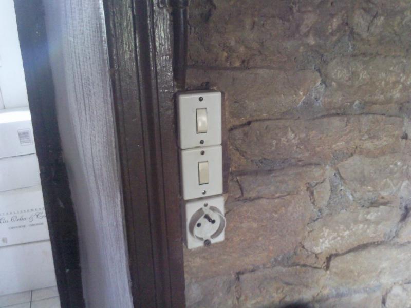

Light switches and sockets in the lounge:
All the lights in the lounge (3 sets) each had 2 switches since theres 3 entrances to the lounge.

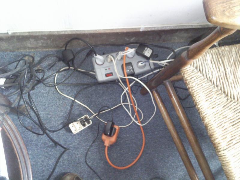

Remember I said theres only two sockets?
Nice eh? This lot feeds . . . everything. TV, DVD, router, sky, table lamp, IP phone device, cordless phone, that dodgy (but clever) english socket. Oh, and this is fed from another power strip under his PC!

What's the problem with the english socket? Seems a lot better than most travel adapters, anyway.
