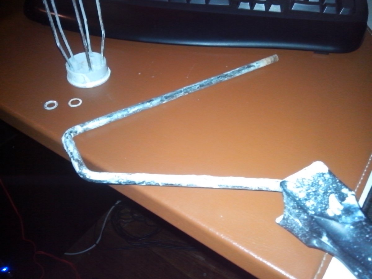

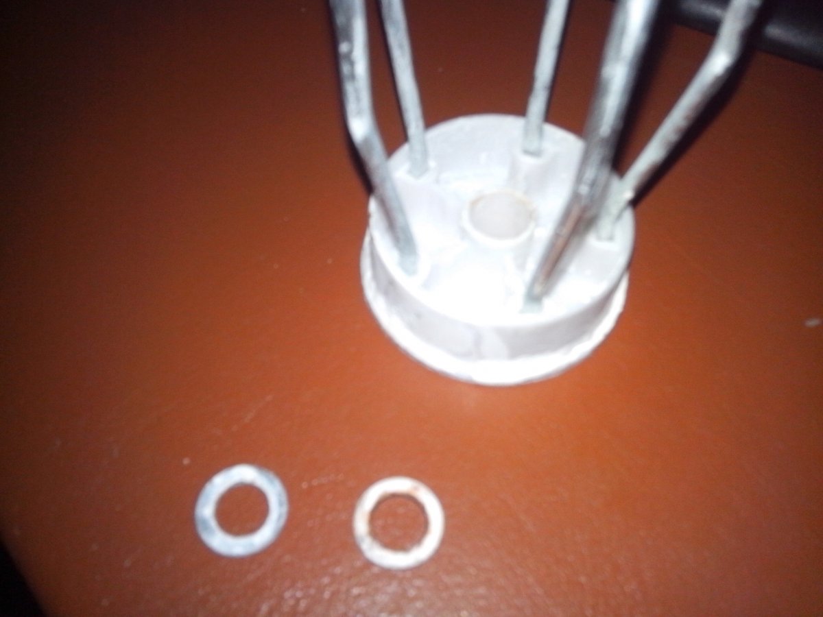

Don't see why I should throw this away just because the market dictates it's time for me to buy a new one. I'm not actually sure how it was constructed before but all I have at the moment is 2 washers.

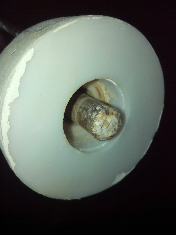

What I want to do is thread the tip of the shaft and use a nut on the end but the nut would come loose quickly so what would I use instead? A dome nut would likely come loose just as quickly if that's what your thinking.
Nothing wrong with the cage, or the handle, or the shaft, just the cage is loose.
No. Not throwing it away.

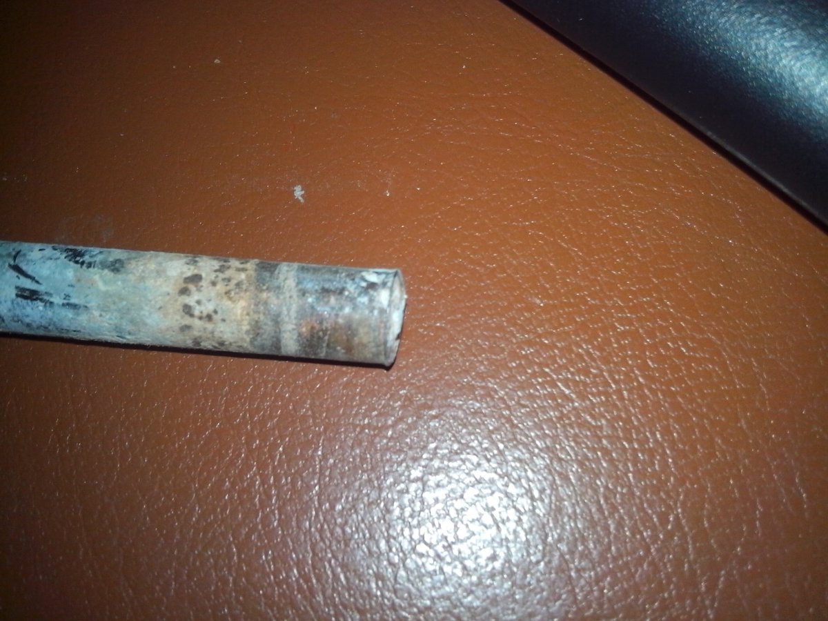

Do you have calipers to get an accurate measurement of the diameter? You can thread it with a die if it just happens to be the right size...
Or, could you file or dremel a very narrow groove all the way round and fit an E type circlip?
Or, drill a hole through it and fit an R clip...
You might need to make some kind of spacer to reach into the recess though, or just bung about 10 washers on there.
Fab mate thank you. It's 8mm but that's with a tape measure.
I'll investigate your suggestions ..
Might shell out on a tap & die set. I remember doing a tiny bit of threading in design technology back in school, just enough to remember how to do it.
File a chamfer on the shaft end, press the die on and turn clockwise.....once the die has gripped, back off a bit to remove the cut metal and then continue - give it a spray of duck oil or whatever to keep the die in good nick.
Half a turn clockwise, then quarter turn back.....trip down memory lane!

Loctite would do the job, As would two nuts tightened against each other if there's enough thread, but a nylon nut would be the chapest.
