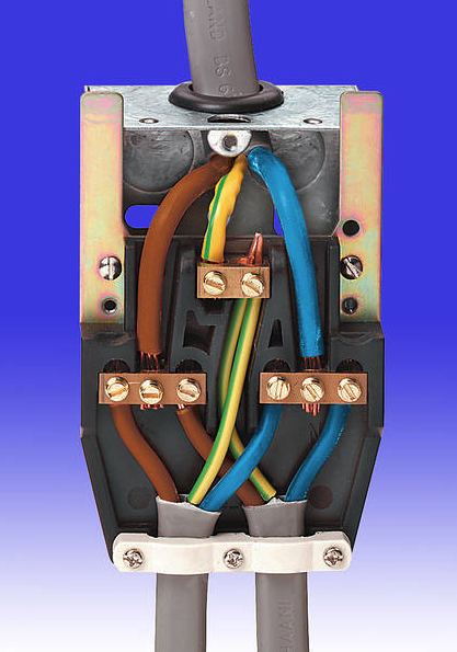

Myself and my wife have managed to come up with a three oven solution to a problem that never existed :-) She wanted two separate ovens, i wanted a warming draw, but could actually buy another oven for half the money, so went for that.
So we now have three ovens to connect, doing the maths, it's theoretically possible to wire these all back to the existing 6mm oven point. But is it physically possible/best practice. Oven details below.

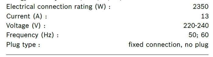

You can connect 15kW to a 32A, 6mm² circuit - possibly more.
2350W is around 10A; not 13 - so could be on a plug.
All three ovens are the same. So looks like our maths matches. Sweet.

As for physically possible, you will struggle to get 3 x 6mm² cables into the terminals of a cooker outlet plate, and possibly 2 x. Might be a good idea to put a dual one behind each oven so that you can daisy chain from one to the other and never need more than one cable per terminal.

No Sockets. Just need to find a triple appliance outlet plate and we're mustard! I know these don't exist unfortunately :-(
