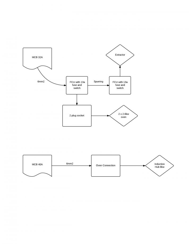

Ok say i use a cooker outlet instead of the dual socket, I assume i would require the dual cooker outlet as seen in post 2. I assume you cant connect 2 ovens to one connection unit...or can you?
Hmm ok went back to the house loaded with more knowledge from here. Turns out what I thought was a isolation switch is intact a fcu with a 13 amp fuse and switch. What he has done is taken the cable from the fcu that went to the old oven and attached a dual socket to it.
The diagrams show the intended setup for my appliance setup as it currently stands.
[/img]
Ah, that's a bit different from what we thought, and it casts some doubt on whether the electrician was being sensible. You now have 2 ovens, with a total potential load of about 19.2A running off the one 13A fuse in the FCU (the 'fuse and switch' you mention). Theoretically, that is just about OK, since if one applies 'diversity', one is allowed to consider a total cooking appliance load of 19.2A as representing only 12.76A (i.e. fractionally below 13A). However, particularly given that there will be a 13A fuse in the plug for each oven, that additional ('common') 13A fuse it totally unnecessary, and could possible result in problems (occasionally 'blowing'). If you're sticking with the plugs/sockets, the sensible thing would probably be to change that FCU to an (unfused) (probably 40A) switch or, if a switch is not required (i.e. if both socket switches were accessible), just an appropriate junction box.
