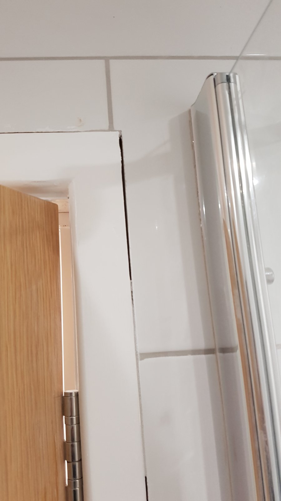

Tiling at edges of door architrave and ceiling

Hi, what should this gap be filled with, group, silicone, or caulk?
Normally grout but any movement in the frame will crack it and it will drop out. A good anti mould sealant will do it otherwise
