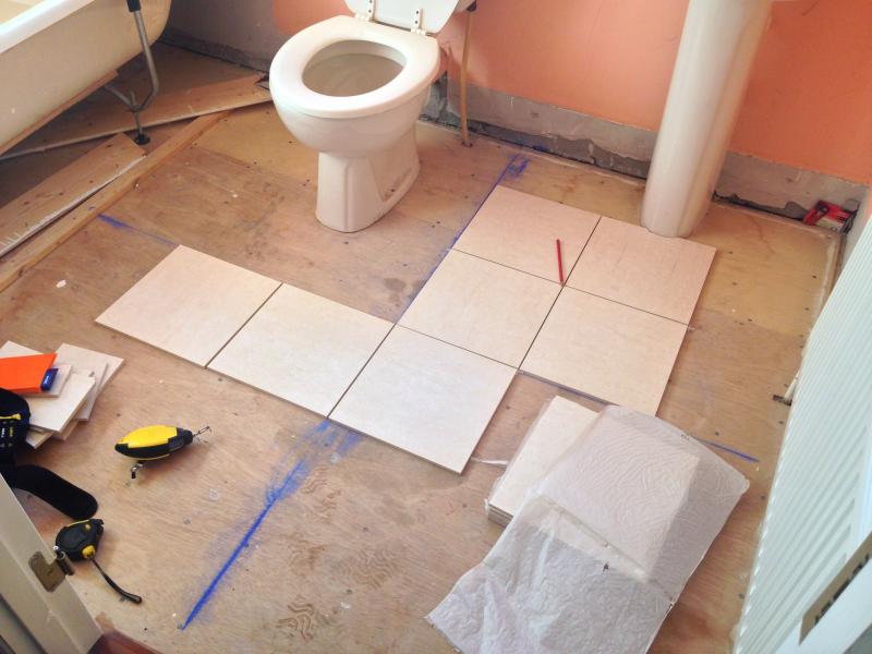

Hi all

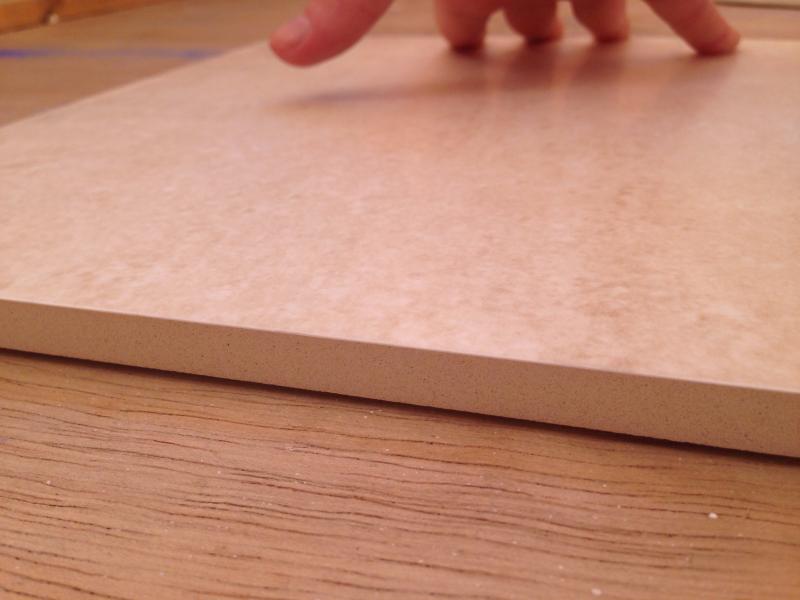

I'm doing some bathroom floor tiles for a family member. There was Lino fitted which I have removed to find plywood underneath. I have dry layed some tiles out on the plywood and have found that one tile rocks so clearly the ply isn't level in this area. Has anybody an idea of how to rectify this?
Where is the uneven patch - at a join of two ply boards or somewhere in the field of a board? Is there any water damage swelling to the ply?
Can you post a pic ?
There are actually a number of areas where this is happening. It is a relatively small gap though, what do you think?
Thanks for the pics but i cant see the actual ply surface or the join line between the two sheets of ply that seem to be on the floor.
If you removed all the tile and crayoned or felt penned on the ply the difficult patches it would help?
How secure is the ply - does it feel as tho its not tightly screwed down?
Putting your weight on the floor, does it feel as tho the joists are moving?
Is there an expansion gap at all the ply edges? If not, you can get "tenting" at the join line.
Sometimes its best to simply add more screws at the suspect areas but the problem with this is that you must know where any cables and pipes are running under the ply.
If all is secure with room to expand then using a 1/2" half round notch, & buttering the backs of the tile will take up any uneveness.
Thanks Ree. The ply appears to be quite solid. I will install some more screws to see if it will help. I will use a 10mm notched trowel also.
