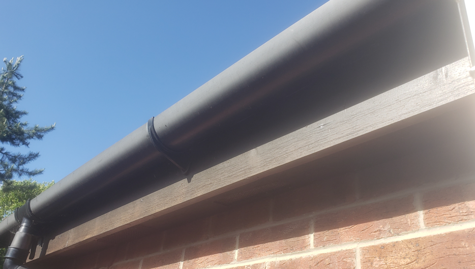

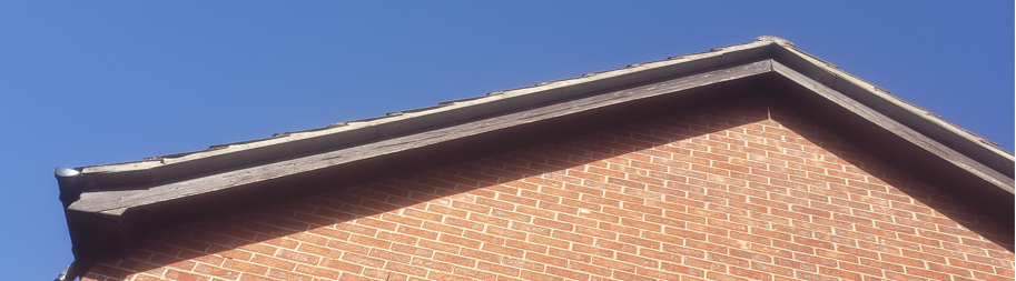

Some photos..
This barge board is in the worst condition of the lot:
Here's a bit of fascia that's still solid:
Cheers
Sadolin Superdec may well be the paint you want. Opaque, water-based, quick drying, no undercoat or primer needed.
You will need to sand the existing paint all over, but no problem with Superdec sticking to sanded oil-based or sanded water-based paint.
