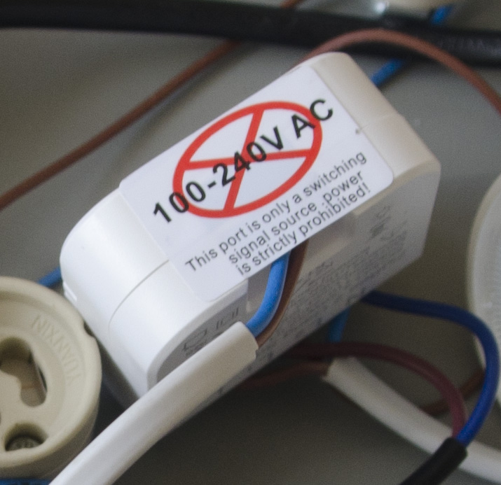

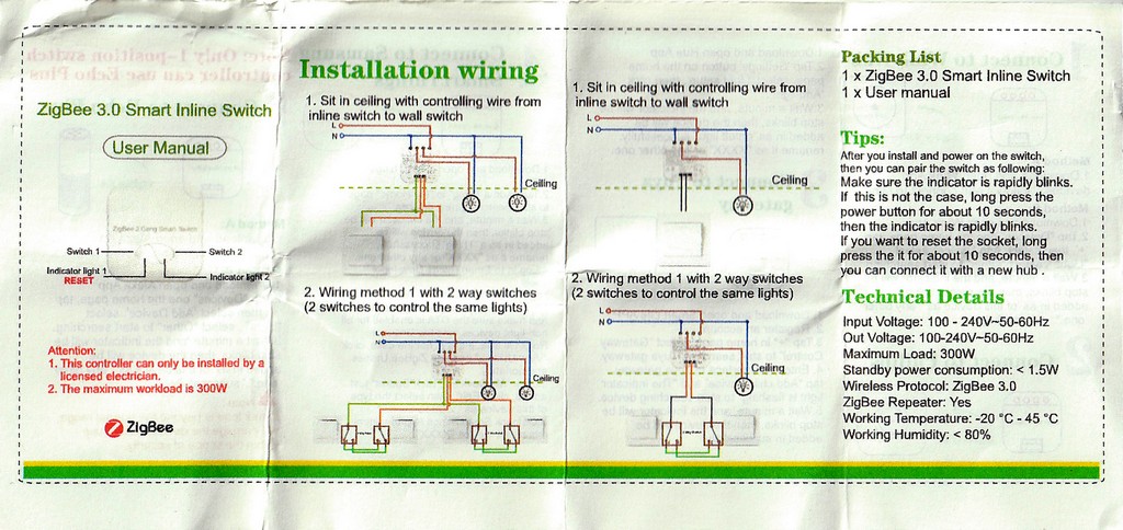

I think you can fit a smart relay. DSC_6062.jpg as yet not fitted, so can't check it time can be set, but it works like a two way switch with the hard wired switches which become extra low voltage.
Instructions here, Landing-light-relay-instructions2.jpg Landing-light-relay-instructions1.jpg if not this one likely some thing similar.
