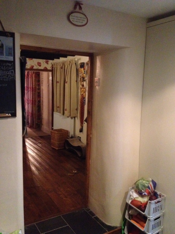

Photos of the lintel and all nearby electrics would be useful here.
Any curtain rails etc fitted?
Light switch under lintel on right and fridge and consumer unit to the RHS. Also underfloor heating )off) and lv roof lights.
