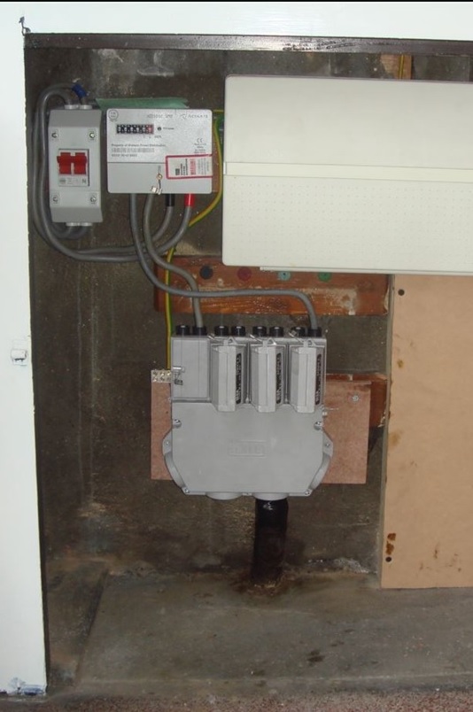

When we moved into our 1930s house 12 years ago we had a fair amount of electrical work done, including a new supply fuse, main switch and consumer unit. See picture. According to the certificate the set-up is TN-C-S, earthed on the 'distributor's facility' and you can see the earth wire running down to the block on the side of the supply fuse (which is 3-phase, as our house has a three phase incoming cable, although we only use a single phase). Outside in the flower bed is the old earth rod - a hangover, I vaguely remember the electrician telling me, from the previous installation - but back in 2010 it was not removed and the original thin cable runs from it runs into the CU, although you can't really see it in the picture as it runs behind the main switch and meter. The other day while gardening I noticed that it had become disconnected from the top of the earth rod which sits about 4inches above ground level. Not unduly worried, I simply reconnected it into the chunky screw clamp, but is it normal to retain a legacy earth rod on a TN-C-S system? Does it do anything given the 'certified' earth is on the supply head?
Ok.

W e l l - it could be useful in rare faults with the TN-C-S Neutral(earth).
Earth rods and other types are not 'legacy', they are vital parts of electrical infrastructure.
Historically most properties in the UK have not bothered with them, relying only on the supplier provided earth terminal. This is because until recently, installing one was not required or even suggested in most cases.
Earth electrodes are now recommended for TN installations, as stated in BS7671, 411.4.2
Most other countries have required earth electrodes for all installations for many decades.
In theory most supplies are PME, the ME stands for multiple earths and the DNO (supplier) was supposed to fit many earths, maybe not rods, but still multiple earths, however seems they got lazy, and renamed it TN-C-S and have not fitted as many earths as they use to, so the user has been advised to fit them instead, and with solar panels, and the possibility of running as an island, we need earth rods anyway.
However, when mine was fitted the guy fitting it showed me his meter, showing less than one ohm, I think that is extremely unlikely, so do not really want to trust it.
I would suggest you get some basic tests conducted by a competent spark with proper test kit
Yup, pretty much as Flameport has said.
Earth rods are generally a good idea and does not hurt to have one and could even prove vital in some instances.
Extremely unlikely to make a small impedance earth fault path.
Two things that have made their use more vital.
1/ Suppliers are allowed to use one conductor for both N & E theses days, including parts of "TNS" supplies therefore making it very TNC-S like to nearby supplies.
2/ Getting rid of metal gas and water pipes in the supply infrastructure - in years gone by they used to act as if a massive earth earth rod/mat type system - no longer these days, fortuitous yes but very effective in many cases.
So, having an earth rod or three is usually a good idea if firmly bolted to the Main Earth Terminal or thereabouts.
