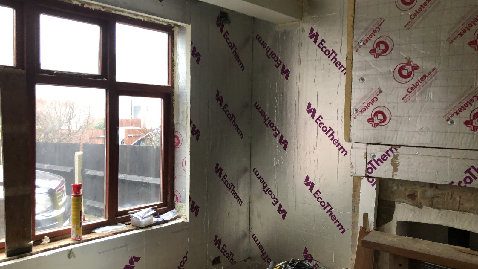

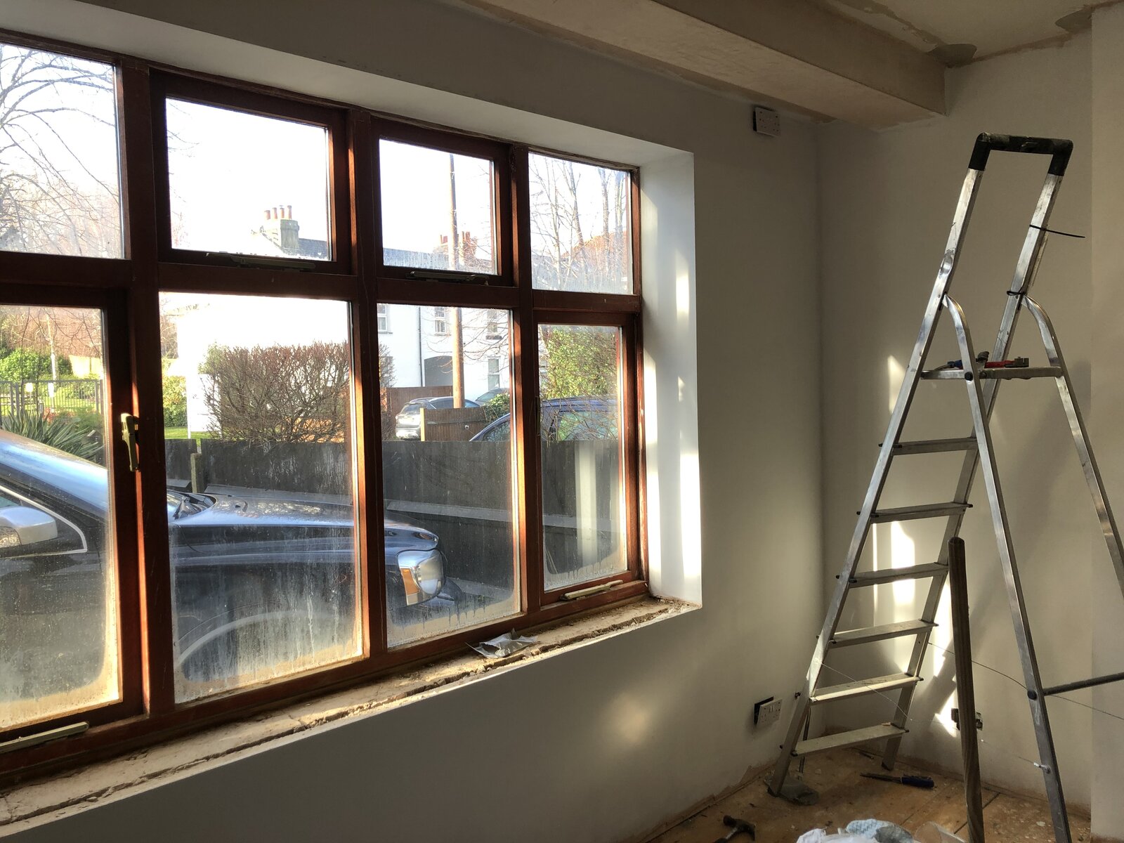

I just redecorated a room with 9” brick and stripped back to brick adding 50mm of celotex and plasterboard. Huge difference. U value of over 2, to less than around 0.5.
you do have to make sure you foam up all the gaps to stop condensation

807E8CB5-56CE-4D92-93CF-8E6E011519CB.jpeg 97A017D1-2C41-4466-AEFA-FF013719CBF2.jpeg
The only thing I had to do is splice an expansion batten in to the window board as the walls are now thicker. I used foam plaster adhesive
