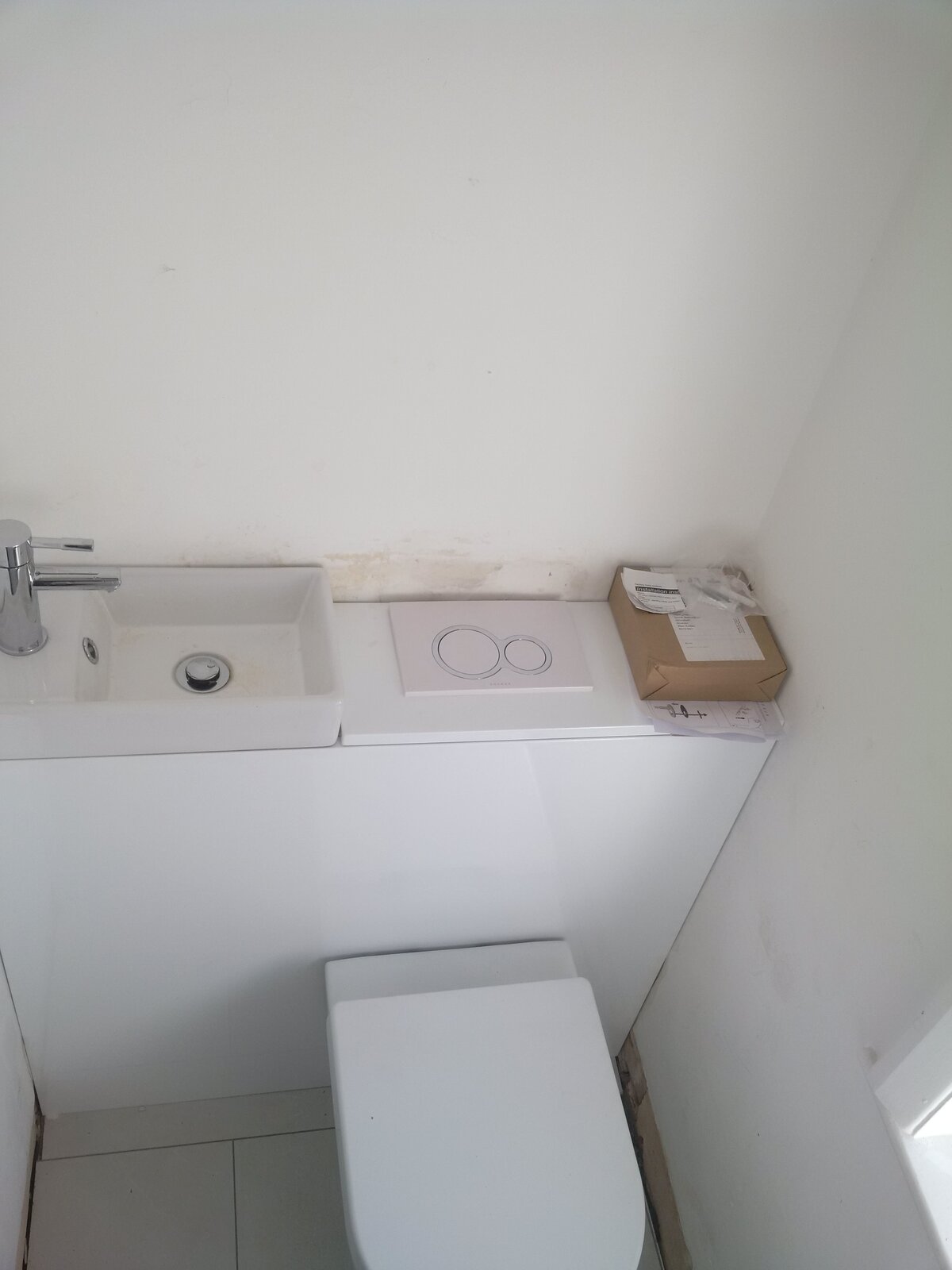

Would this toilet be suitable for fitting in my cloakroom? Would the fact the soil stack is to the left be a problem? I assume I would need to cut an entry on the side of the back to wall unit?

i had a very similar setup in my ensuite and the range of furniture included options for side access for the soil pipe.
And I also had a width where the unit fitted next to the soil pipe, and then i boxed in
I also fitted a small basin to the side , so had some worktop space with window sill.
So not the same unit as your BTW with a basin included on top
will you have hotwater available

I think these toilet sink combo units only have a cold supply.

oh OK, not sure of the specific version you are getting, but the ones i looked at for our cloakroom and ensuite had a mixer tap , but we decided to change the shower door and fit a separate basin rather than lean over the toilet, so ended up not looking really that close to the spec

Our space is quite restricted so we don't have a lot of choice, having seperates won't work

It's amazing what you can fit in a small space. This is one I installed for a customer in a 900mm wide room.
That looks great! I did look at those, but our space is less that 900mm!
When you install these, would you say where my soil stack is, is an issue? Presume I just cut a hole in the side of the unit, then box in the soil pipe and hole and maybe tile.
