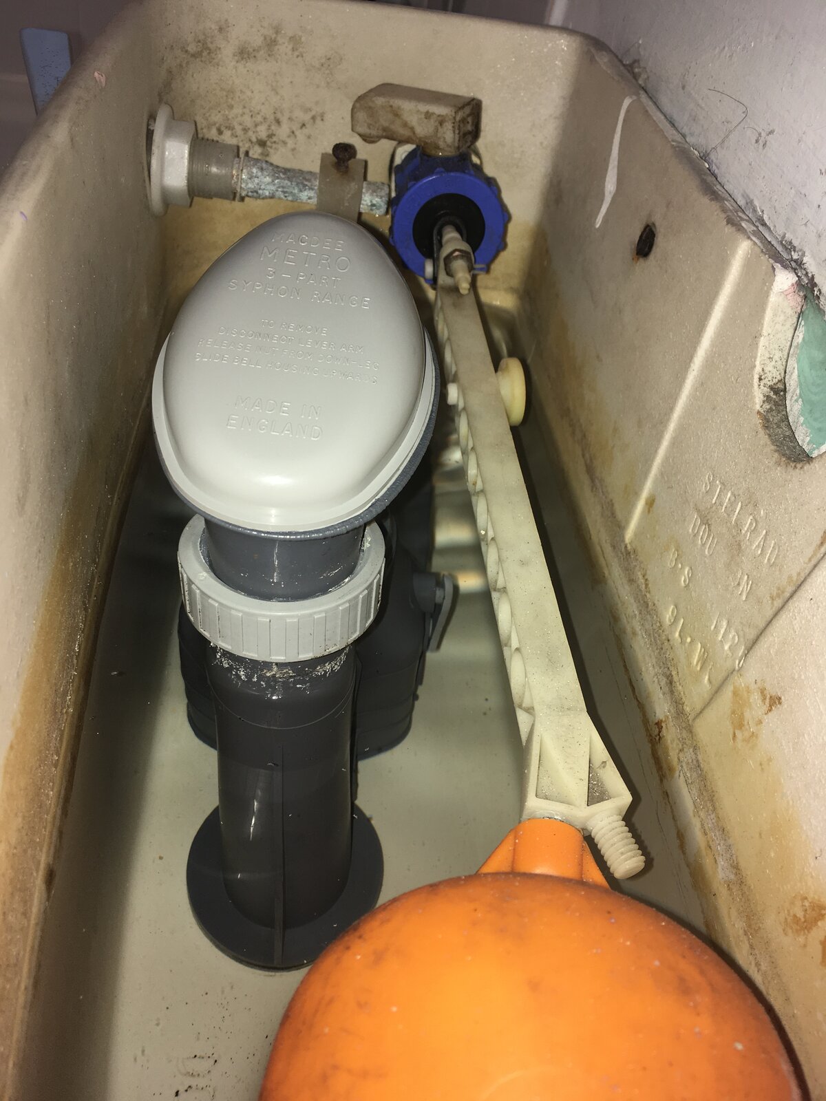

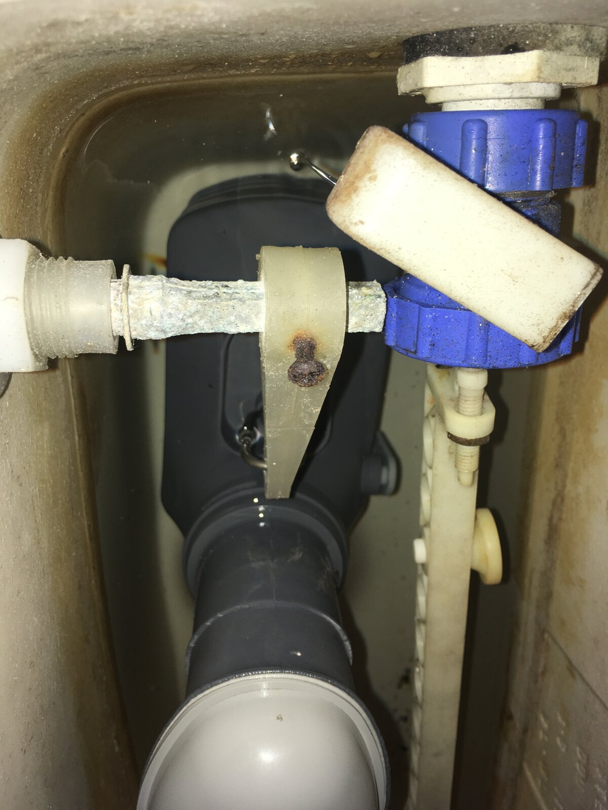

Long awaited photos.....
Sorry for delay uploading photos, had to deal with health issue concerning my elderly Father, so toilet flushing was the least of my concern.
Also, I tried holding lever down for a long flush but it just flushes the once and does nothing until I release lever and flush again.

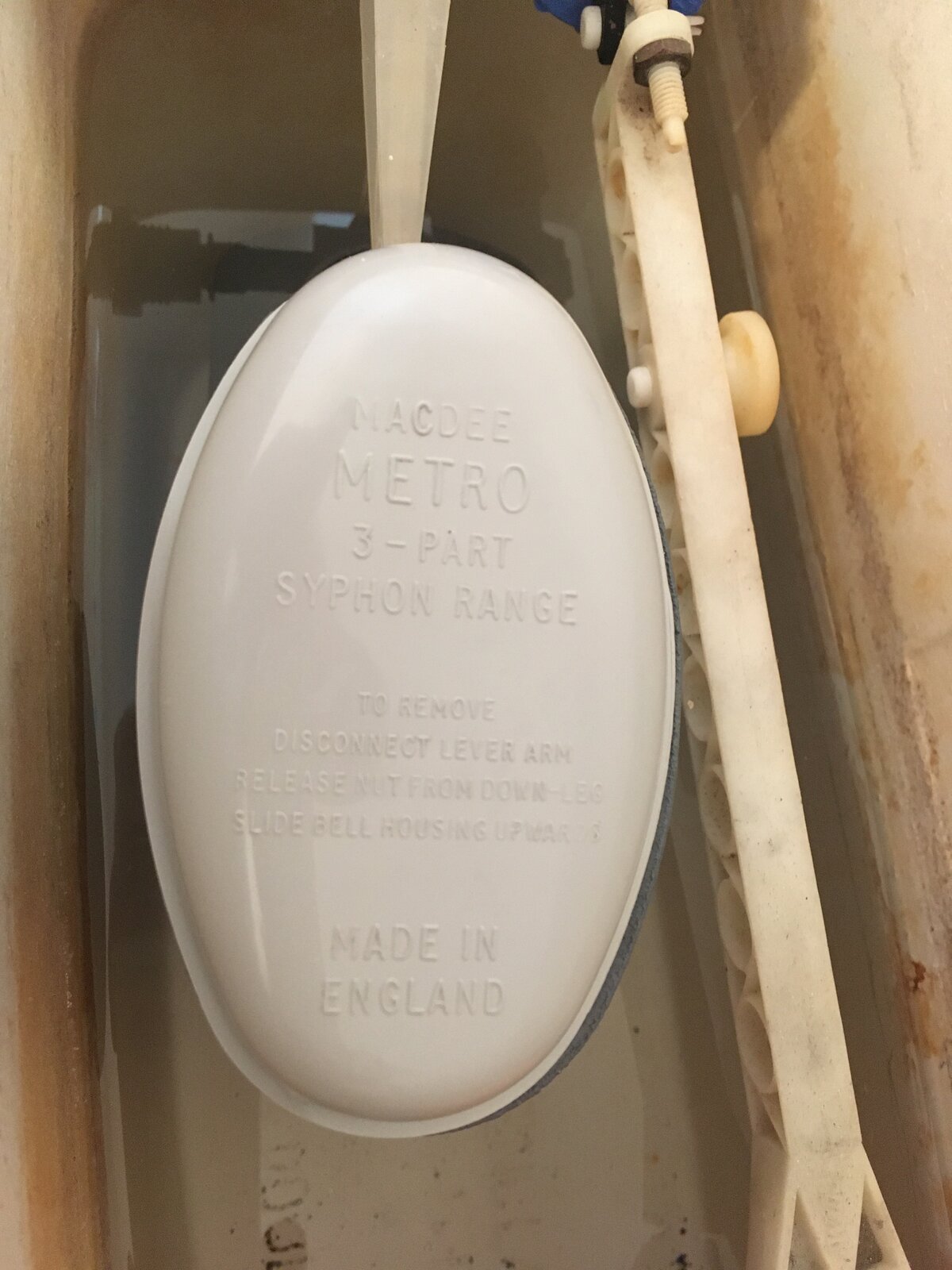

The Syphon states: MACDEE METRO 3-PART SYPHON RANGE
330F4596-2D5C-4B7B-93B5-B9B4C988F312.jpeg 5F554ED8-DC64-477F-BFD1-A6CA5954835A.jpeg
I’m not into cisterns like most on this thread:D but it looks like it could do with a bit more water in there for a start.
You can alter this with a flat blade screwdriver on the end of the White plastic spindle that is coming out of the blue plastic nut. This will allow more water into the cistern which will allow a better flush. (Think you turn anti clockwise)
Will it be enough? Who knows, but it’s a free start.
The grey adjustable flush volume (small piece facing the rear of cistern) isn’t in properly, not sure if this is affecting it.
Thanks, it was still filling when I captured photos and will fill up to the water mark of the cistern.
It’s at the level set by the plumber, it also appears to be an historic water level.
Do you means I should adjust it so it fills above the current/historic water level ?
Yeah, I noticed that when taking photos and although it feels loose, that’s as far as it will go in without forcing it.
Since the syphon is splittable, remove the syphon, push the volume limiter back in and reattach the syphon, give it a flush and see if there’s a difference.
Take the syphon out and see if it set to maximum flush. The grey 'volume limiter could be set to only flush 6 litres'.
Once you have taken it out, lay it on its side and post a picture.
