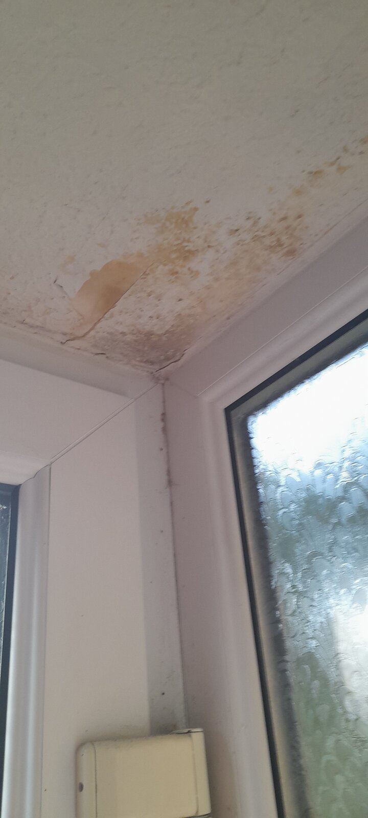

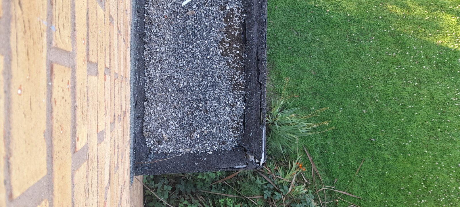

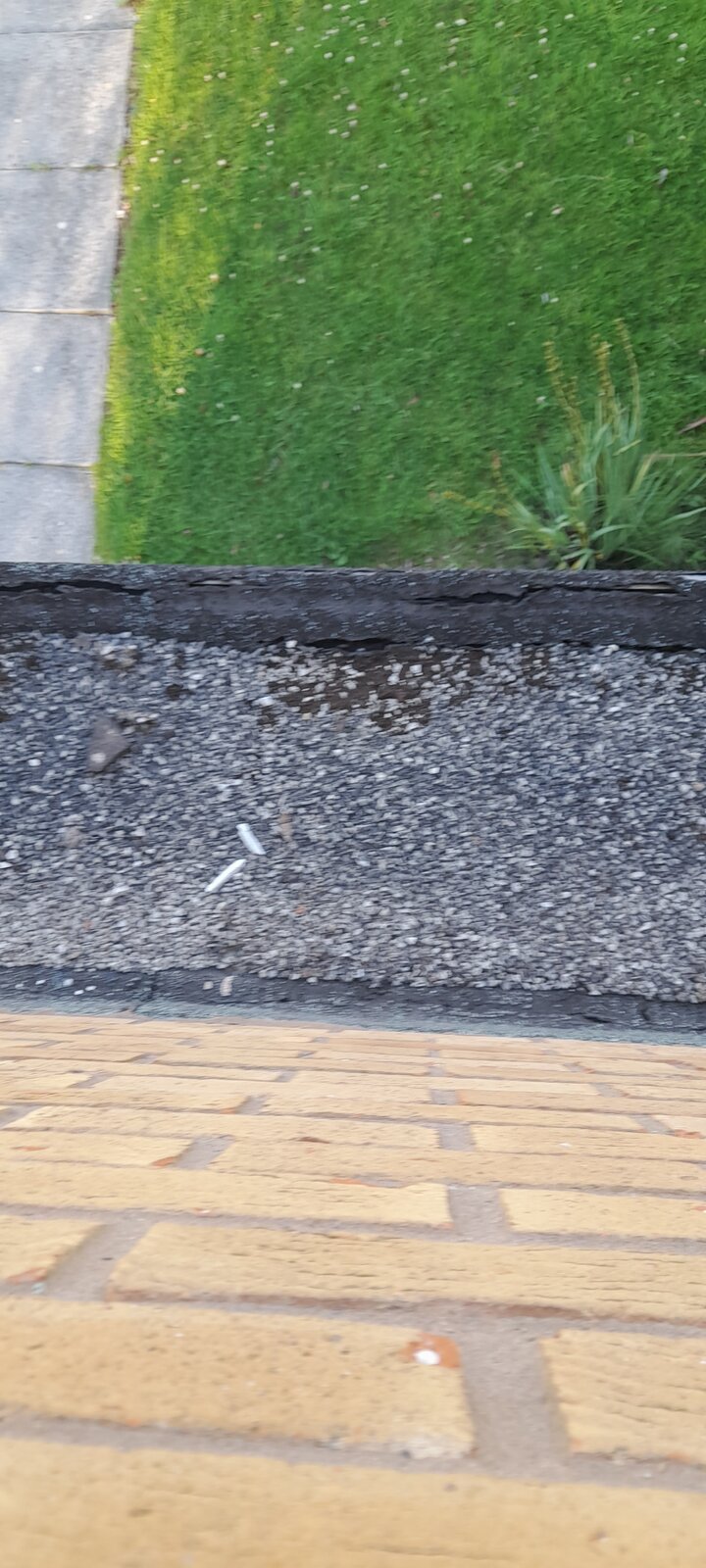

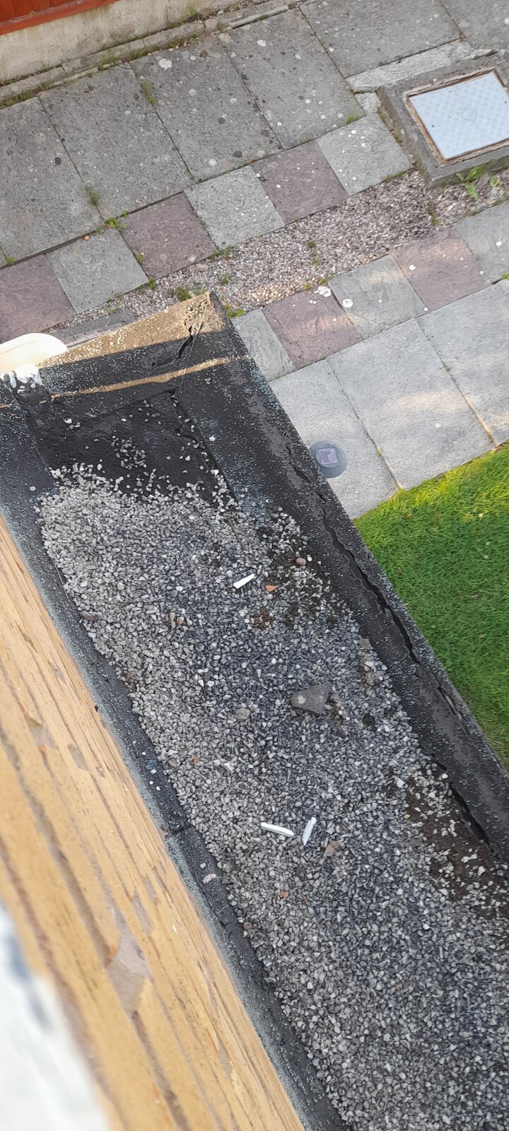

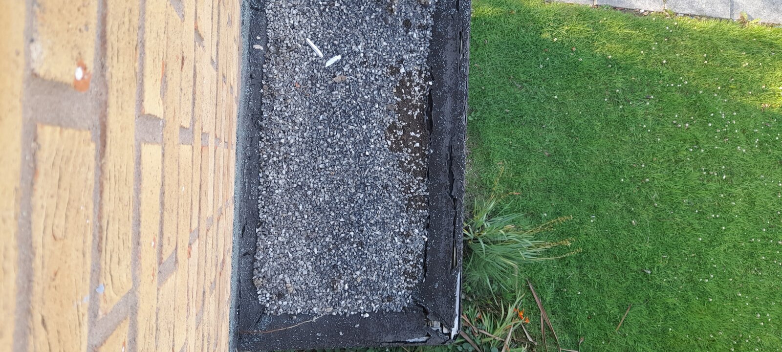

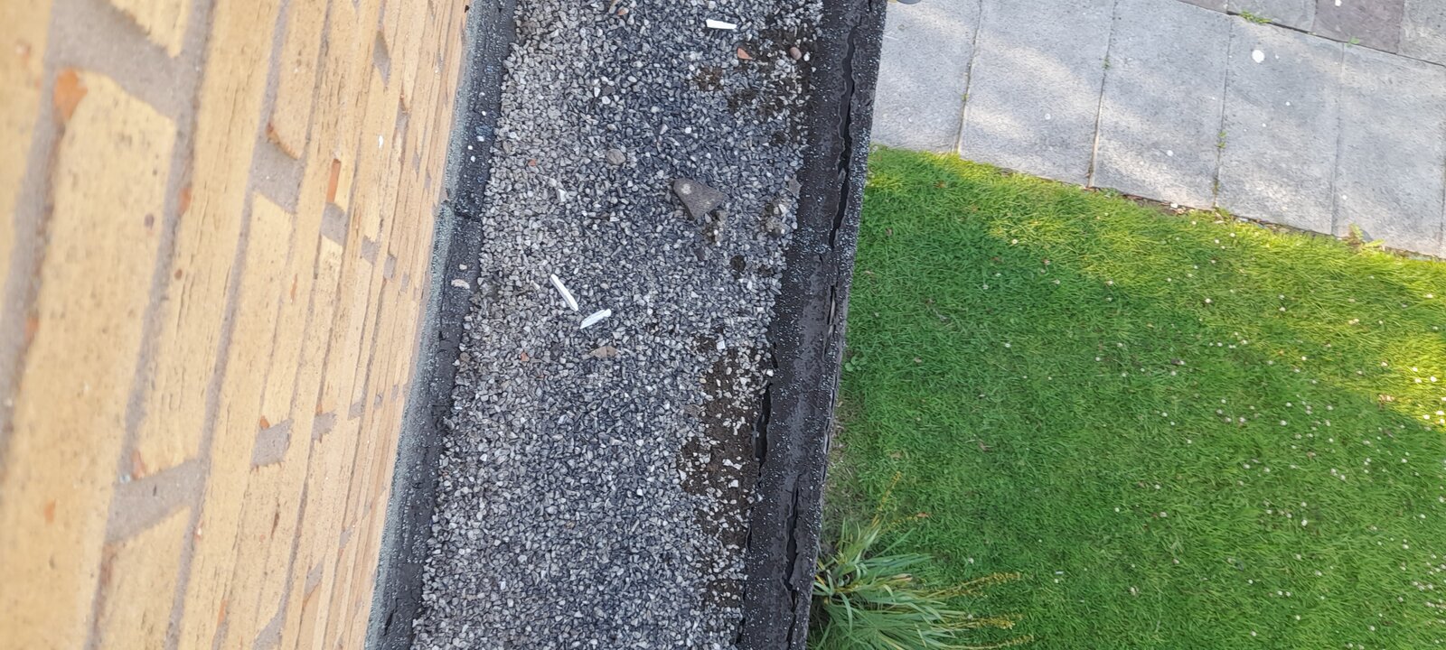

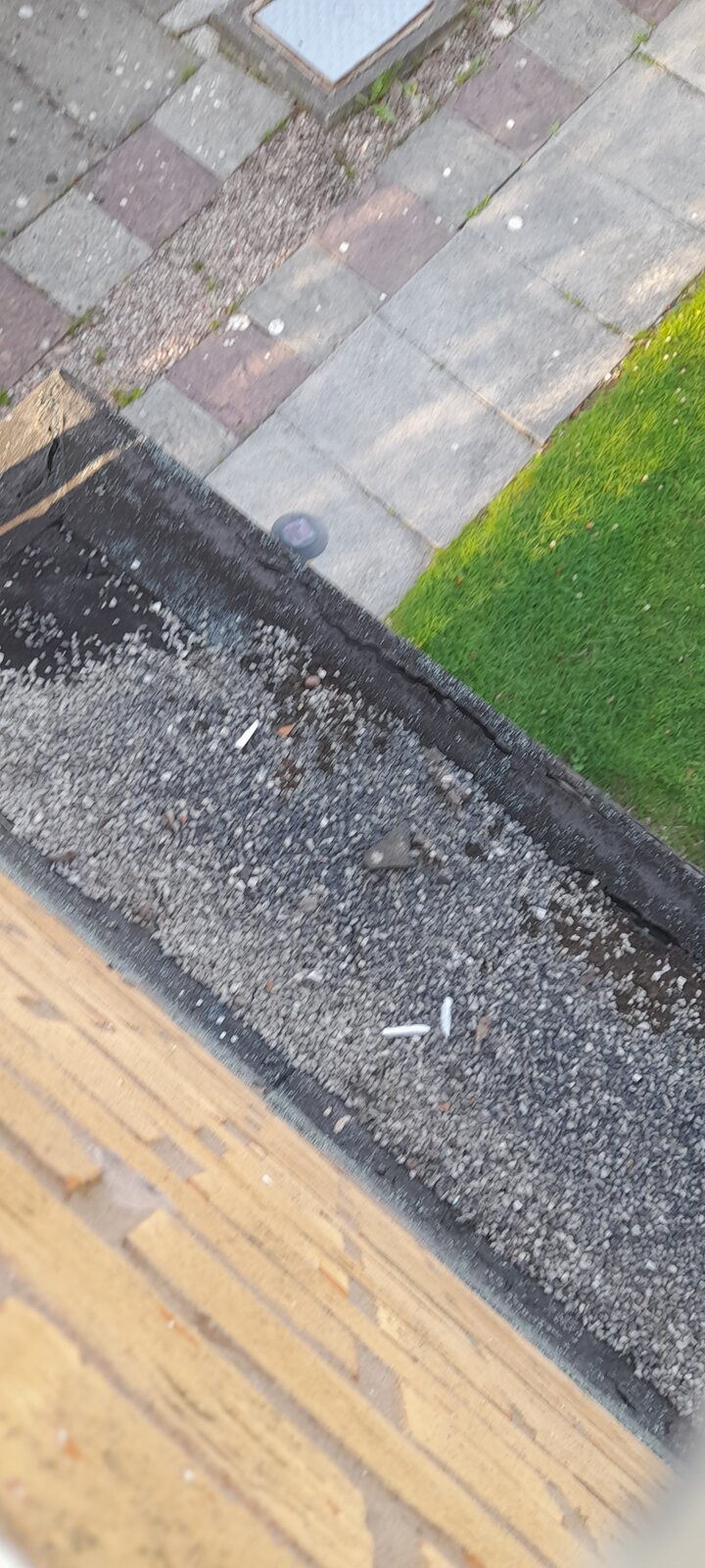

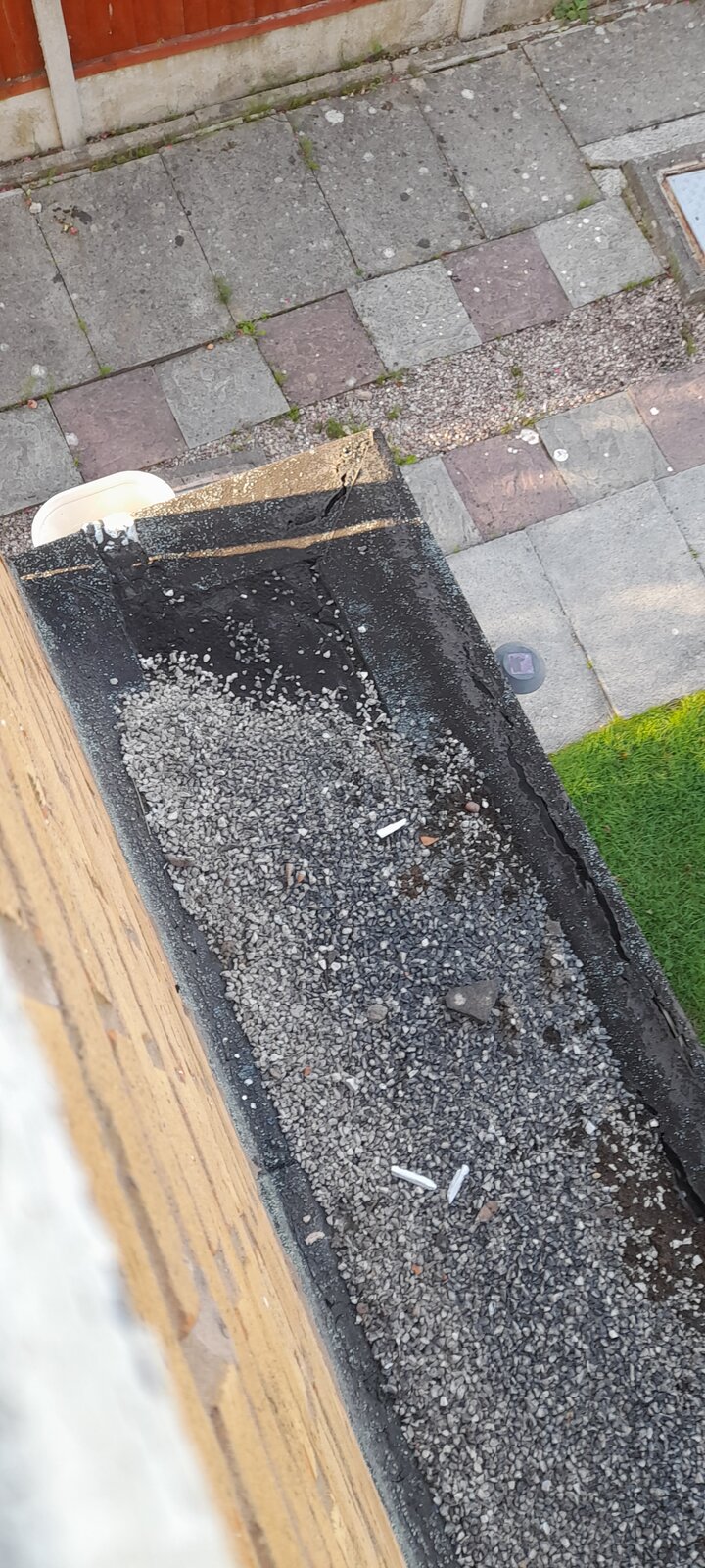

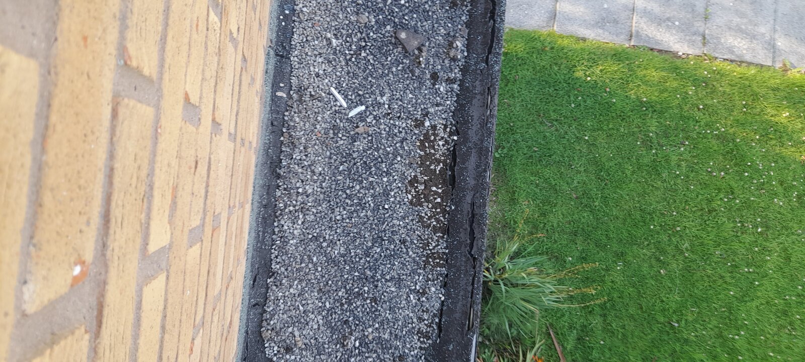

Any advice on sealing/mending the cracks in this front-door porch?
Photos of top of porch from from bathroom window.

Felt needs renewing. Some timber beneath may be rotten.
Acrylpol and mesh painted on will only get a few more years.
Ok, so how about a covering over the felt (after it's been sealed) , thin copper sheets bent to make the rain spill off, something like that?
No, that's unnecessary Heath Robinson.
Covering with a mesh and flexible compound such as Acrylpol will be enough, but the felt is at life end, and if you cover the defective bit now the adjacent bit of felt rots next.
The thing is , as you can see there are definite deep gaps in the felt and structure, shouldn't I fill those gaps (where you can even see down to the woodwork) with material like stones before I cover over with scrim and Acrypol?

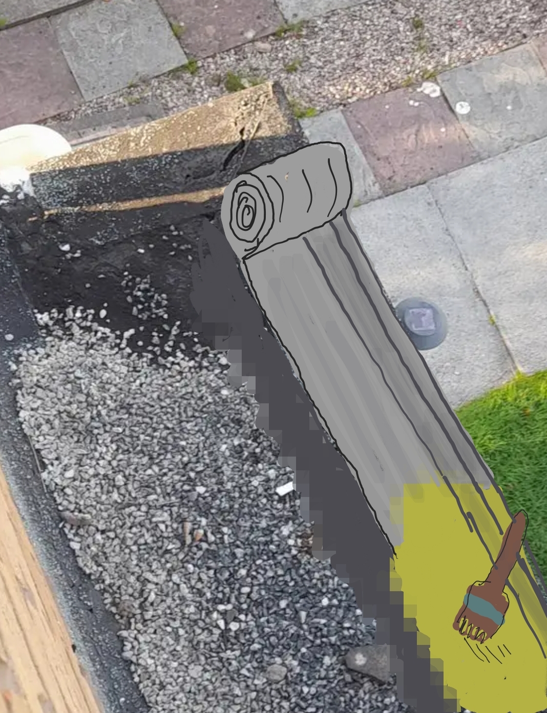

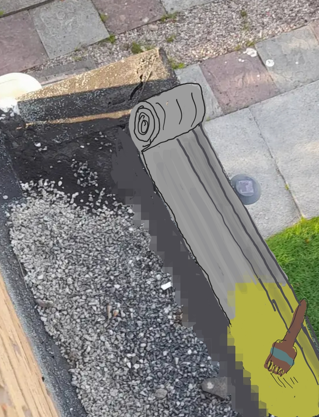

Thanks, that adhesive flashband can you see it sticking on that surface?
If I do first layer acrypol will it gel before it seeps through ceiling? Will it even seep through the ceiling? If not then sorted, can just smooth it out with Acrypol then put flashband on but like I say these adhesive tapes like flashband look too good to be true. How would you flatten the flashband?
Flashband, or similar self adhesive product will stick.
Or use the Acrylpol as an adhesive.
If you can wait for a few hot sunny days the flashband etc is much easier to use. A hair dryer or hot air gun can also be useful to get the flashband goo to flow a bit.
