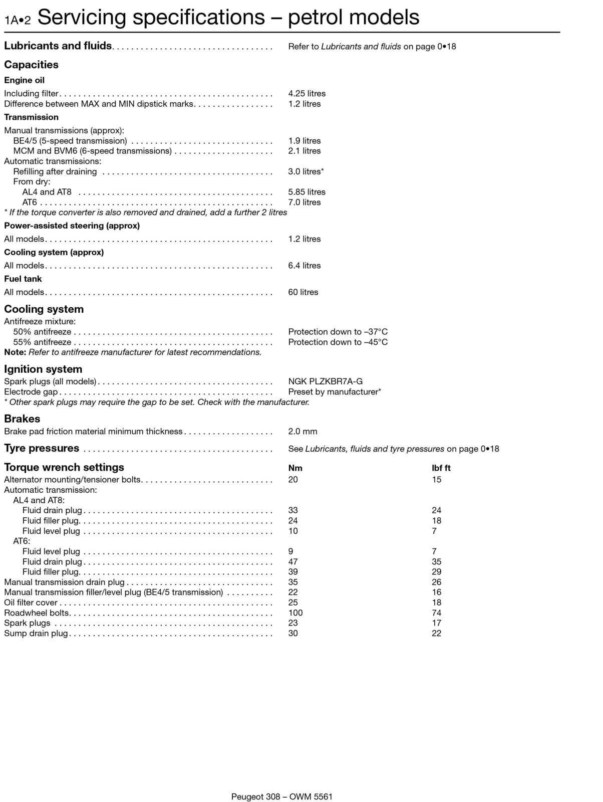

If all else fails....
https://haynes.com/en-gb/peugeot/308/2007-2012
damn...
this free sample page doesn't have it!

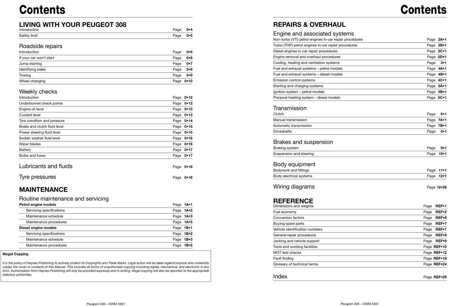

Halfords stock Haynes manuals, my local has these in stock, it might be inappropriate for someone to enter a branch of said shop, remove the thin cellophane wrapping on a Haynes manual and have a browse through its contents.
public library often has them
no charge to read or borrow.
