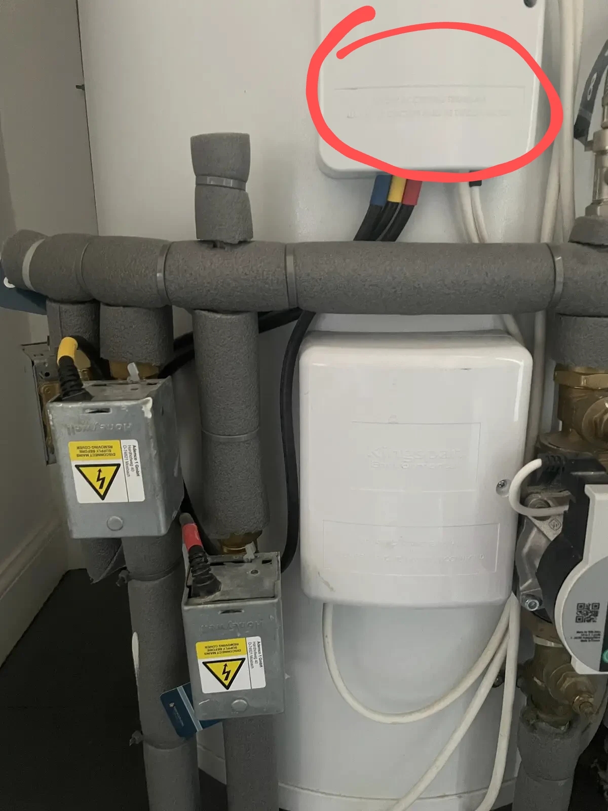

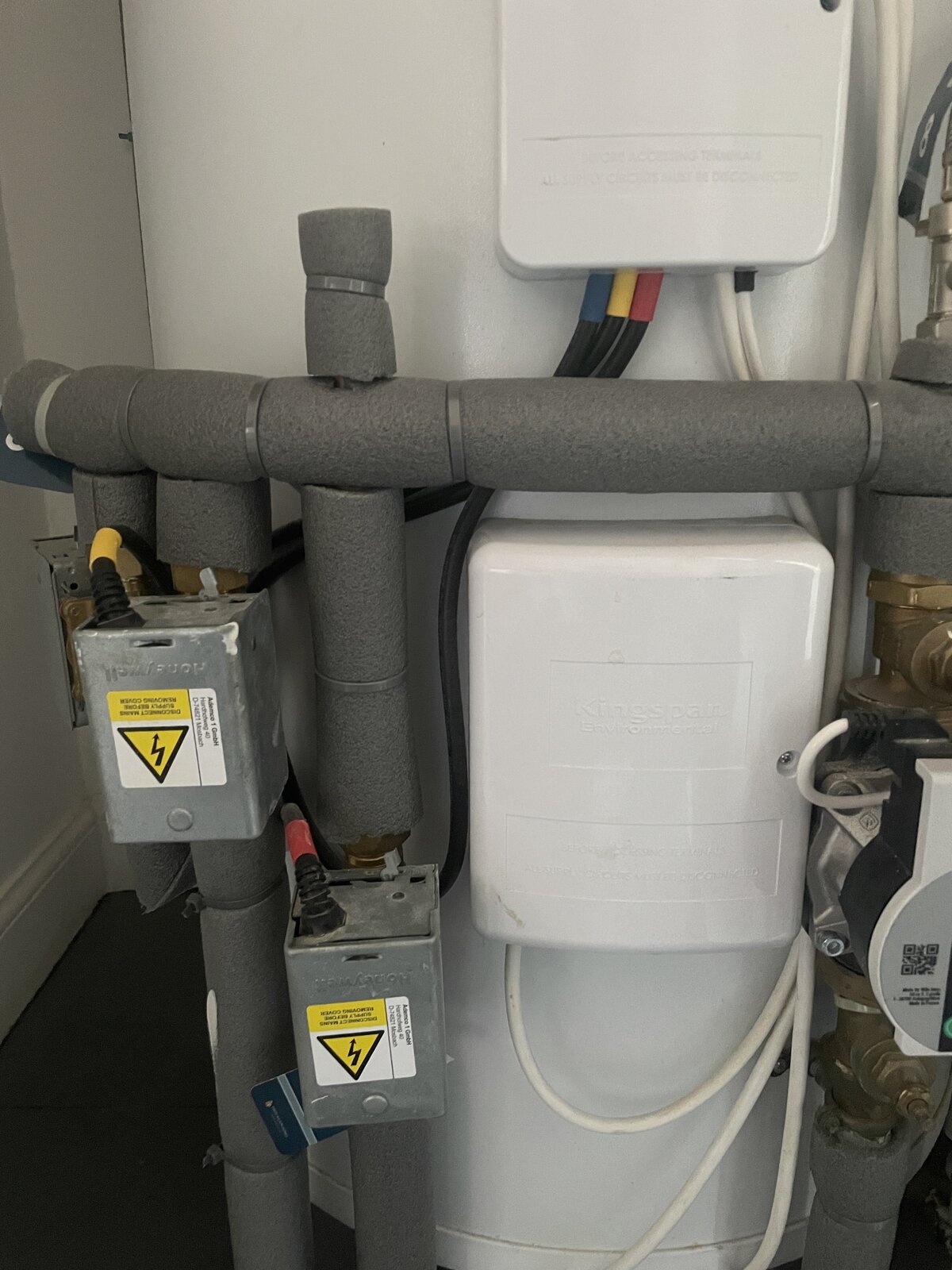

Have a look in here (circled red), if you have any test gear, create your demand for the tpone b and check the brown in with a known earth or neutral, should get 240vac. If you get the voltage then suspect the actuator/motor. I won't know which is which by layout
