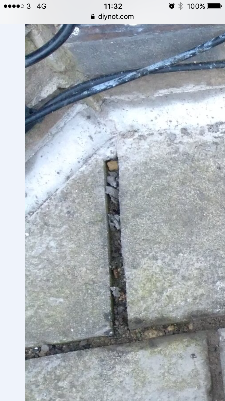

I think you guys are right that the water is finding it's way down a hill/driveway at the side of the house and entering into a gap within the footing stones at the lower end of the property. The landscape at the rear of my house is higher, so it's possible it's coming down from there...How can I be sure?
One option I was thinking of is to dig down outside where the water is entering from and somehow seal it with concrete or some tanking membrane???

You've got gravel in the French drain, but the dust and dirt gets in, fills the gaps, and water tracks across, so this'll need changing for at least 1" stones. If you dig down and try and tank the area, you'd need to go round the sides as well, but if you dig a trench and install a land drain, then the water gets taken away properly, even if only to a soakaway.

I think trying to seal anything would be a losing battle. Tanking is very difficult to get right even from a fresh start. The water is just going to take another route.
The best solution is to collect it before it gets to the place where it is coming through, and lead it elsewhere to drain away harmlessly.
Any reason you can't dye test the paving etc?

John - I forgot to mention in my previous post that I did a red dye test last night on the patio in the rear garden and then spent a long time hosing down with lots of water. Not a drop so far. Also surely if I've dug an inspection hole on the inside of the cellar and that's totally dry, then doesn't that mean there is little or no water coming down the side and that the water entering is maybe further down? It's either that or I simply need to waterproof/block the gap which is letting the water in. Your right that the water will simply disperse elsewhere...but if I apply some form of a membrane from the point of leak to the bottom corner of the house, then the only next location the water can go is down the driveway or maybe a connection to the sewage pipe to drain it...or am I wrong?

The land drain will take the water away. You seem fairly hand Ripper, so I would expect you to be able to do this yourself. You were talking about digging a trench and putting a membrane in, but that's not far off of a land drain. You dig a trench about a foot or 18 " wide about 4 or 500mm deep, and line the bottom with permeable membrane. You put in a thin layer of gravel, and then lay in the permeable drain, and run the drain round to an exit point, (either a soakaway, or a surface drain) and then fill the trench with more gravel, and then put the earth back in.
