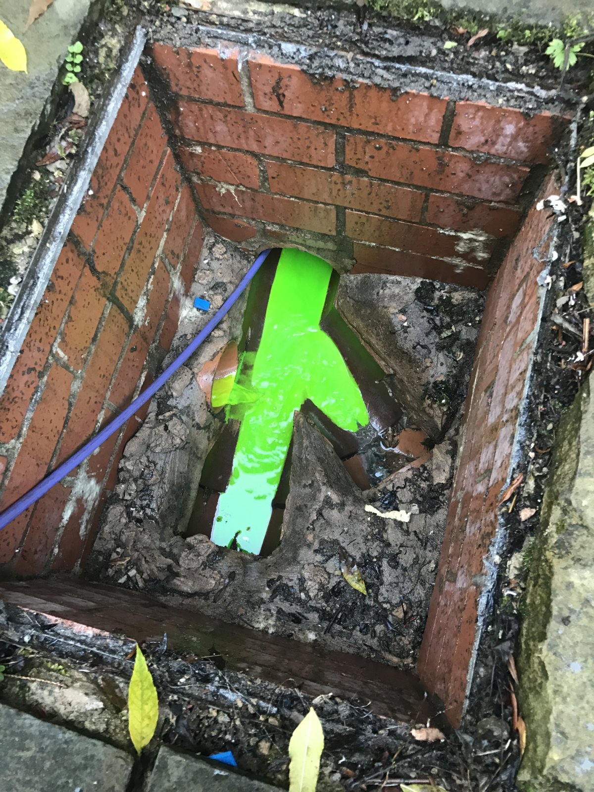

As promised, I've had the water company guys out. The disappointing thing is that this guy was very difficult to deal with. He's ended up putting a green dye in one gulley and yellow in the second one.
Now have a look at the picture belong. The issue is that I can't tell if this is yellow or green....can you???
View media item 100438
Pretty sure that's yellow. Green is green, believe me. :LOL:
Don't know, that could be much greener today. Yellow is the worst and too close to green. Although it was good of them to investigate your private section he should really of used green and blue.

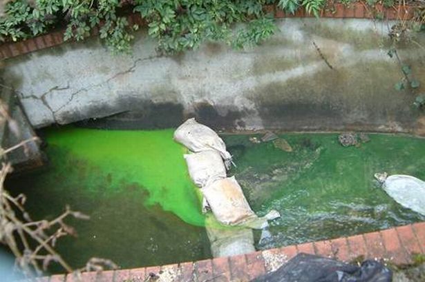

That bright green or blue certainly haven't shown and even the hint of yellow has now disappeared by morning. What is even more baffling is that if it's that colour we see in the photo is a yellow dye, then how has it travelled UPHILL into the side of the house???? :-

Buy some of your own dye and dye one gully every day for a week then move onto the next gully with a different colour. May take time but at least you will know for sure where to start digging.
Andy
That is the plan Andy, but whilst they are still doing their tests, I feel it's best to wait until these are complete.
Hi guys,
Just an update that the water co. may have possibly found the gully as the green dye is now clearly showing in the basement. Being honest this guy who came down was a proper $%!@ and gave me a real hard time and stress - He seemed to have some sort of a grudge or problem with the previous guys who had already been out and he took out his frustration on me. I also think he further damaged the u-bend because he couldn't get the cctv around it and kept on smacking it. I did ask him to calm down, but he said if it's broken, then what difference does it make if it breaks a little further. I couldn't believe the cheek, but I kept quiet just to avoid a serious confrontation.
Anyway, he's requested further tests and also asked the department to look into who owns that gully because he wasn't a 100% sure. This gully and pipework runs straight across my garden, so it would be a very big job to dig that out.
If I am responsible and need to do the repairs myself, how will I work out if it's the square hopper or the storm/sewer pipe itself?
If it turns out to sewer pipe, would I need to dig a trench along the garden or is there an easier way?
