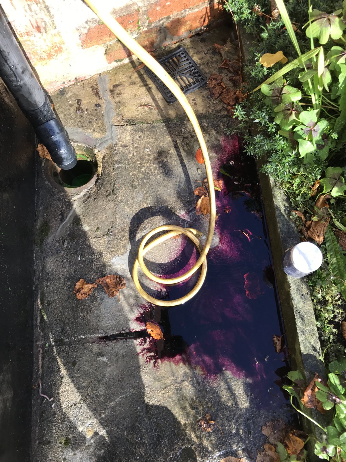

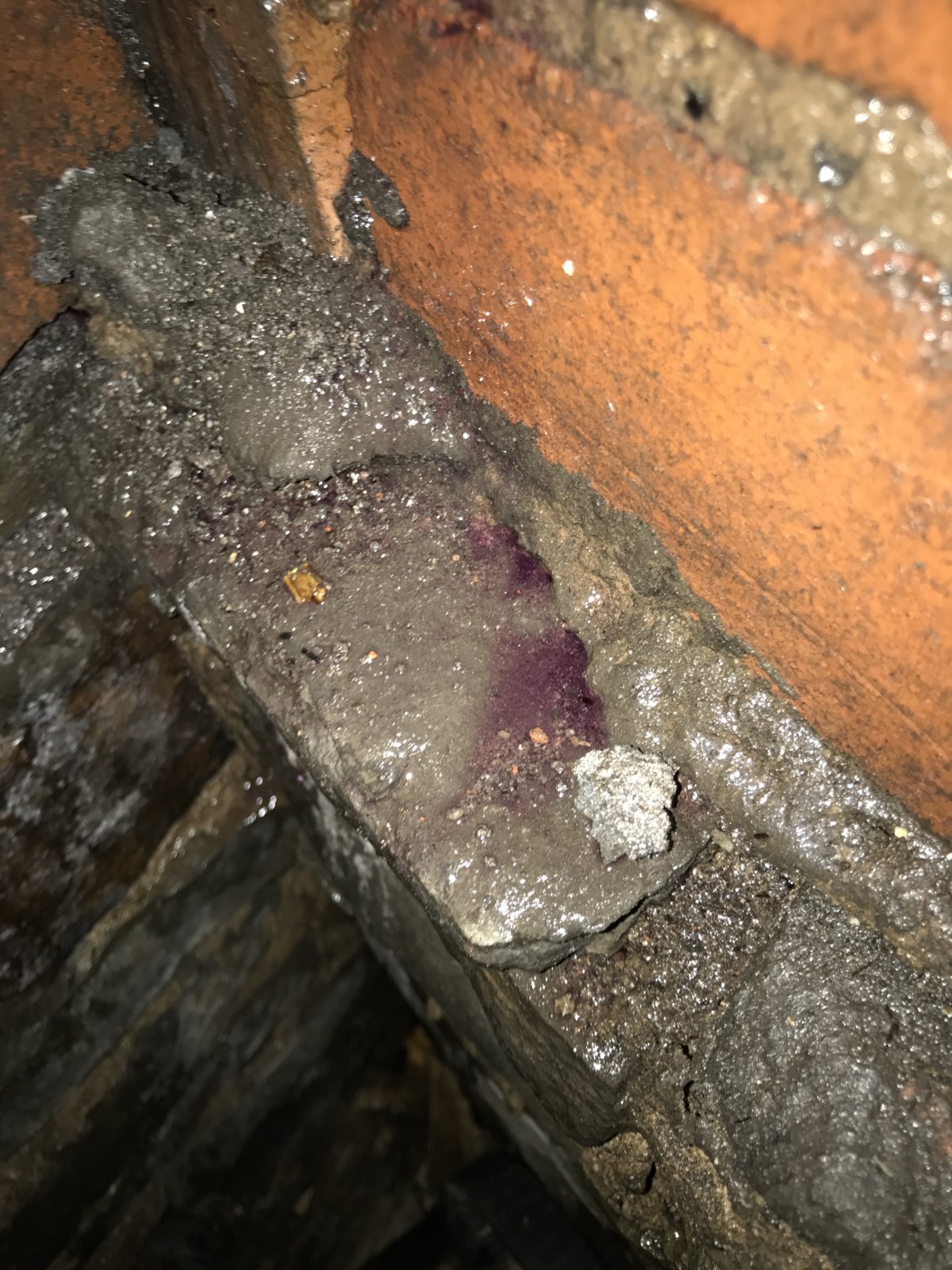

They might just be leaking a tiny bit so if you use them much more than normal the water might show. So flush your toilet 10 times, leave your kitchen sink running and put a hose up your rainwater downpipe so the water flows back down it (rather than putting the hose straight into the gully). Test the surface too, this had green in the gully and purple on the floor, second pic is the subfloor after 5 minutes:
If you get water through you can repeat the test with a different colour of drain dye in each gully.
If you don't get water through then look elsewhere.

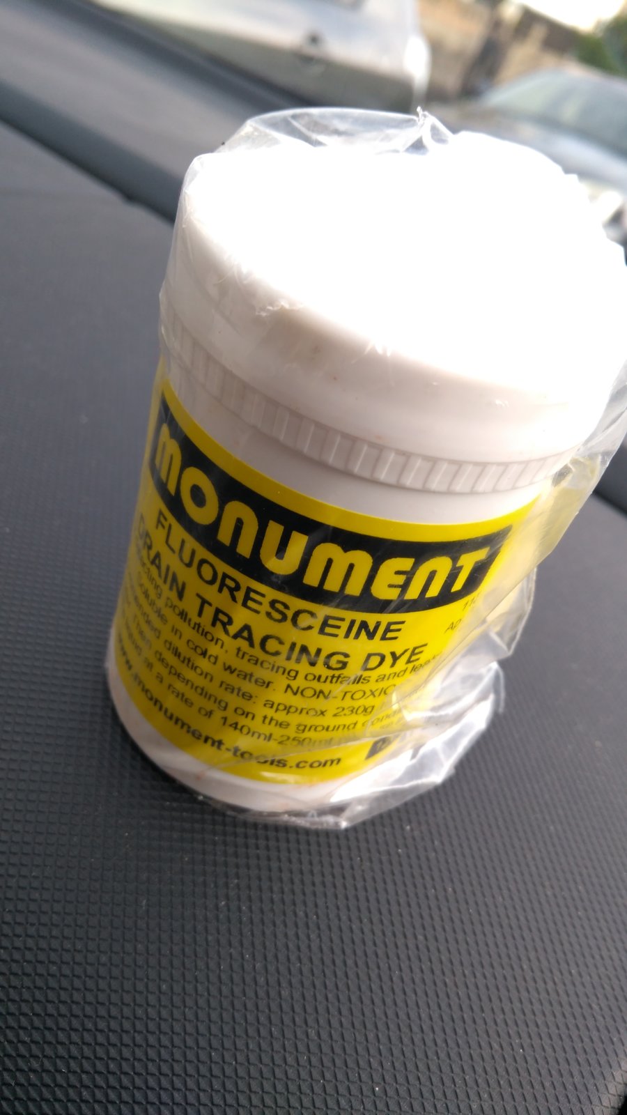

Aparently you can get drain dye from Screwfix . It's OK to dig a bit under the stones- so long as you don't go all the way along, right under them;)
Don't expect water to pour in as soon as you flush the WC, if the drains are leaking, then it's likely the surrounding soil will be very waterlogged. Any leaking water will just be adding to the general saturation, rather than just pour straight into your cellar.

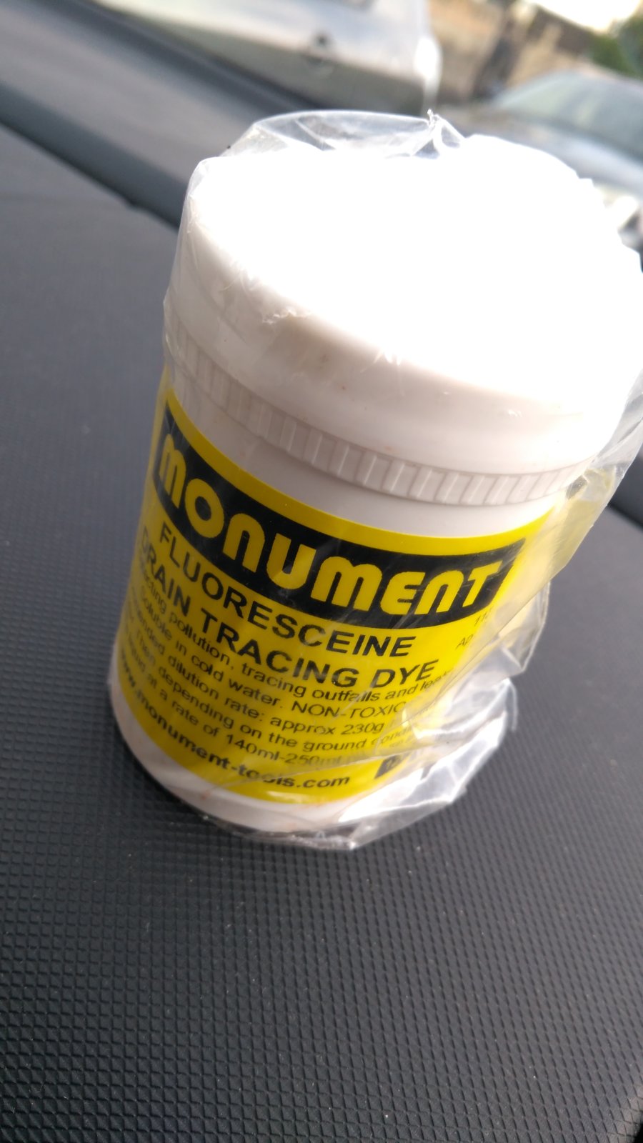

Dye should help indicate if this is the issue, it should show itself soon enough after use if this water is escaping from the drains. I'm with Nige, DIY sheds are less likely to stock it, available from Screwfix, https://www.screwfix.com/p/monument-tools-flourescein-drain-dye/31595#_=p You don't need to use too much each time!
Teaspoonful at a time, start with the WC. Gently put required amount into the water in the bottom of the WC pan, flush, then wait. See if it appears in your cellar. If no sign by the morning, repeat the test on another drain or WC.
